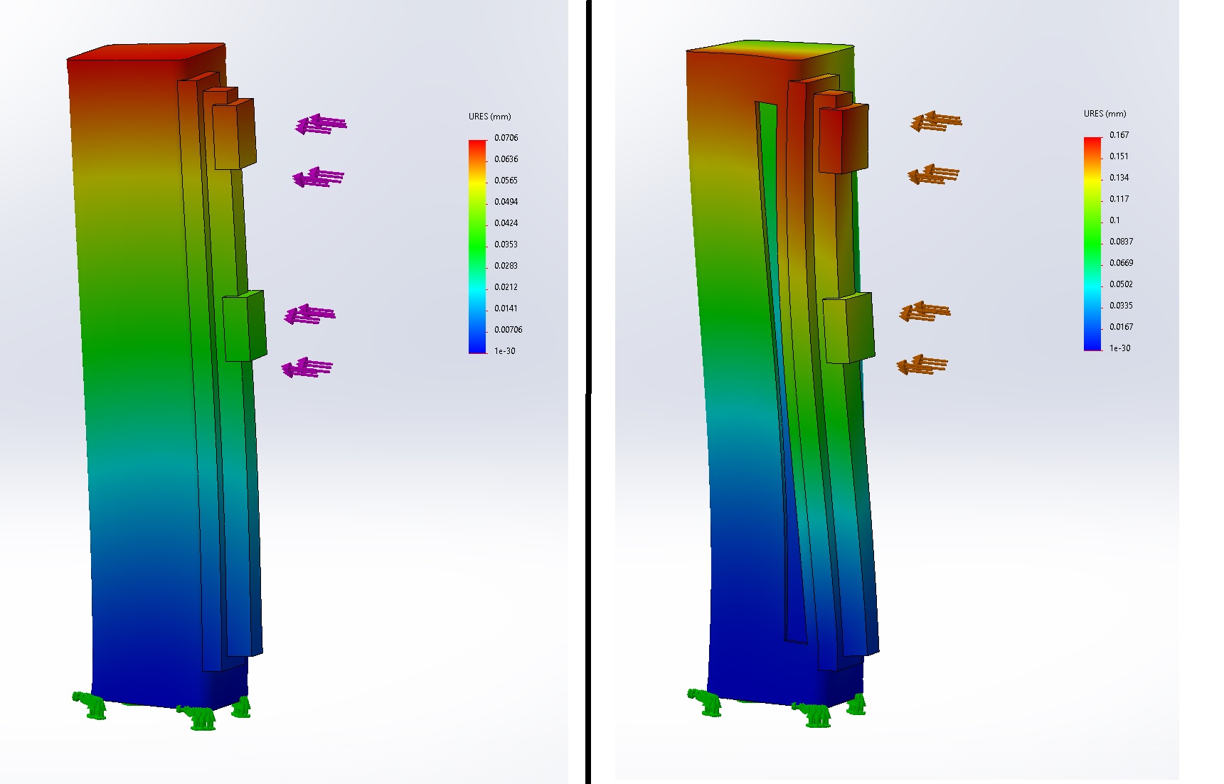

    I can't see how the stiffness loss with a slot is worth it.
    The below shows two identical columns, except one has a slot cut in it. There is 2.36x as much deflection with the slot.
    Attachment 29240
    Bellows don't compromise rigidity.

    Racking is a consideration. Depends on width between rails and bearing spacing along the rails.
    Racking can't NOT happen IMO when it's plunging into hard materials for operations like drilling, it's just by how much.?
    The extra expense of making it more massive, etc to counteract this far outweighs buying another ball-screw as it doesn't stop at just the width, spacing, etc. As it gets heavier, wider, etc, it requires larger and more costly everything.
    Doubling up means you share the loads so can use a smaller size and less expensive components which cancels out any cost offsets but gives a much better-balanced machine.!. . . Which looks like it was designed by someone who knows what there doing and not a tight-arse who's trying to save a few ££.

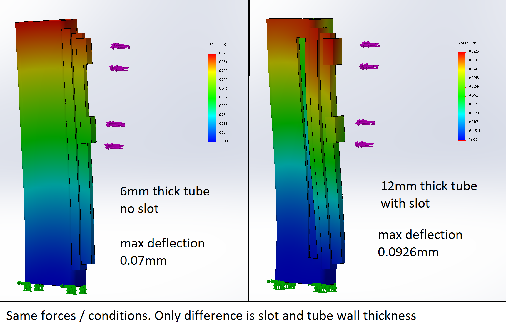

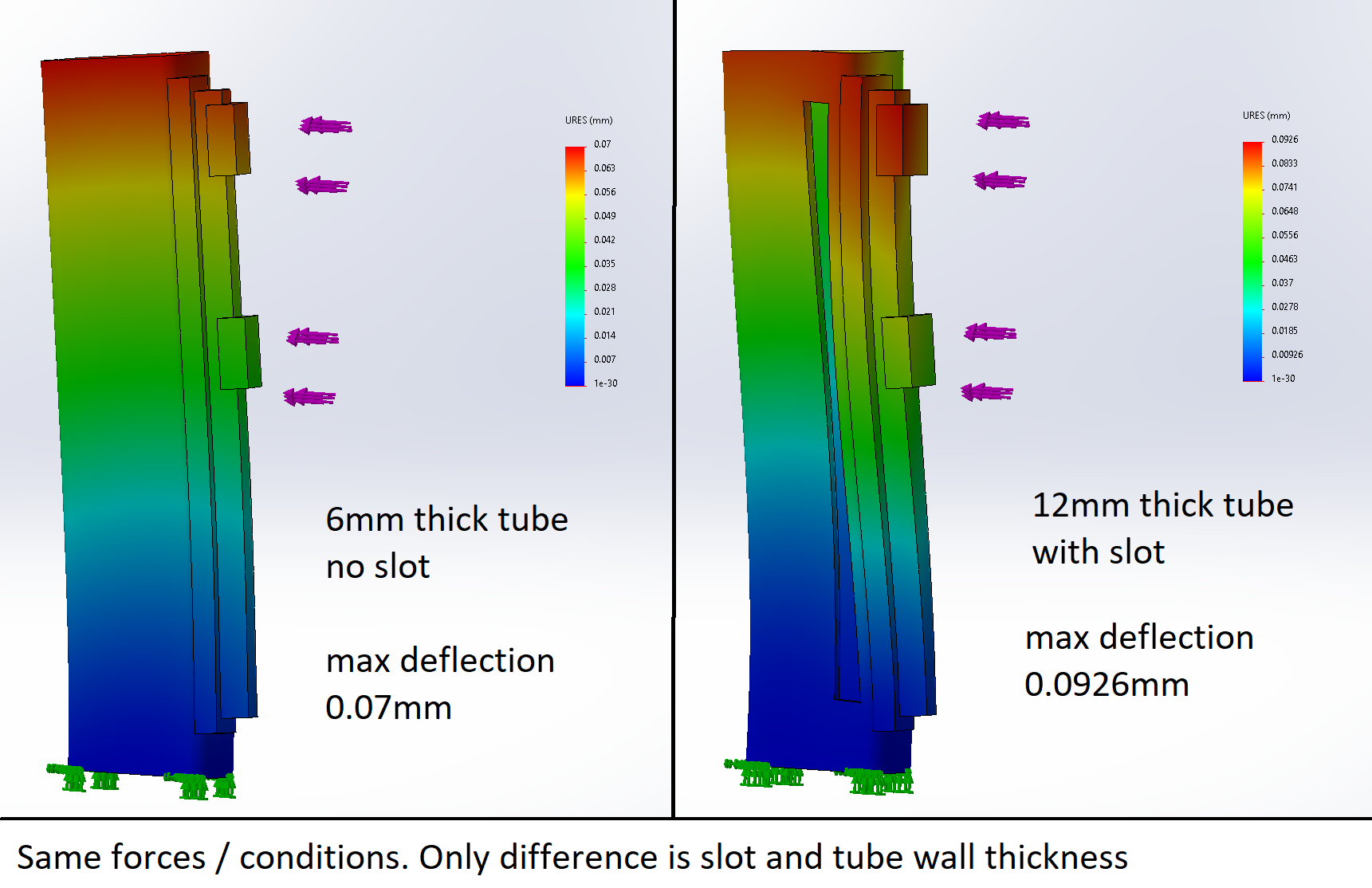

    The absolute value of the deflection (and the absolute load) is not the point. The point is the comparison between slot and no slot under the exact same conditions.
    You can double the thickness of the tube and you will still be behind. Better just to get rid of the slot.
    (If you put the slot in the opposite side of the tube, away from the rails / load, deflection is roughly in the middle between 'no slot' and 'slot')
    If you want to cover the screw, put it within another tube attached to the side, but don't compromise the stiffness of your main structure.

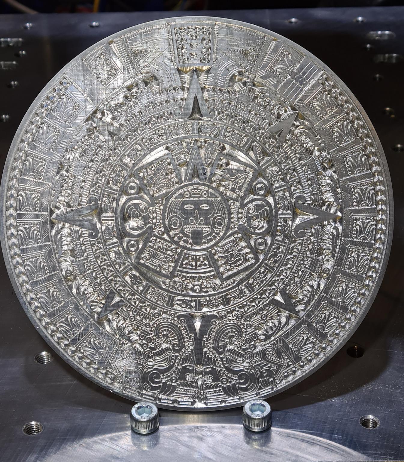

    My test of every router/mill I build is to cut the Aztec calendar in 10mm Aluminum because of the very fine detail in it. Then straight after I cut it again over the top to make sure there are no errors. I do this because if there were any errors or significant deflection then the second pass would destroy the fine details cut in the first. (See the poor pic)

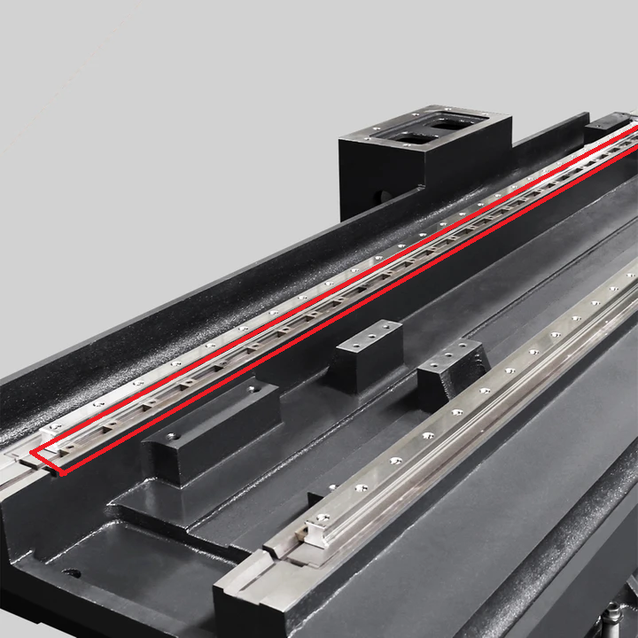

    Are these regular fixture clamps you'd use to hold the workpiece or some special types?
