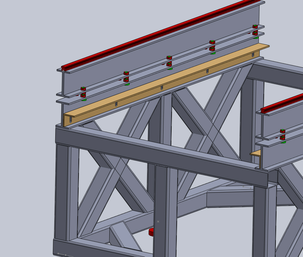

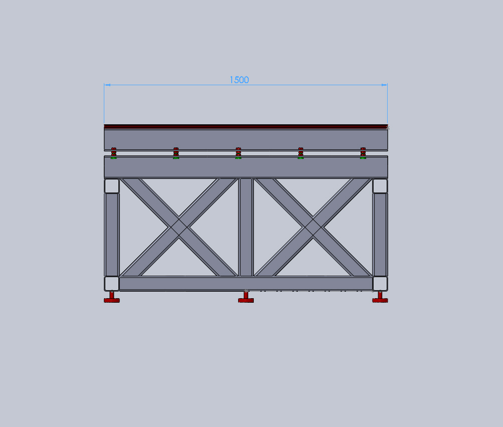

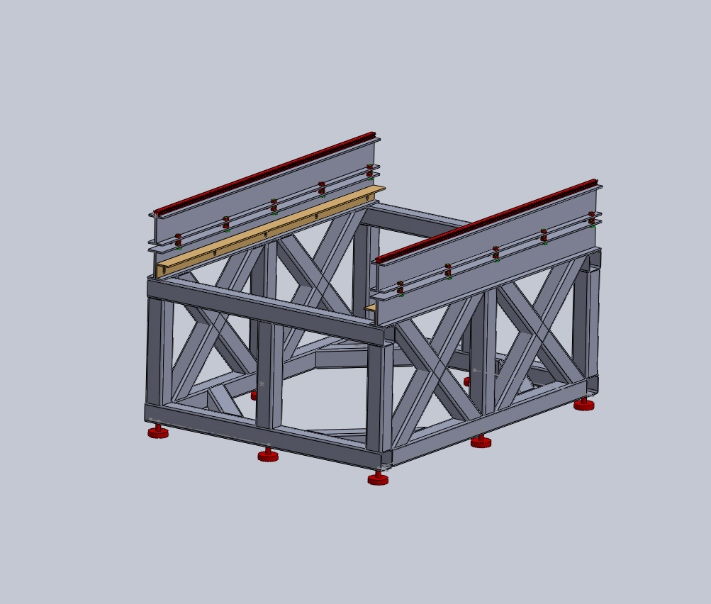

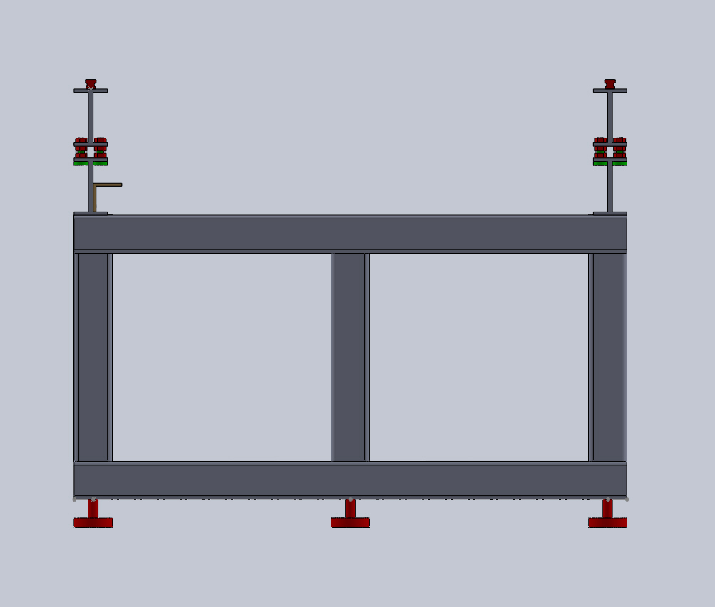

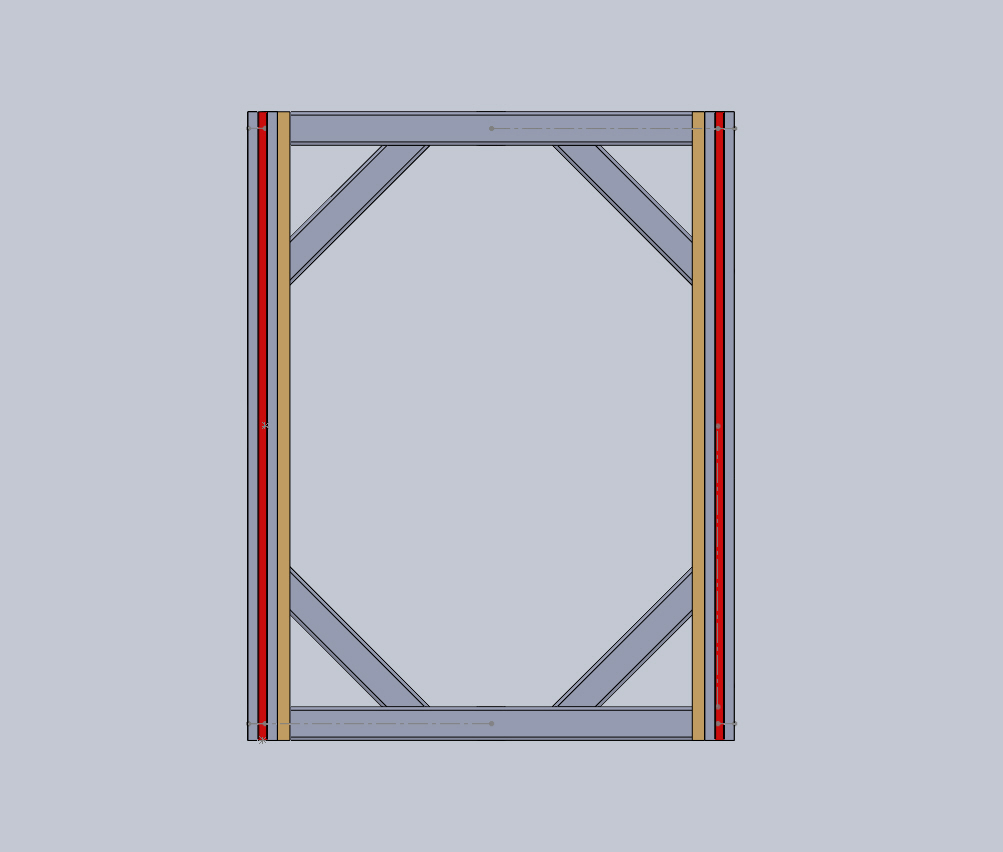

    I would like your advice and your opinion on the plans below.
    Involving a cnc (1500mm x 1000mm) which
    will runs with Yaskawa servo 400 watt
    Supported profiled rails 20mm, ballscrews X, Y 20mm Z 16mm
    Spindle 2,2 KW water cooled
    The following plans have to do with the table
    I want to make something stiff and adjustable
    The main table is made with 80X80 5mm square tube and the X axis rails will be placed on two ( each side ) I beams. The one I beam (120mm height) will be welded on the table and the above will be adjustable up-down left-right with screws. Before i go on with the plans i think that it will be good to get some opinions from the "experts" as i am amateur at cnc constructions ( sory for my english).
    My main concern is if I beam is suitable for this purpose, or it is better to go with 120X60 5mm tube
    The cutting surface will also be adjustable from the brown L shape angle that can be moved up and down.
    Thanks everybody for your time
