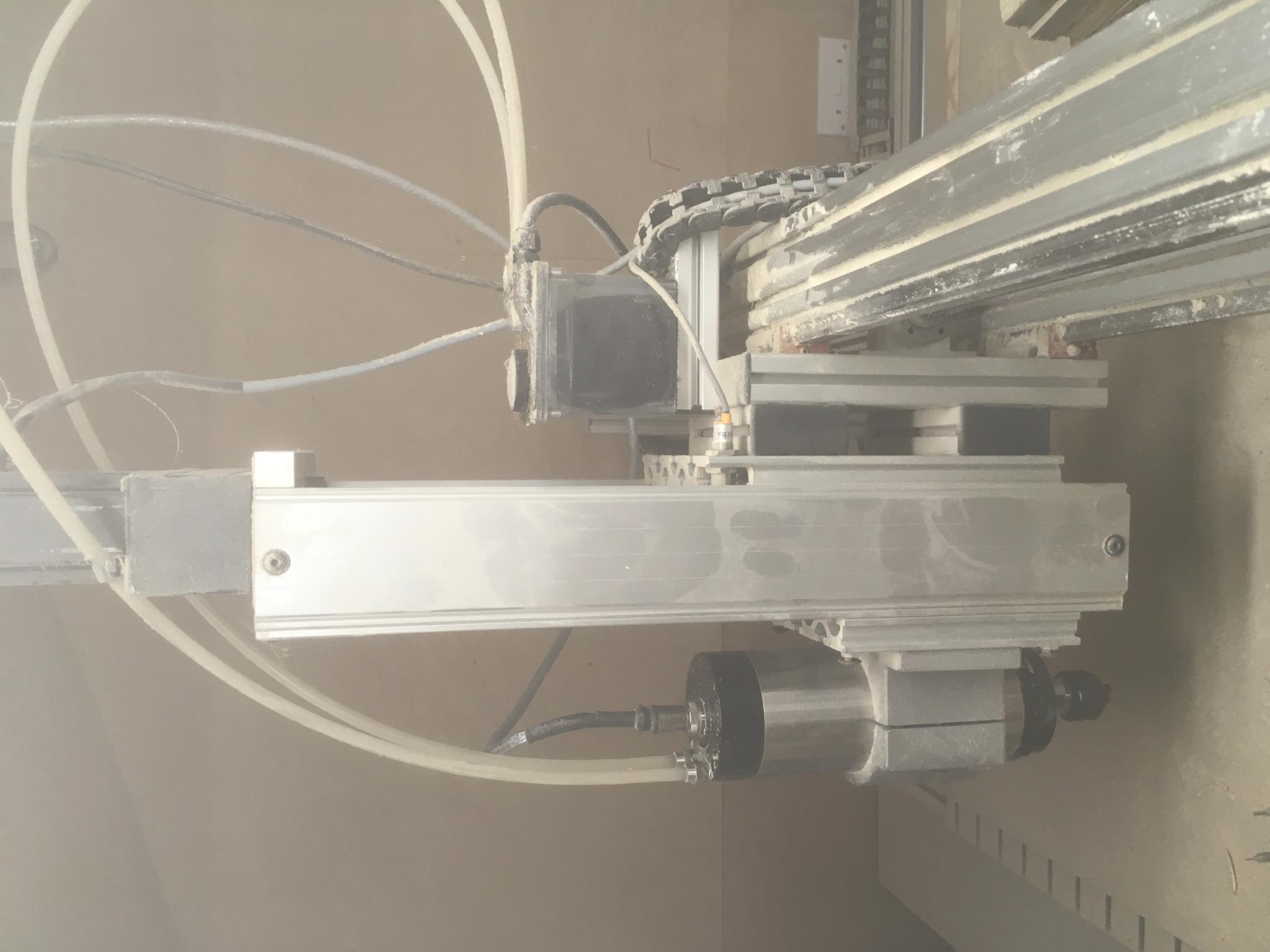

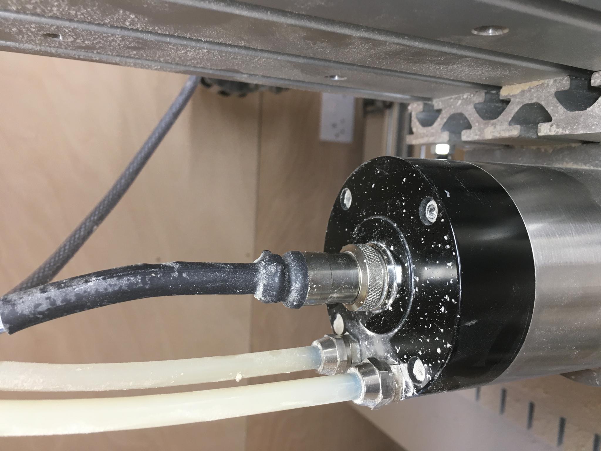

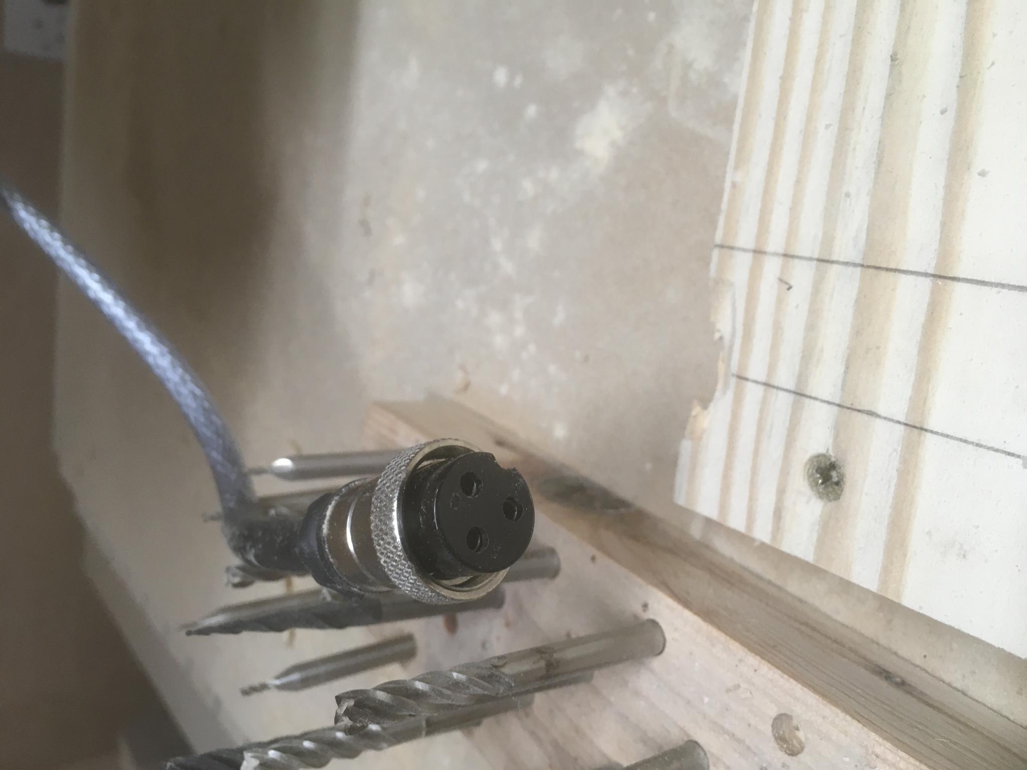

    Going to check the continuity on the cables now.
    I’ve attached a couple of pictures of the spindle and the wires
    Thanks again for your help
    Thanks for those images, confirms m y assumption over the choice of spindle. Also indicates you have a small setup issue with Mach3 which is unimportant at this time. Your first post shows the VFD illuminating the FORward LED - I'm assuming you can drive this with an M3 command and extinguish it with an M5... thats really the last bit that would convince me that you have Mach3 control onto the VFD and that the problem lies in the VFD/wiring/spindle.
    Actually, you can check the continuity of the loom and spindle through those three sockets on the connector in the photo - just check for a couple of ohms between each pair (1-2, 2-3, 1-3).
    I’ve just checked the wires running from the spindle to the VFD and the three sockets on the connector and I’m getting a consistent reading on all of them.
    Does this mean it could be a MACH3 issue?
    Ben
  4. #14
    I don't think this is a Mach3 issue. You've said already that you can command a forward rotation from Mach3 onto the VFD (first post - "FOR" LED illuminated, "F400.0" commanding full speed rotation. No spindle movement.
    What were the measurements on the connector?

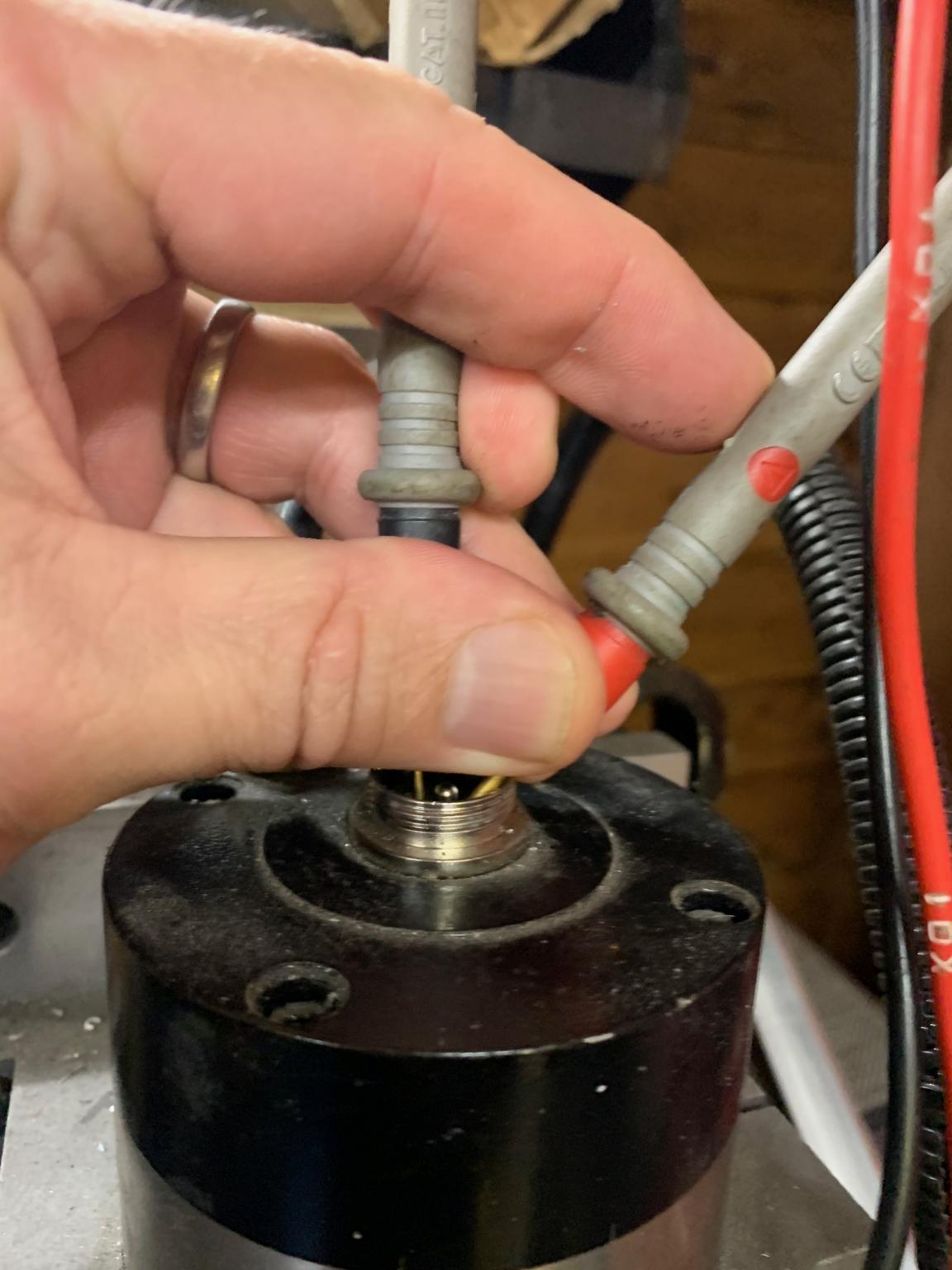

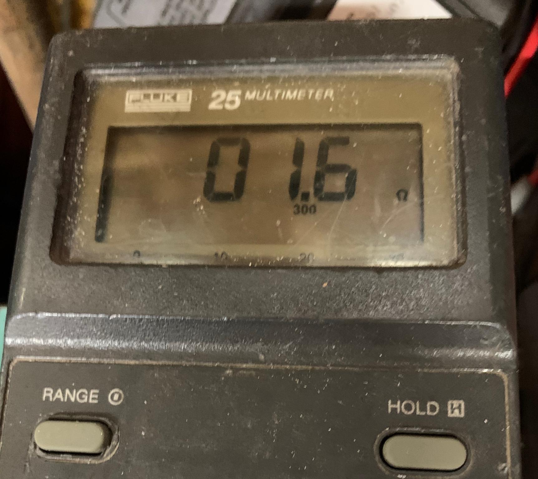

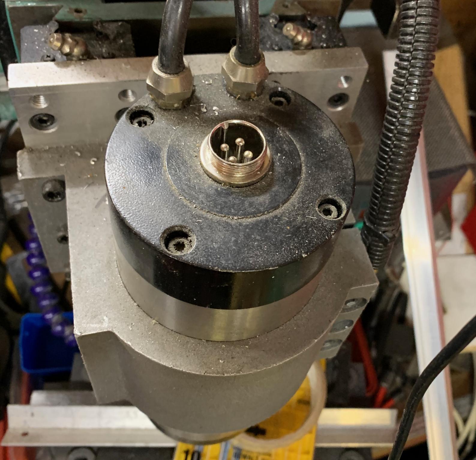

    I'm assuming that those are the readings from the 3-pin connector, with the other end connected to the spindle. And that those are in the milli-Ohm range?
    I'm asking because I've just been to measure my 2.2kW spindle...
    All combinations between three pins were measured at 1.6 Ohm. (or, broadly speaking, 1600 milli Ohm) as...

    A number of 1825, 1780 or 1755 would make sense, if on a milli-Ohm range (very unusual / expensive meter) - or possible presented as "1.825" Ohm?,
    A value of 1825 Ohm would concern me somewhat.
