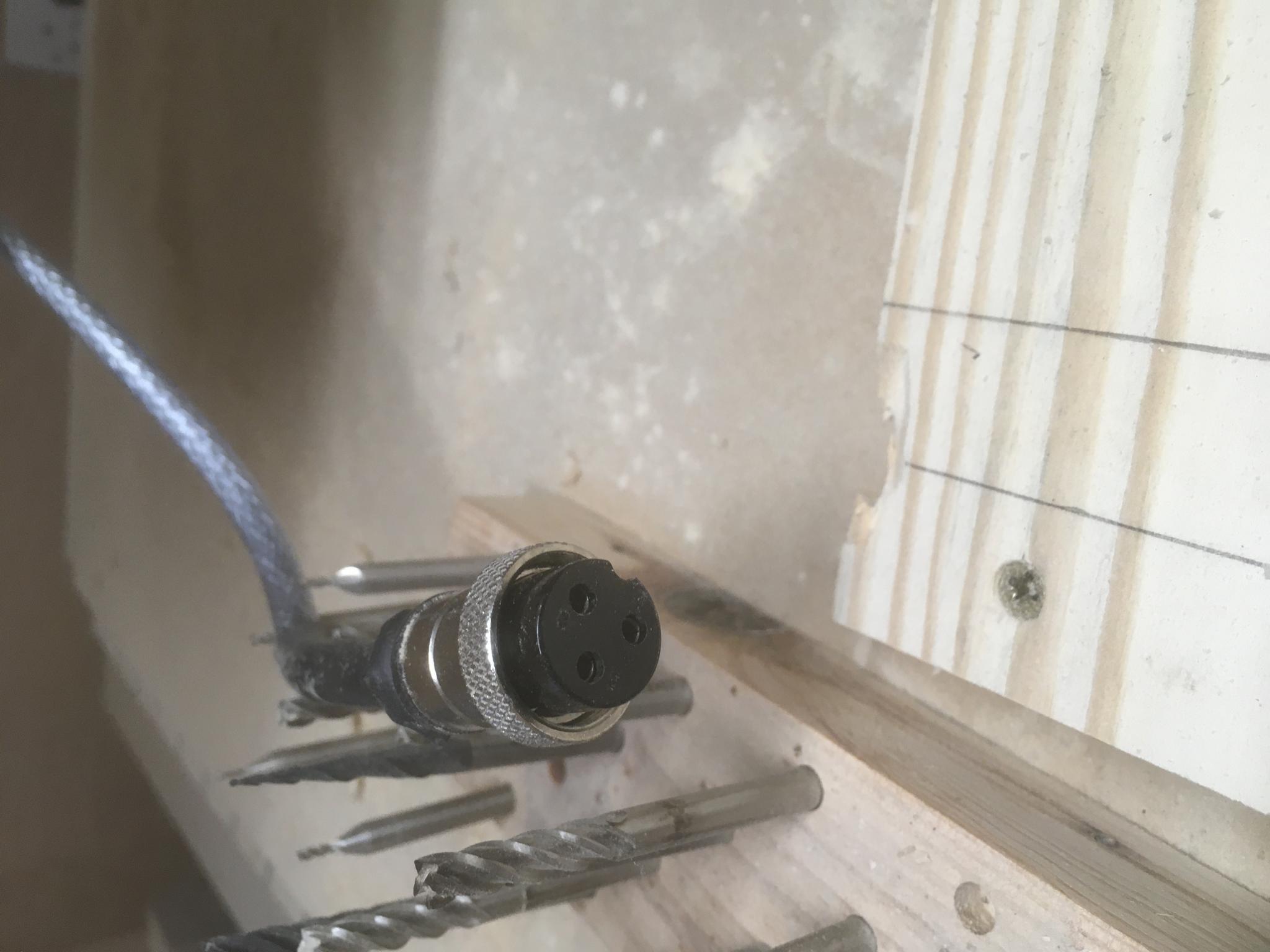

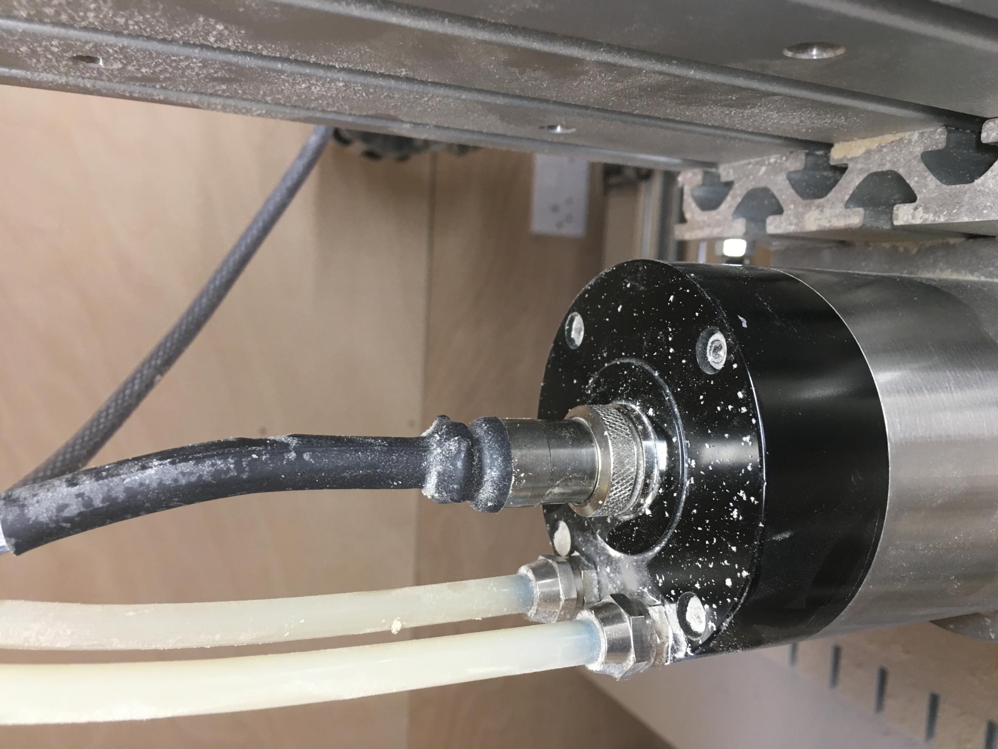

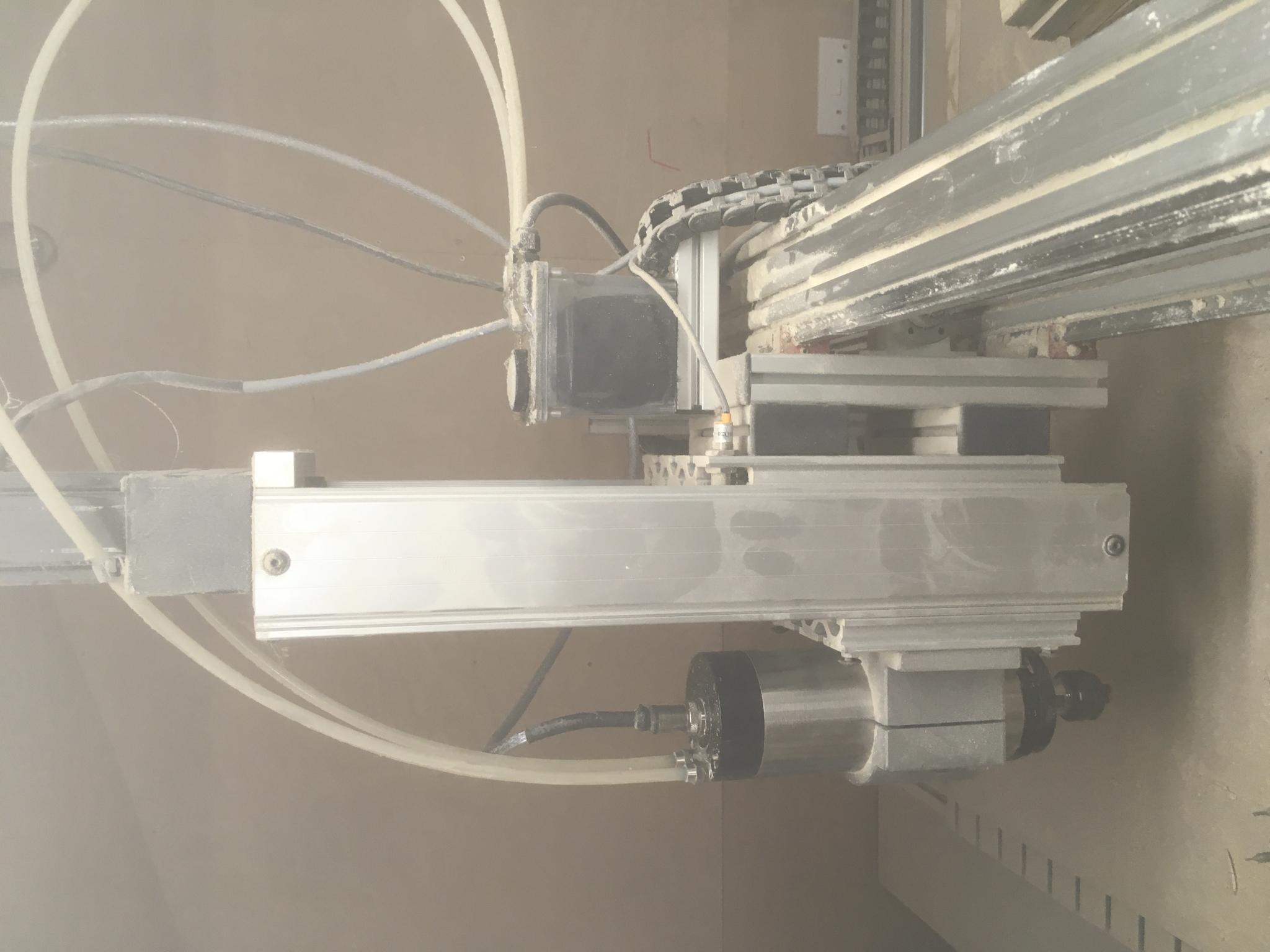

    Going to check the continuity on the cables now.
    I’ve attached a couple of pictures of the spindle and the wires
    Thanks again for your help

    Thanks for those images, confirms m y assumption over the choice of spindle. Also indicates you have a small setup issue with Mach3 which is unimportant at this time. Your first post shows the VFD illuminating the FORward LED - I'm assuming you can drive this with an M3 command and extinguish it with an M5... thats really the last bit that would convince me that you have Mach3 control onto the VFD and that the problem lies in the VFD/wiring/spindle.
    Actually, you can check the continuity of the loom and spindle through those three sockets on the connector in the photo - just check for a couple of ohms between each pair (1-2, 2-3, 1-3).
    I’ve just checked the wires running from the spindle to the VFD and the three sockets on the connector and I’m getting a consistent reading on all of them.
    Does this mean it could be a MACH3 issue?
    Ben

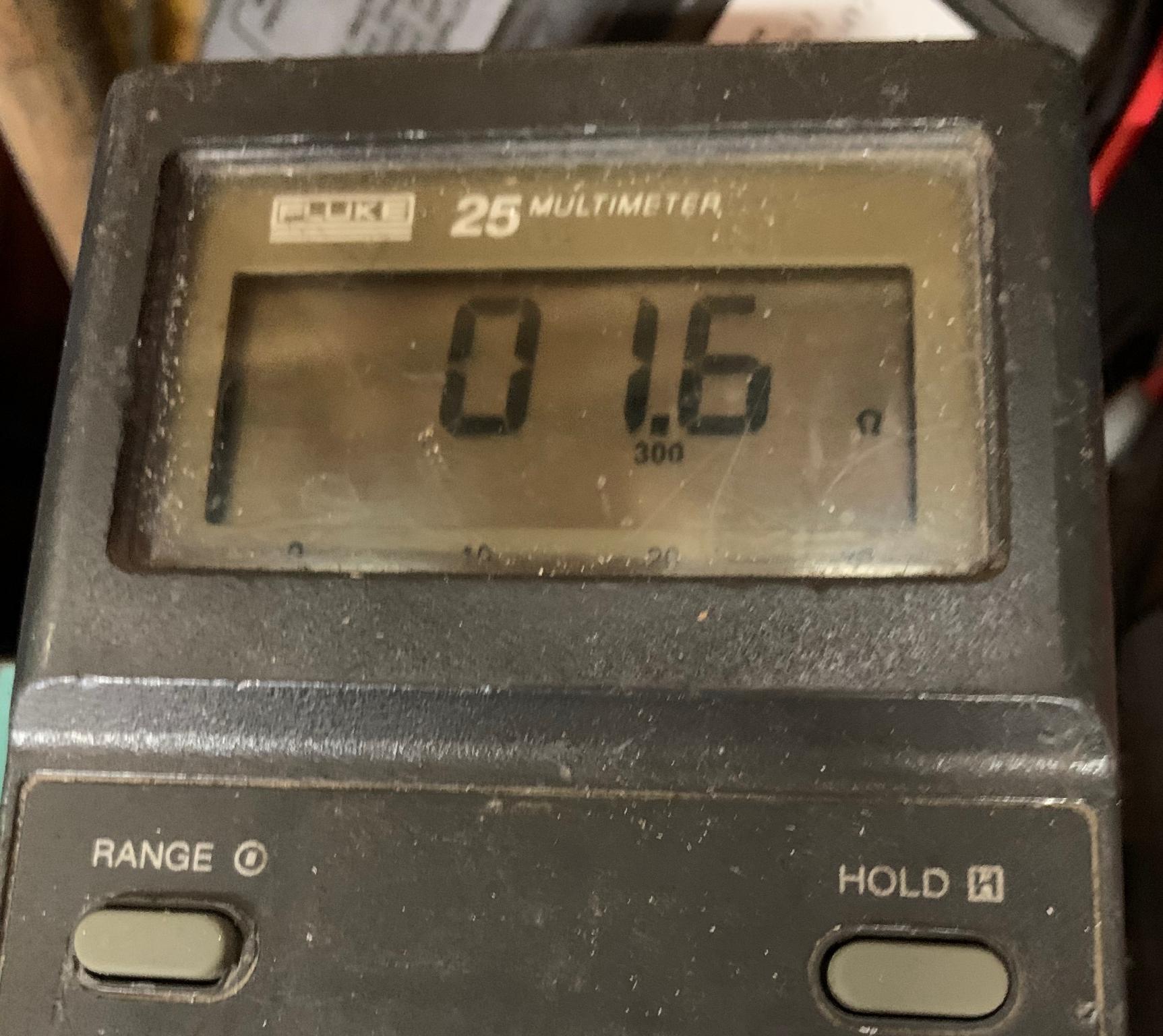

    I'm assuming that those are the readings from the 3-pin connector, with the other end connected to the spindle. And that those are in the milli-Ohm range?
    I'm asking because I've just been to measure my 2.2kW spindle...
    All combinations between three pins were measured at 1.6 Ohm. (or, broadly speaking, 1600 milli Ohm) as...

    A number of 1825, 1780 or 1755 would make sense, if on a milli-Ohm range (very unusual / expensive meter) - or possible presented as "1.825" Ohm?,
    A value of 1825 Ohm would concern me somewhat.

    I’ve double checked the readings and they are showing the same. The metre is showing its reading at milli-Ohm
  8. #18
    Doddy's Avatar
    Lives in Preston, United Kingdom. Last Activity: 2 Weeks Ago Has been a member for 9-10 years. Has a total post count of 1,364. Received thanks 188 times, giving thanks to others 66 times. Referred 1 members to the community.
    Ah, good... I did want to confirm that - it's unusual (or maybe I'm behind the times) to get general purpose DMMs with milli-Ohm ranges. Never mind, onwards and upwards.
    I'm assuming that you're confident then that the three phases of the motor are all in the same region of around 1.6-1.8 Ohm then that's largely convinced me that the spindle is okay - and that's no surprise, there's not usually problems with the spindle I would always check the harness (cables fracture over time if moved) - but I think you've discounted that. The weak link in the chain would always be the power electronics on the VFD.
