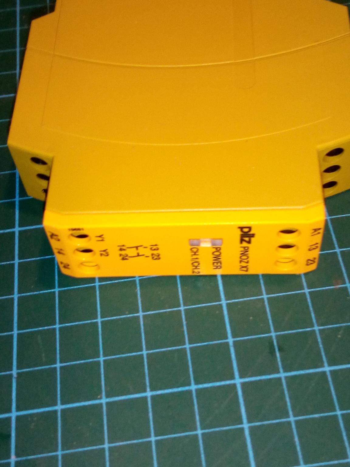

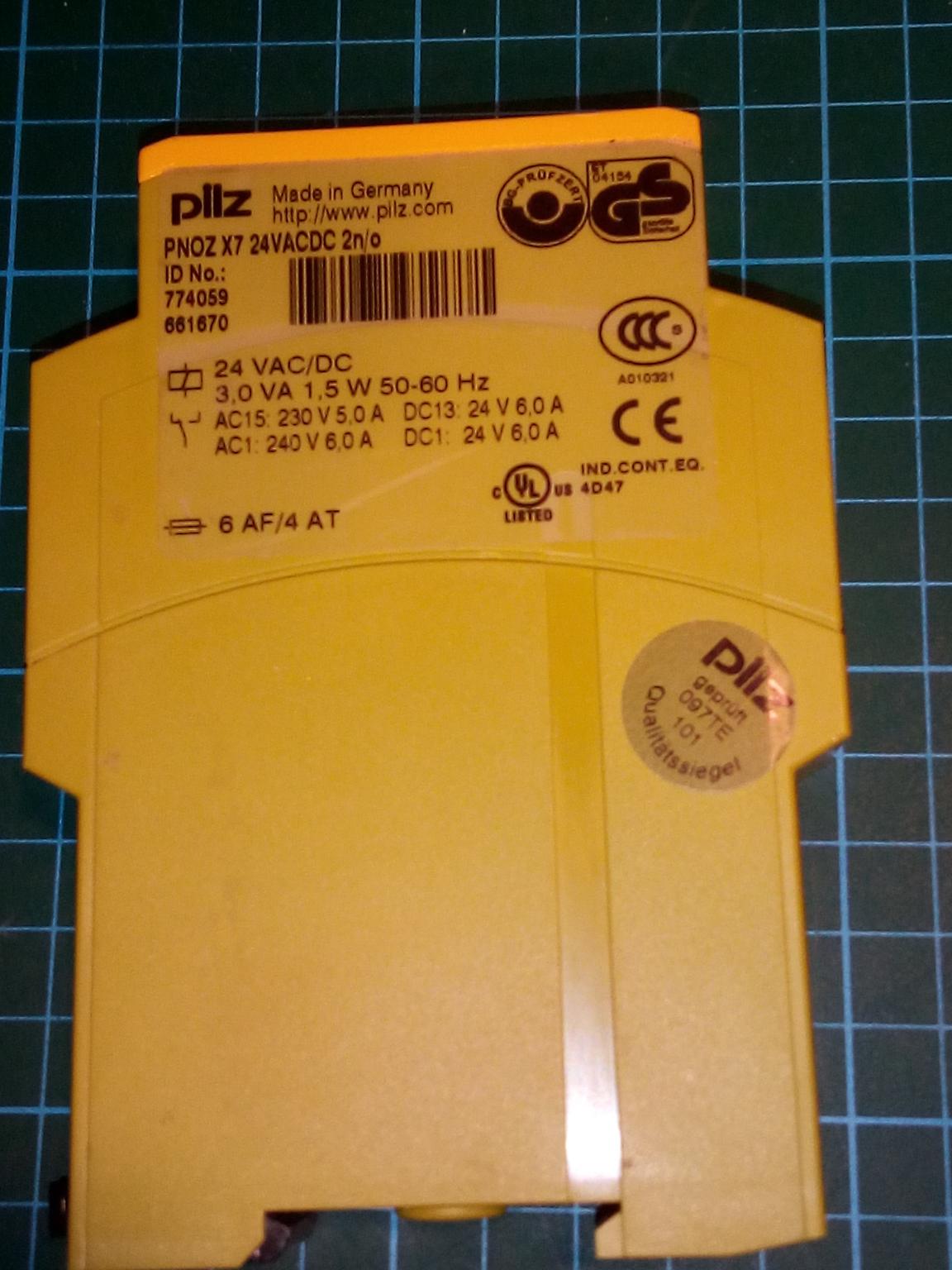

    Like this one ?Click image for larger version.

    Similar but different! No, mine is the older version, big and clunky in appearance.
