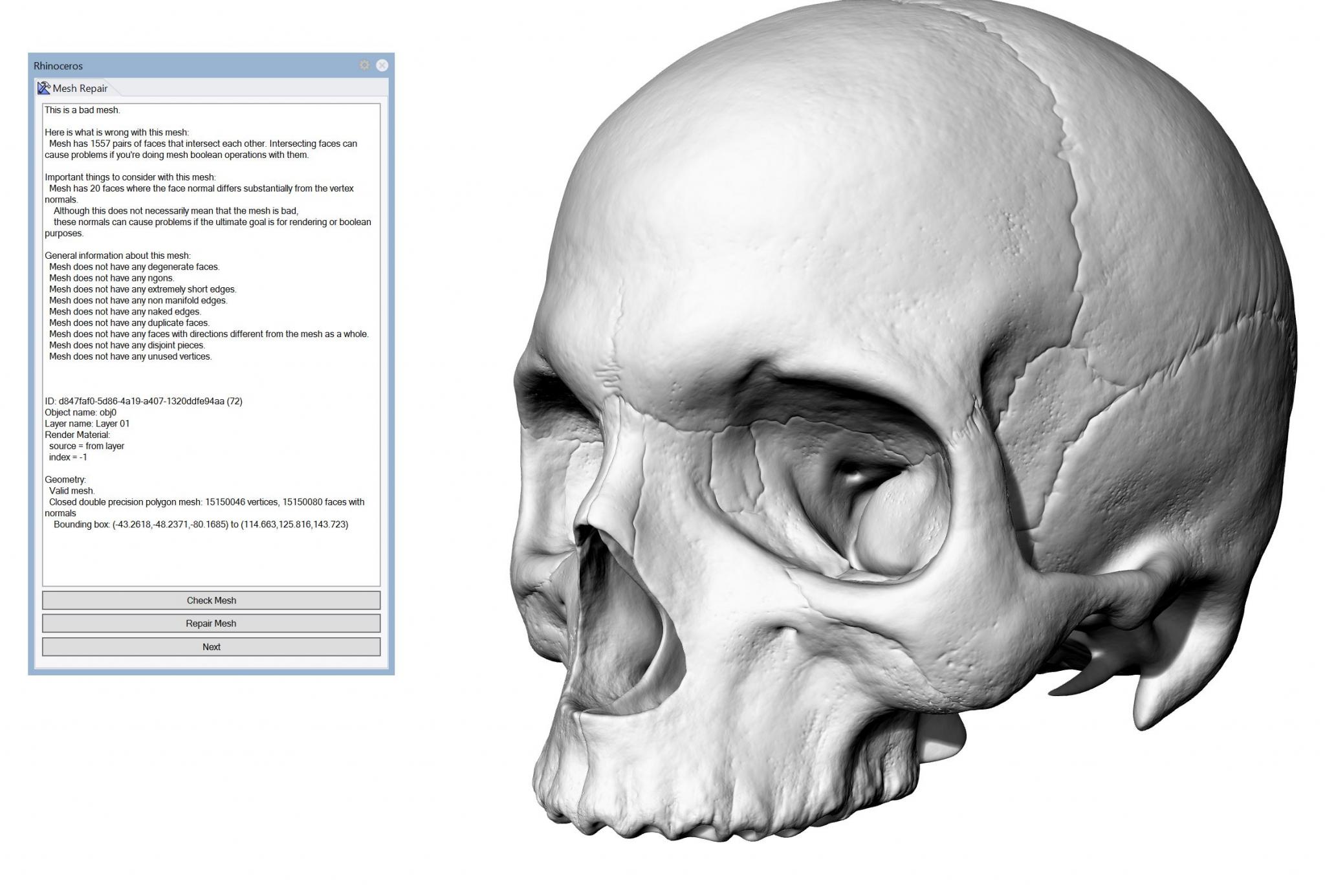

    Hi, I have a part of a. Obj model that I've purchased. I can't open the main part of it (it's a skull, the lower jaw runs fine, but the upper part doesn't).
    I've tried on a friend's machine with dedicated graphics and not having any luck either, so I can't figure out if it's the file or, most likely the pcs lack of ability!
    If anyones happy to help please let me know and I'll dm a link(300mb dl).
    Thanks so much, Mark.

    I can open the file in space claim but it is massive
    I’ve tried all the setting that I understand but it will only reduce to 1.47 gb (from 4.7gb)
    I saved it as a obj and an stl file both about the same size at 1.47gb
    I then tried to open the stl file in mesh maker but got an out of memory error
    This was on my main pc with 16gb ram and an 8gb graphics card
    Not sure what else to try
    Paul

    Ok, I have opened the file with no problems but the model has a very high and dense mesh count with errors. See image.
    My workstation is fairly high spec with a Quadro P5000 and 128gb RAM, so you will need a decent GPU and plenty of RAM.
    I have opened it with Blender and Rhino3d no problems, Blender is a free download if you want to try it.
    That's one amazing set up you've got! Way way beyond my budget. Thanks for checking it out, is it cheeky to ask if you could reduce the polys to make it accessible to a circa 2010 pc!? I only want to route it, the huge amount of detail isn't ever going to be visible for my application. Thanks again, Mark
