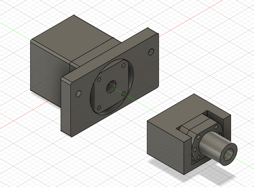

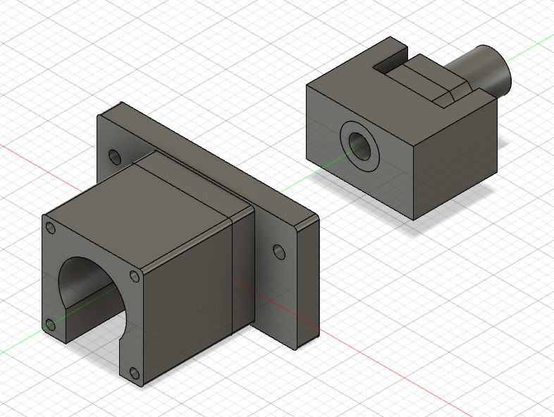

    I'm currently modelling a homebrew double nut 1204 solution:

    In theory the length will end up being 74-77mm so would need extra space on the Y.

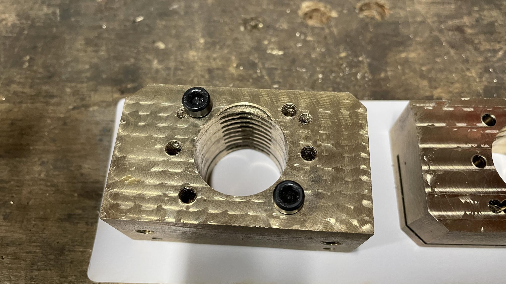

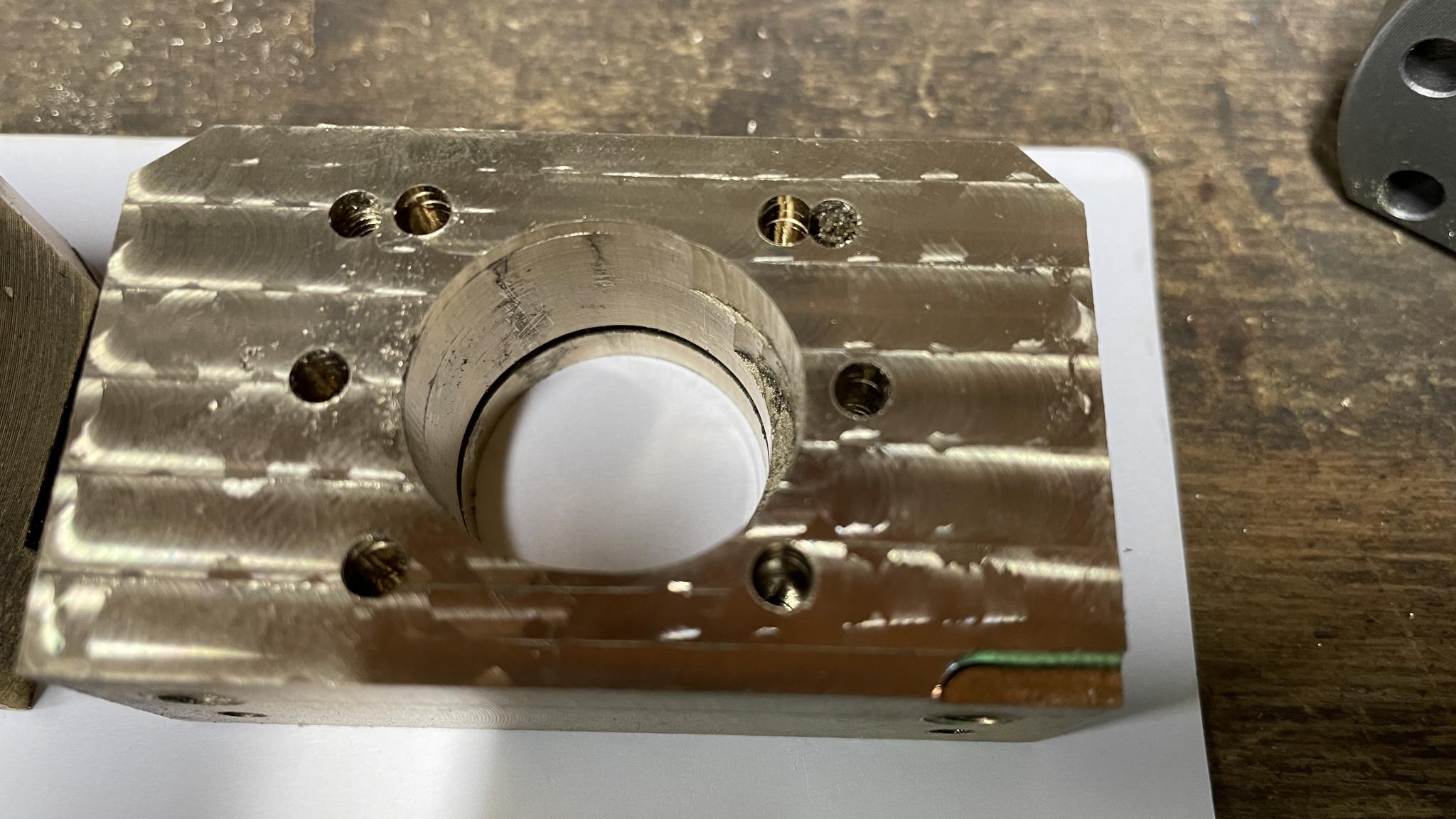

    I've been milling out the X and Y ballnut holders from the old brass acme leadscrew nuts. The Y nut was clocked from the front of the table as being 0.002" out of square so compensated for this in the vice on the mill then faced and bored the ballnut hole and bolt holes. I ran into some problems in the process on the second mount as evidenced in the photos below. I had a cutter slip in the collet which accounts for some of the problem, the other marks in the bore are a result of the previous threading showing through but the final mounting hole is true and the otherwise ready to start the fitting of the ball screws.

    I will get a good bit of extra table travel in the Y axis towards the column as dazp1976 says above on his similar machine.

    I've spent a vast amount of time getting to grips with Fusion 360 and been modelling up as much of the X3 as possible with as much accuracy as I reckon I need. Link to fusion design here https://a360.co/3EeD874.

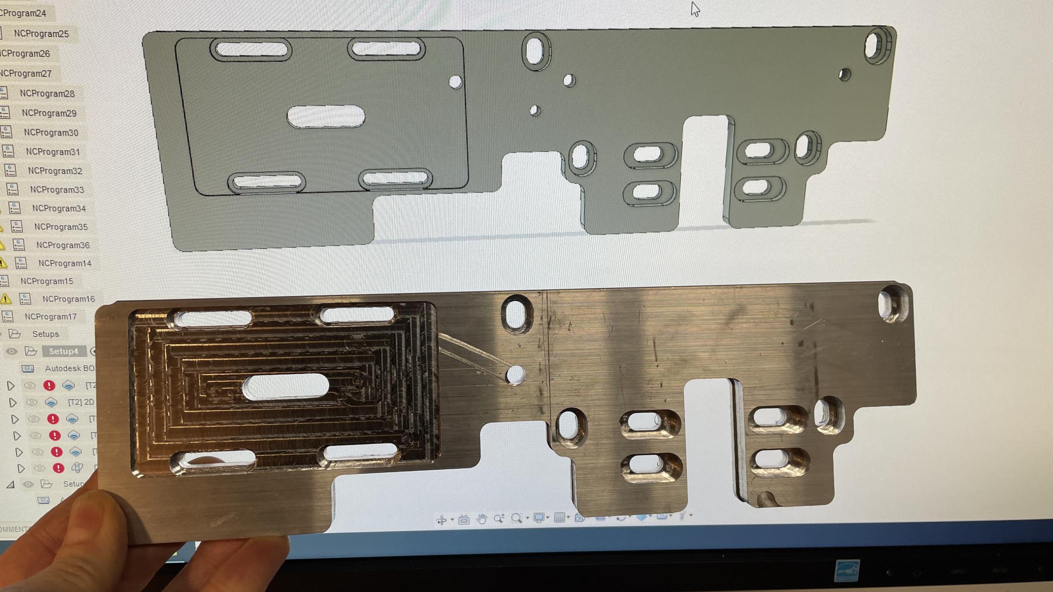

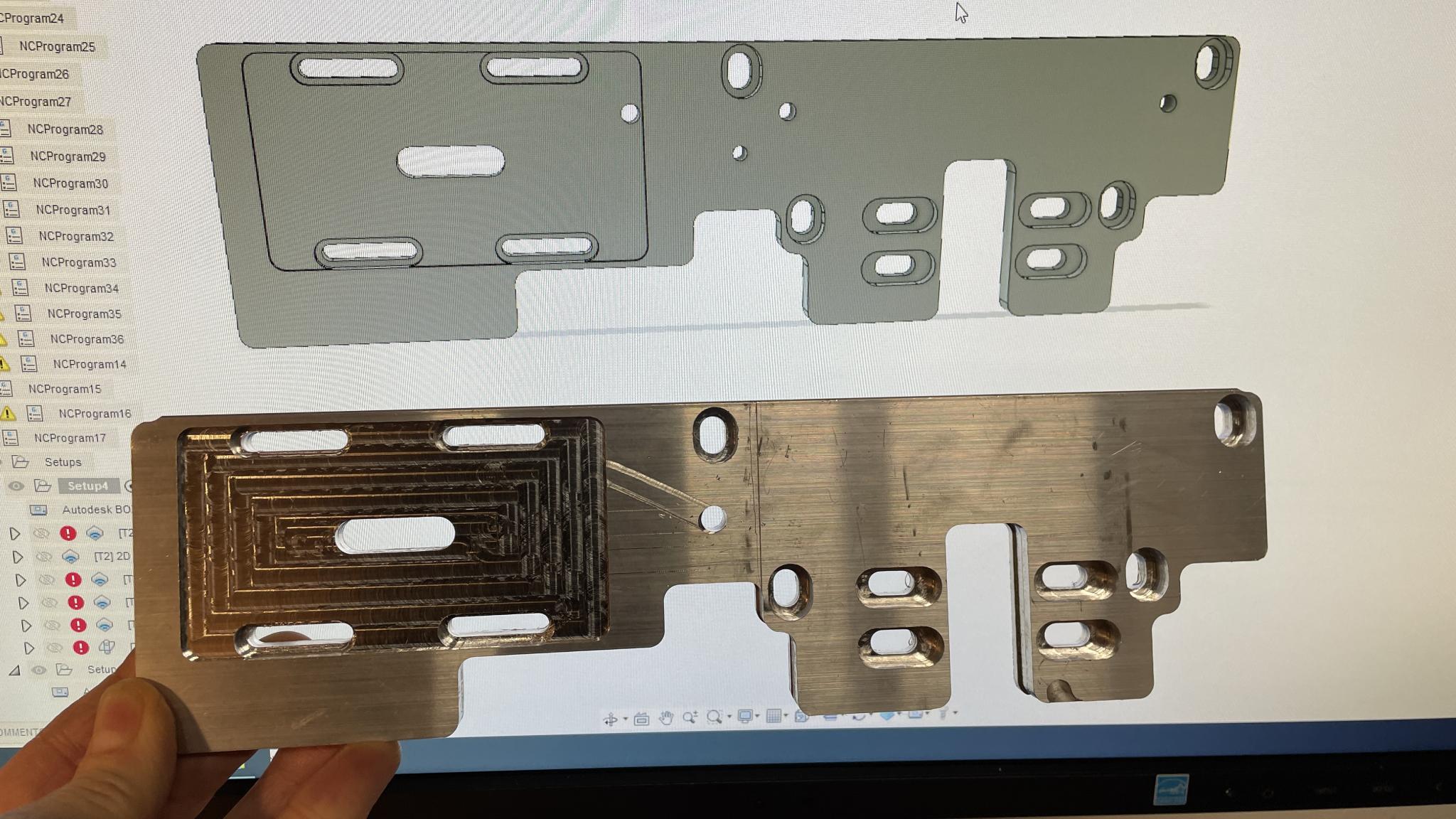

    I also spent a large amount of time in the shed making my Y axis stepper mount plate, much swarf, many broken cutters from trying to get used to machining with a flexible machine and a low powered router head. (BOXZY robot)
    So here it is, my Y axis plate with stepper mounted at the rear so that it doesn't stick out the front too far and take up too much room in what is already a small space.
    Any suggestions for good pulleys and belt to stop backlash before it gets introduced much appreciated - I've seen mentions of HTD5 and am thinking 15mm with 18 tooth pulleys.
