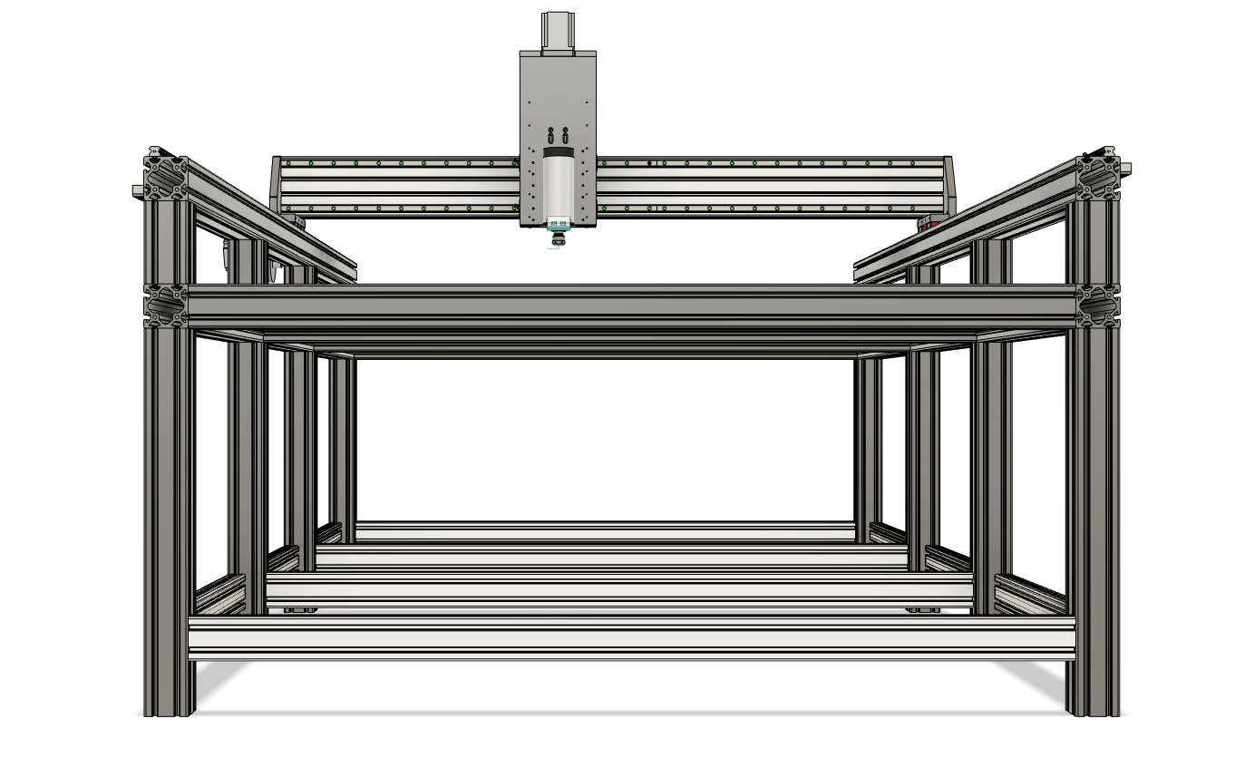

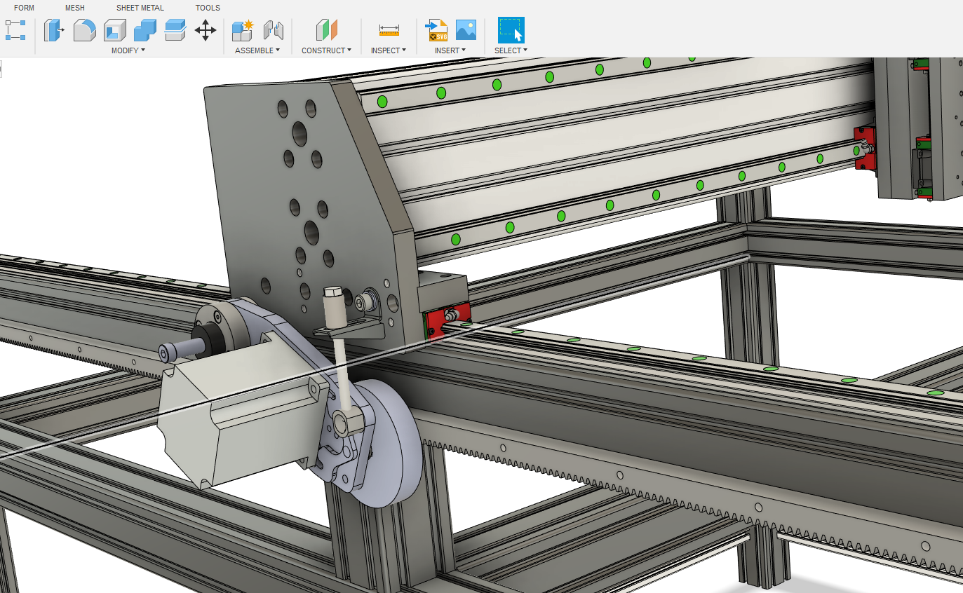

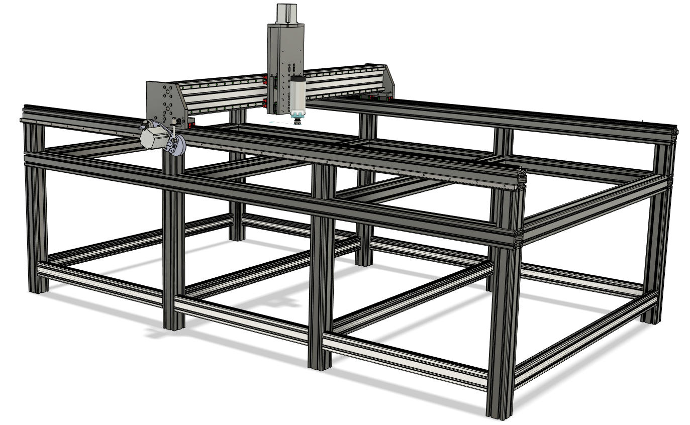

    Just for reference, this is my (not finished) model of machine im trying to build. Gearbox here is from AvidCNC, just for example.
    It will be made of 80x80 80x160 aluminum extrusions from Item24.

    Quote Originally Posted by Ale View Post
    I have also seen vertical cnc machine you have put together, really nice work. I was surprised that that long screws worked that well, until then I thought that screws on machine that big are ridiculous, but you managed it with high pitch screws to avoid whip.
    Those screws where 2525 with 2:1 ratio using 8Nm 3phase closed loop motors and mains drives. They also had fixed ends at both ends of the screws and where preloaded slightly to tension the screws.
