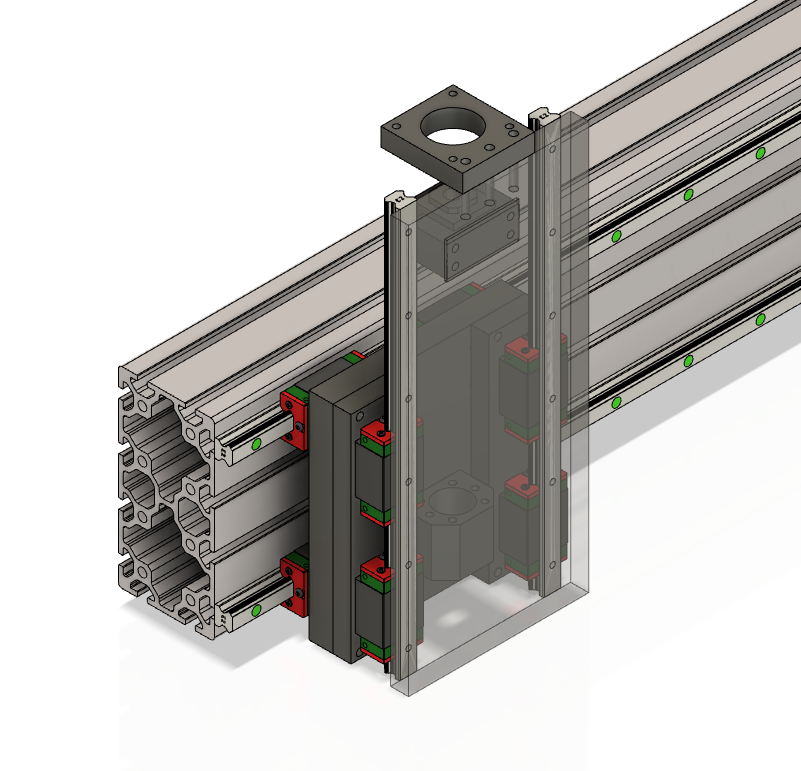

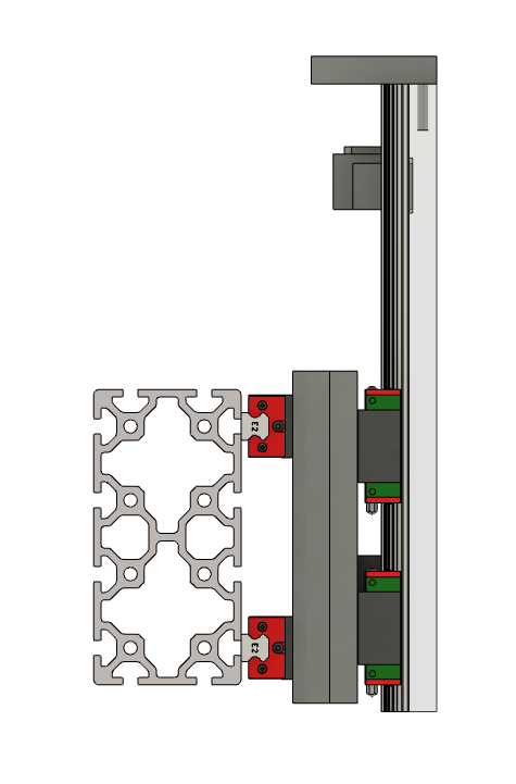

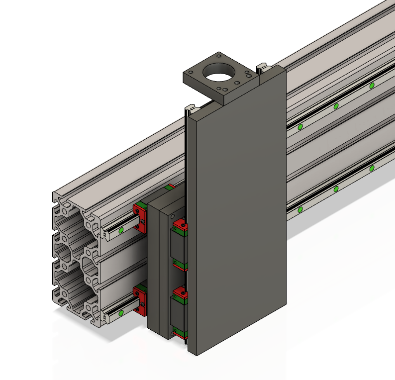

    After reviewing the projects on this forum, at the moment I will probably choose a version similar to the project made by 'devmonkey' ("Joe's 1000x600x200 steel and aluminium router started"): extrusion gantry and welded steel frame
    I started to draw from the Z and Y axes, and I have such a concept:
    I am still thinking about mounting Y linear rails: as I drew in the picture or maybe I should move them to top and bottom?

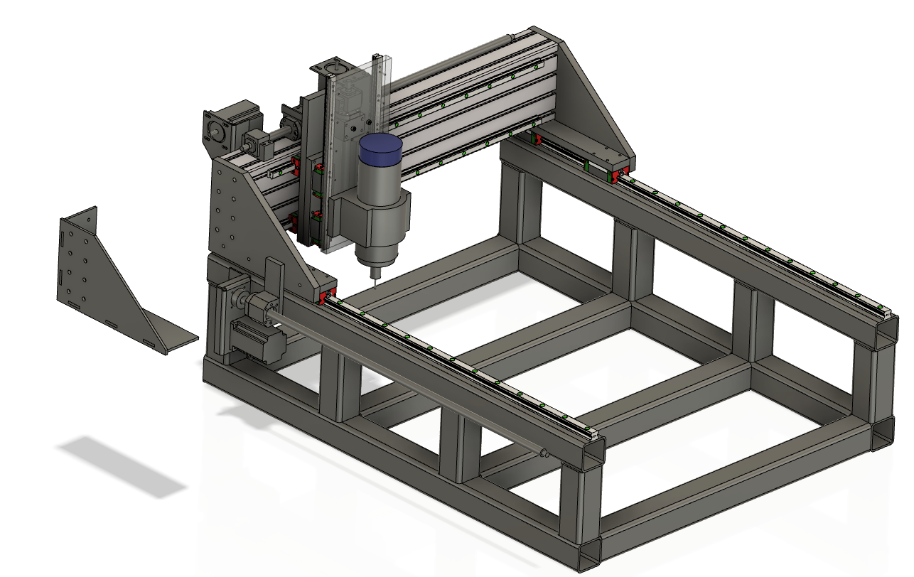

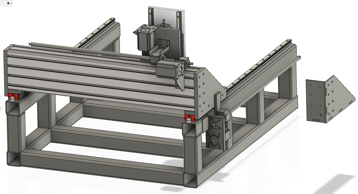

    I already have my project, but I am thinking about one more thing: connection of the gantry profile with cariage
    At the moment they are 15mm aluminum plates, but I am wondering about steel sheets with keyway and welded connection
    Maybe someone used this solution? or rather only aluminum plate?
    @szecho, I've seen plenty of machines on this forum using a similar design to what you have decided on, and the recommendation seems to be to use 20mm Aluminium Plate if possible.
    It looks like you have the opportunity to bolt through from the horizontal carriage plate to the bottom of the gantry extrusion - this will greatly rigidise the axial movement of the gantry and reduce the requirement for the side plates over a design where the gantry extrusion is well up in the air and the side plates are taking all the strain. Regarding position of the rails on the gantry, top and bottom spaces them further apart than on the front giving the opportunity for greater rigidity and keeps the Z axis assembly close to the gantry, but it will lose you clearance in the Z axis. Top and front (bottom) is an in-between solution that some people use.
