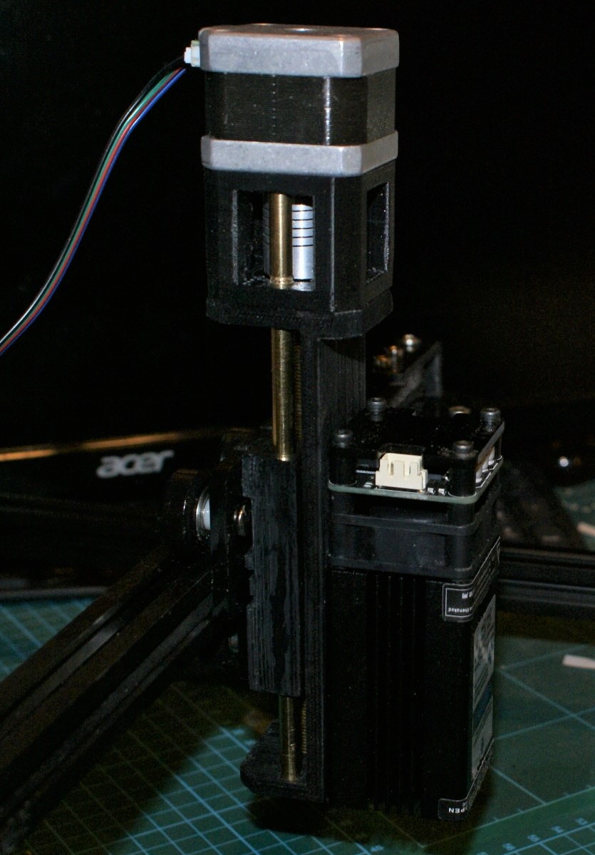

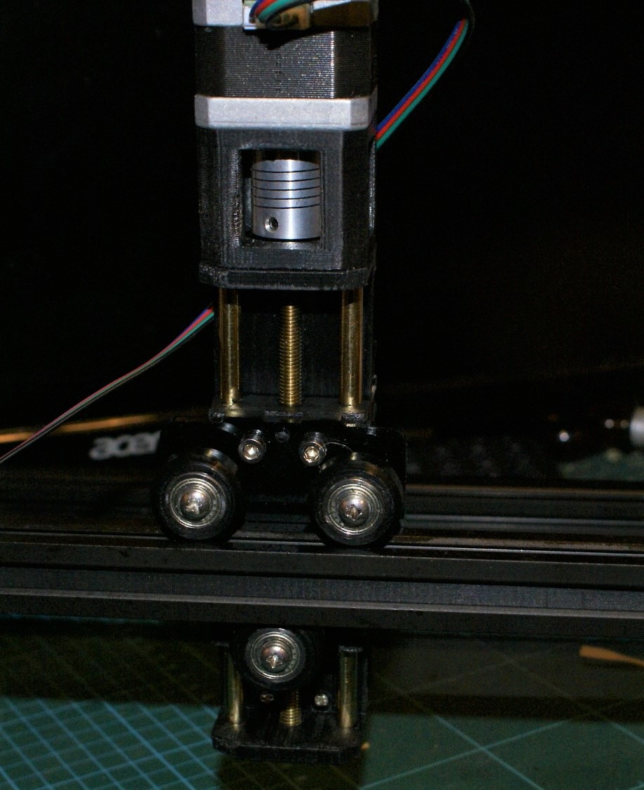

    I bought a 4.2 Frame laser (30W at the barrel ??) and it had a fixed focus laser module on a fixed height mount on the gantry.
    So I made a mini Z axis with my 3D printer, using M6 brass theaded rod as a leadscrew and a stainless steel square nut. The guide rails were 6mm brass rod and the nema17 and coupler were all in a box under the bench. So far I have only bought an E-clip set (yet to arrive) to use two clips to stop the guide rods from moving, everything else I had already.

    Quite pleased with the result. Bear in mind it is for a laser, so no cutting forces and also it doesn't constantly move up and down, it just sets laser focus height for the job.
    Now I need to get the thing commissioned and set up.

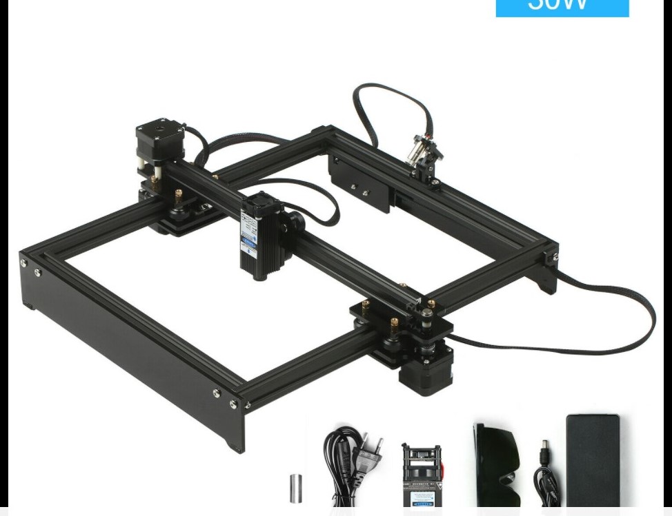

    I am curious (££) what a "4.2 frame laser" is, especially with a laser module rather than tube (it's almost worth abandoning a K40 for a 30W solid-state laser)
    EDIT: Oooer, just looked on eBay - very attractive pricing. What's your experience with these lasers?, any good?, DoC for ply/acrylic? Hmmm, the first hits on eBay typically quote input power, optical power is closer to the 7-8W in the modules that I've seen. Still useful for many things and a lot less bulk than a K40 with cooling systems.

    It looks like this
Name:	Frame laser.jpg
    I bought it as a lockdown toy and it cost £199 from CZ republic. I don't believe 30W from the gun as the power supply is only 12v 5A and it has to power the motors as well - we shall see. The machine came as a kit with a fixed focus laser module, so to get the focus at 20mm you would have to prop the workpiece, which I did not like.
