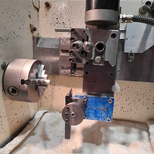

    First shows my adaptor for tool block fitted to slide using existing tapped holes, and my initial attempts at a "rear" parting off toolpost .

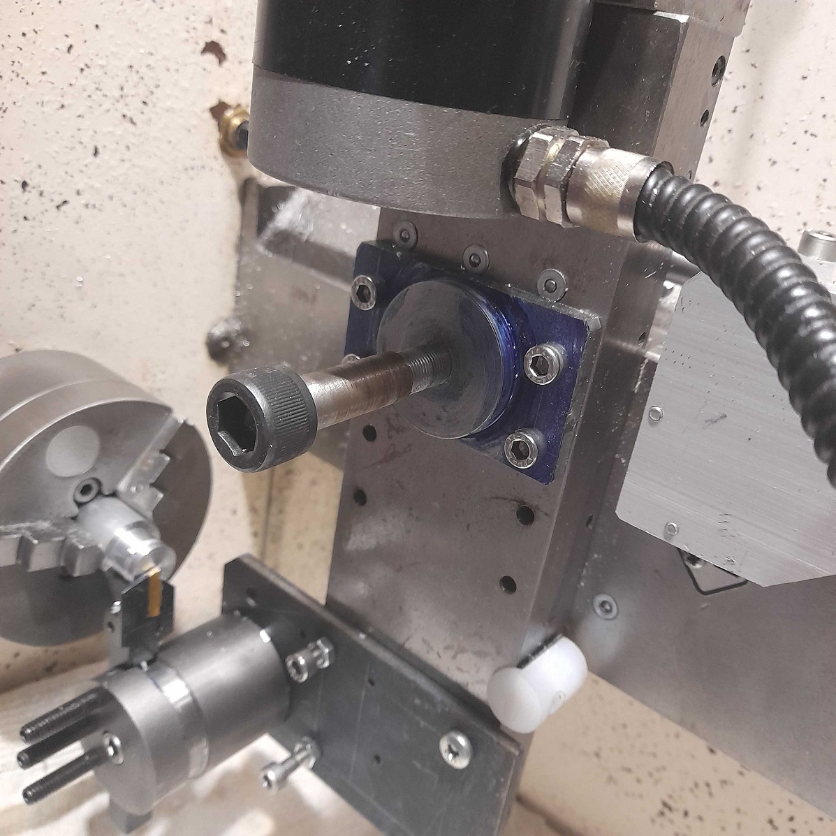

    Second shows improved PO toolpost, with T37 tool block above . I am using a narrow tip tool for the sort of profiling which is generated by Mach Wizards .
    Have to say that Mach 3 wizards have some very inefficient routines , but like the old bike , good enough to learn on.
    Parting off on TCL with 20mm bar struggles a bit so will be looking to see if my DC controller can boost a bit
    Seemed to work , but if I click the pics they get turned 90 degrees , so you may have to lie down for a good look
