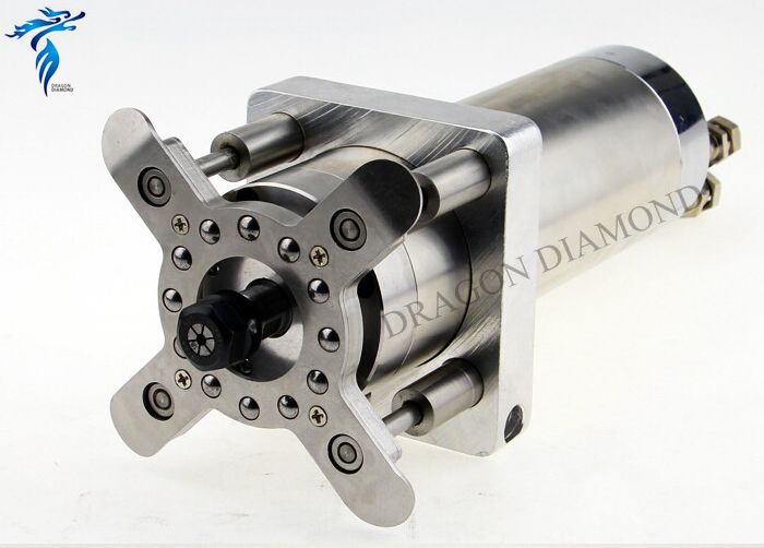

    Have you seen that? Its some new contraption. What are your thoughts?
    I have seen similar but actuated by air and bigger, have seen rollers. I wonder how to suck the chips so the bearing balls could roll. May be blow away constantly the dust. I see a possibility that this could be very useful if the dust is evacuated somehow.

    Looks very similar to a very old design for keeping constant torch height for plasma cutting/marking thin plate when the machine did not have thc.
    Agree. I was thinking more of a usfull for engraving big sheets of thin material, where the material is fixed at extremities but no vacuum table

    Exactly, I have more or less thought about the same thing/design in my head for working with thin wood sheets, 4, 6, 9mm ply and so on, this design isnt a bad one, for mine i considered bigger balls though and just LM type bearing units with round rail - manual adjustment.

    The most useful i have seen till now are 2 gantry wide rollers that pneumatically actuate and roll in front and at back of spindle. A bit of overkill for home use though. Otherwise would have implemented them already in my OTT build

    These are the units I was thinking about, didn't get as far as size just "head thoughts" to date but it's not complex design...

    I'm thinking it could probably have uses on thin material where a vacuum bed is not available.

    Well for spring I thought about just putting some on the linear rail that supports those units, adjust the spring as needed...job done
    I think a lot of commercial PCB machines use an air operatedn spring loaded "pressure foot", no balls, but a short brush dust shoe which also connects to a vac to remove chips,dust etc. My Wessel machine built in 1985 had this system, but I removed it when converting the machine as I like to see the cutter and work when cutting. Another disadvantage for me was that as I made miniatures, tiny components not tabbed in were likely to disappear into the vac bag!!! G.
