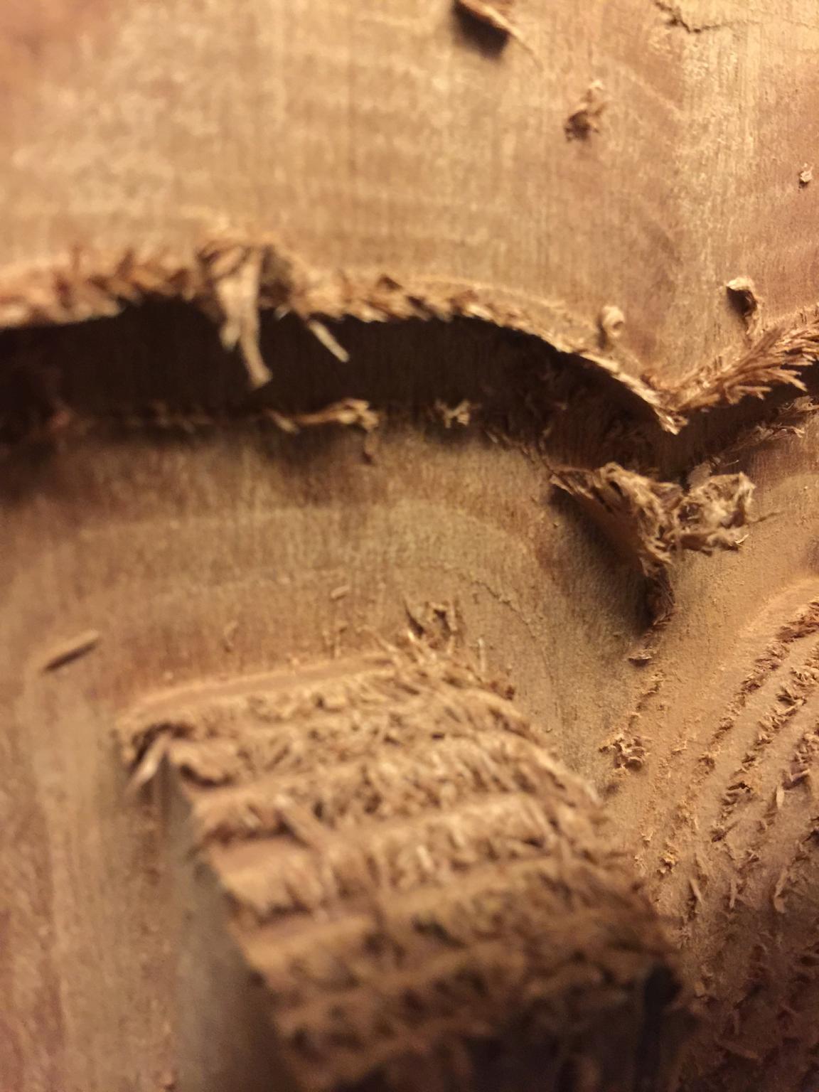

    My Chinese cnc 9060 router has started losing steps in the Y axis,I’ve checked the machine and everything is tight, it’s losing steps at regular intervals almost like it’s built into the software, I’m using Mach 3 and only do 3D carving, not sure where to look next, anyone have any ideas please,Click image for larger version.

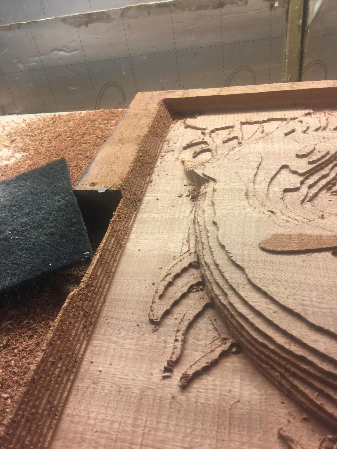

    Edit: Oooer, just noticed the picture (!) - that showing what looks to be a similar number of steps offset on each successive pass in Z?, is there evidence within the rest of the workpiece where the problem is introduced? Is this a problem with a new design, or can you repeat the problem with g-code that previously worked?

    On a 700mm x 500mm piece of sapele doing a roughing cut with 8 passes I’m losing 2mm on each pass on the y axis, it only shows itself at the end of the cut but it starts at the right point for the next cut

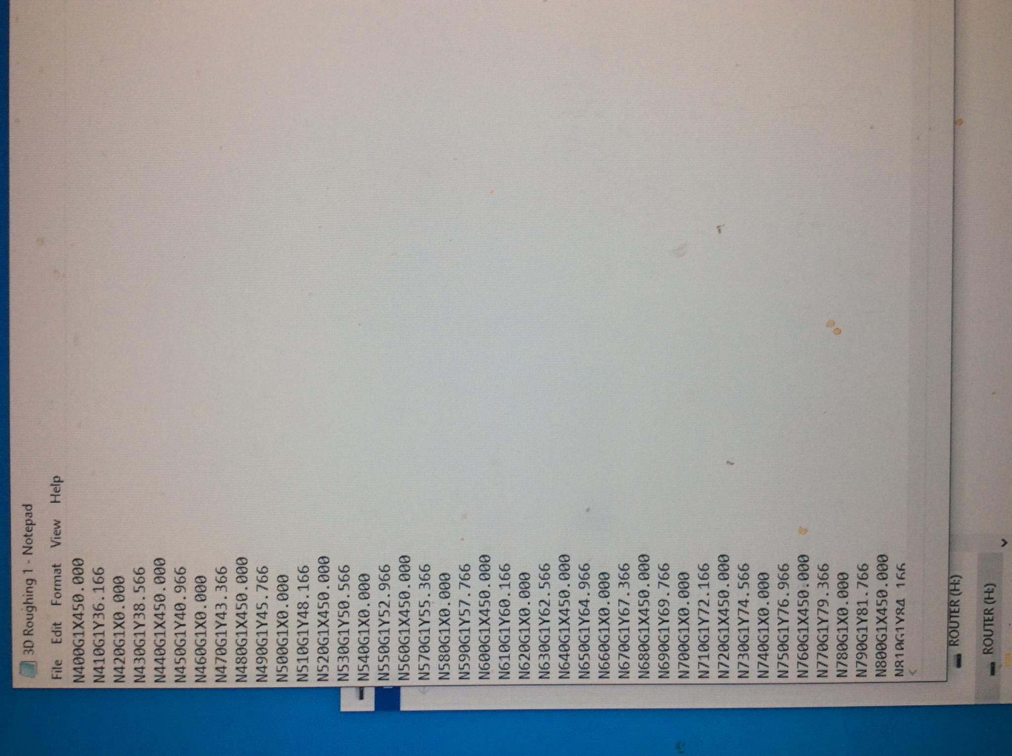

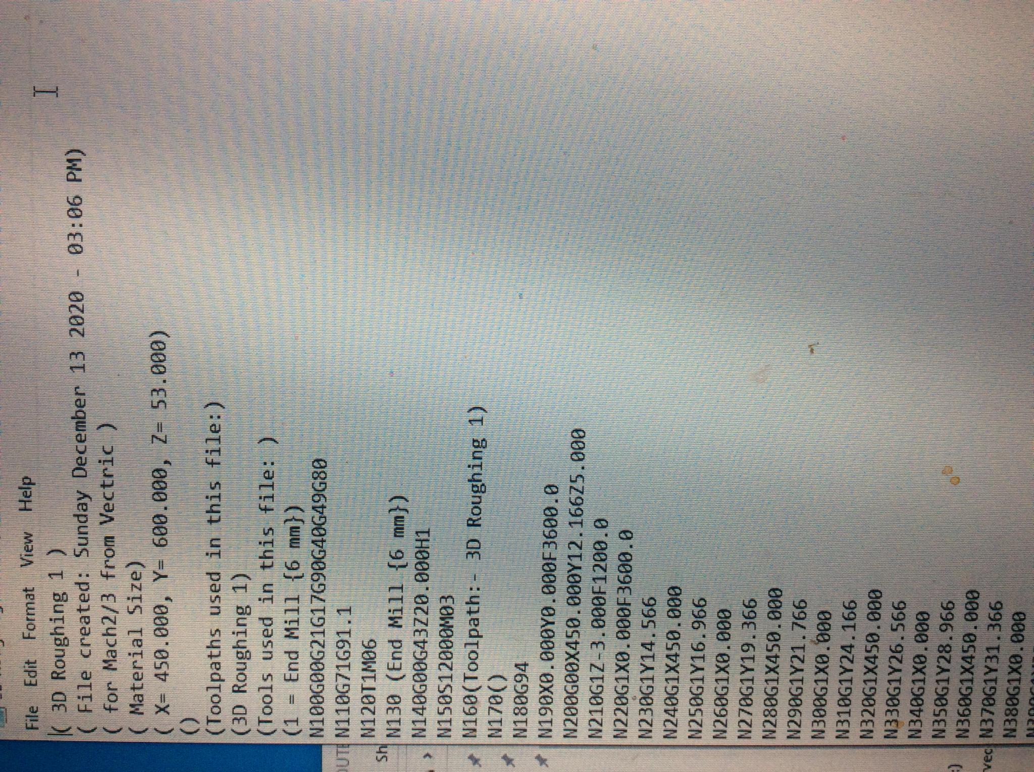

    Do you mean (and I'm possibly mis-interpreting your words here), that for each successive pass, the X/Y recovers to the same position (exactly the same position, no 2mm/pass offset)?
    If so, can you post your g-code?
