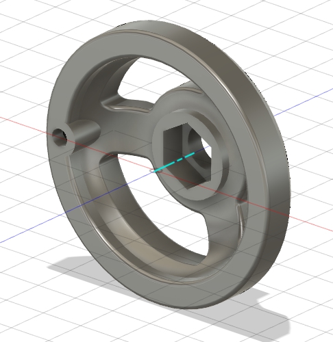

  8. #28
    A bit late now, I am already compensating for my poor choice by printing lightweight handles
  9. #29
    Muzzer's Avatar
    Lives in Lytham St. Annes, United Kingdom. Last Activity: 11 Hours Ago Has been a member for 8-9 years. Has a total post count of 489. Received thanks 81 times, giving thanks to others 27 times.
    I had large cast iron wheels like that on my Bridgeport. I couldn't get a decent response from the DMM servos until I removed them. Their moment of inertia was much bigger than the ballscrew itself and the reflected inertia of the table and vise, particularly on the X axis which had 2 of the buggers. As I have an MPG, turns out I never use the handwheels anyway but your solution would be a pragmatic middle way.
  10. #30
    Oh yes, don't give up on your handles, I am fighting to keep the dials. What is MPG? Miles per gallon doesn't seem to fit the context
    Not fighting to keep these ghastly, spring-loaded, press in before you can turn it handles though.
    New handles need paint - wondered if aluminium coloured paint existed - had forgotten about alloy car wheels - spoilt for choice
