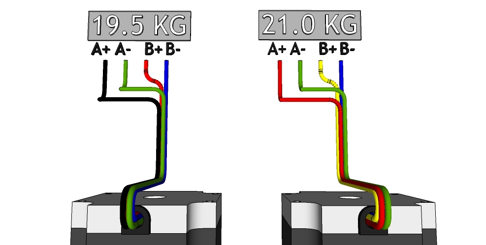

    So I have the yellow wired stepper Pic A Below

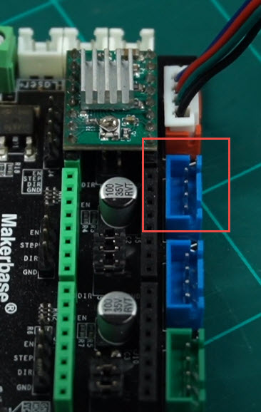

    and I'm making the plugs for this board and its wired with the black one.. Pic B below

    do I wire the plug to yellow wire diagram ? I know it sounds like a n00b question but I thought its better to ask than set fire to something lol

    As long as the correct coil pairs are matched, the only difference it'll make is what direction the motor runs.

    Okay, I've spent 2 minutes on the Makerbase website and given up - have you got instructions for the board, and in particular which are the A+/A- and B+/B- terminals on those 4 way plugs?
    If so - it's easy - work out the coil pairs on the stepper? If you have an Ohm meter (DMM etc) then measure which pair of leads has ~1-3 Ohms resistance between them - of the four wires, there are two pairs each with that low resistance. Then you need to wire ANY pair to the corresponding A+/A- pins (doesn't matter which way around). Wire the OTHER pair to the B+/B- pins - again, doesn't matter which way around. There's a 50/50 chance that the motor will spin in the wrong direction - then swap the pins on ONE pair only (so swap A+/A-, for example).
    If you don't have a meter... buy one. Or short two wires on the motor together (with nothing else connected, of course!) - if you find two that makes it more difficult to rotate the motor by hand - you've found a pair. Confirm by shorting the other pair with a similar increase in resistance to rotation.
    If it makes you feel better - you're not going to burn the house down. The one thing you must do, however, is avoid removing the stepper wiring when power is applied - it's a good way to destroy the drivers (read up on collapsing EM fields)

    Its the red an black wire that always throws me, I keep thinking its live/earth but of course its just polls. It worked wired as in the diagram.
