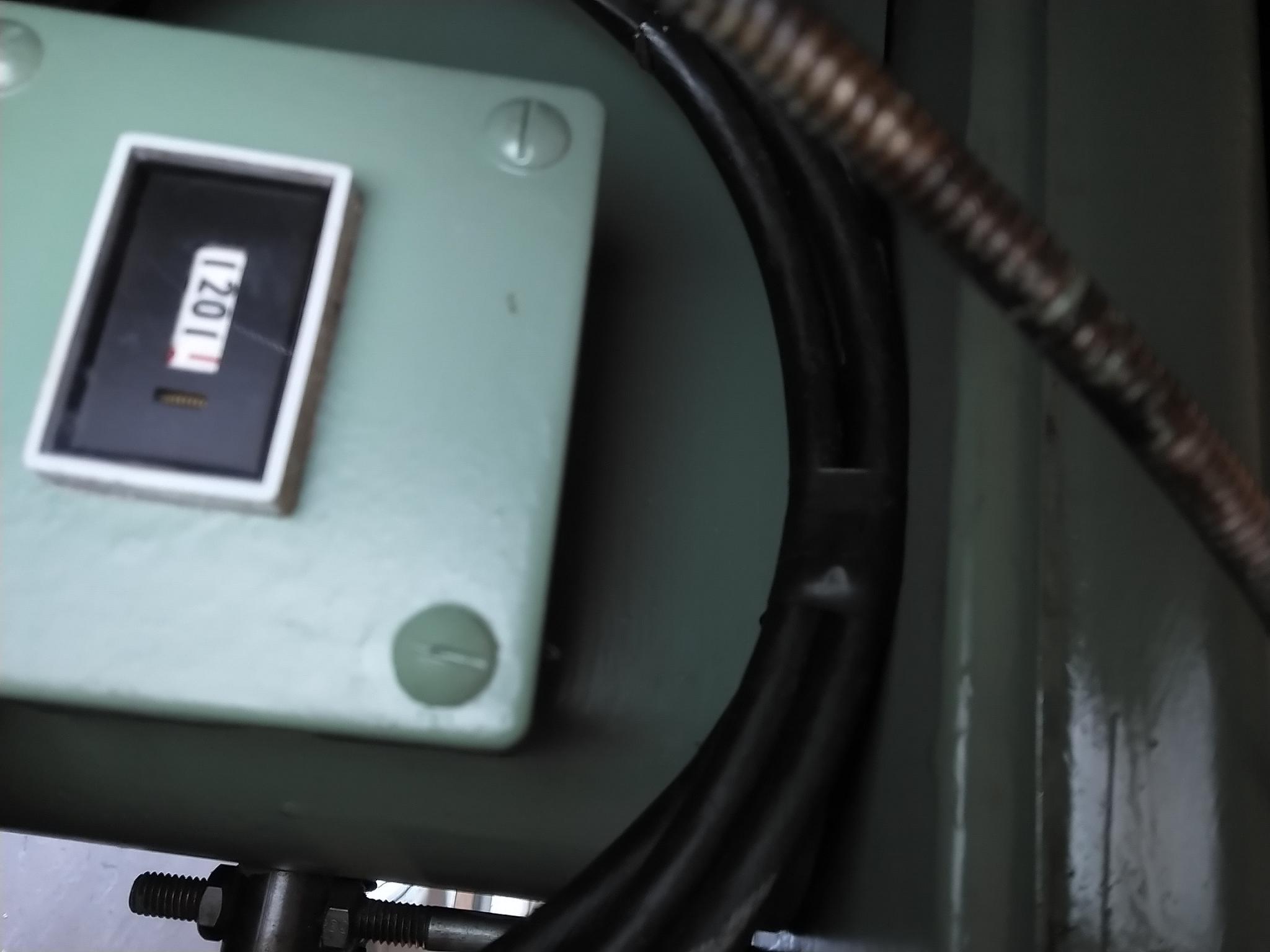

    Hi Muzzer,
    I have a dial on the back of the machine as below, do you know what it indicates. I think its the hours it has been running but not sure ?
