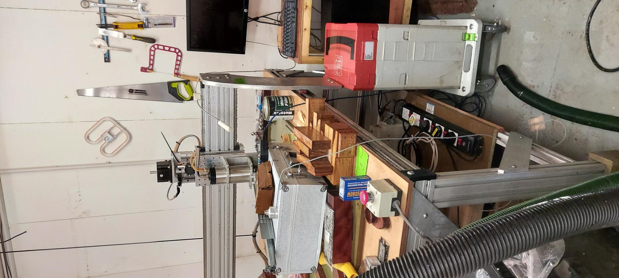

    However I discovered yesterday that i have had a burst pipe in my workshop upstairs which has of course made its way through to the downstairs...
    Hence this !

    Excuse the general disatrous shape of the workshop I had just abandonned ship and then started moving stuff when I discovered the flood.
    Can`t seem to rotate images but you get the idea.
    It could have been leaking for a few days, the guy in the next unit called to tell me because it was going into his side otherwise I wouldn`t have noticed till today.
    So, of course, there is going to need to be a bit of a rebuild situation to say the least.
