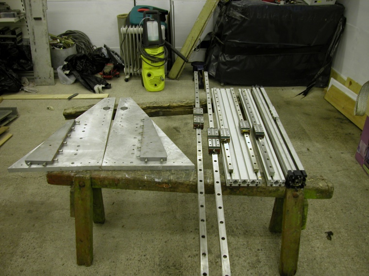

    Well I will try again with the photo's I will just try one to start, if it is successful it shoul be some of my parts after machining ready for assembly

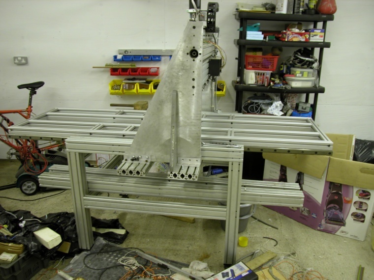

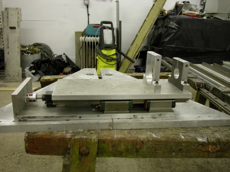

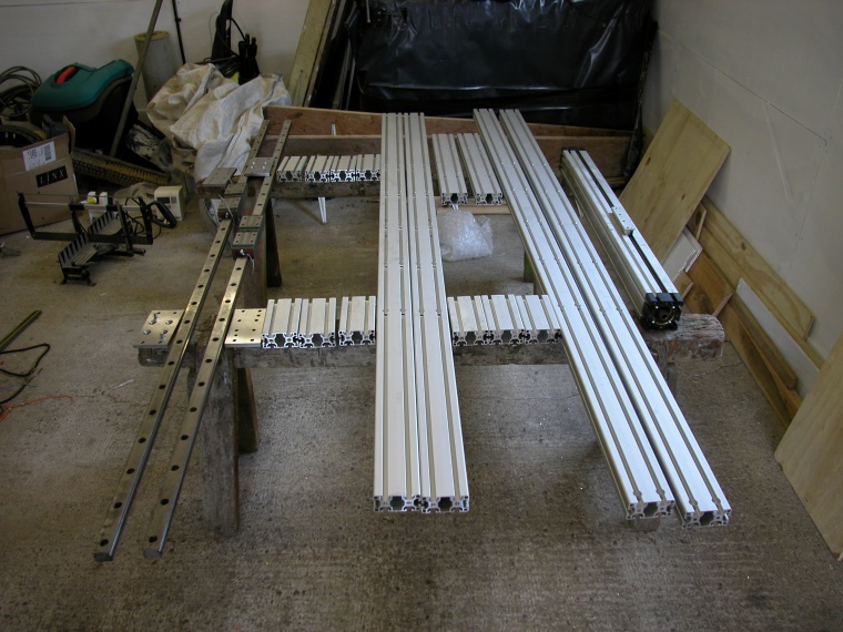

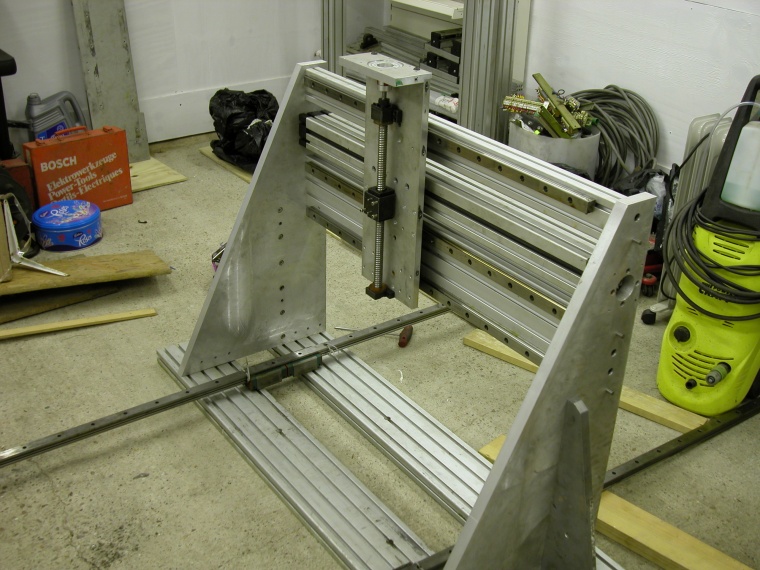

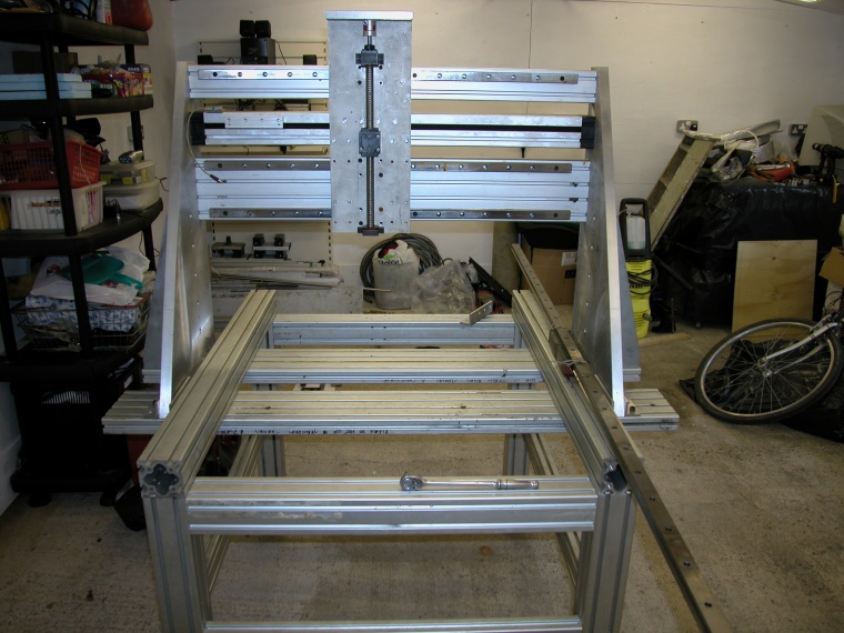

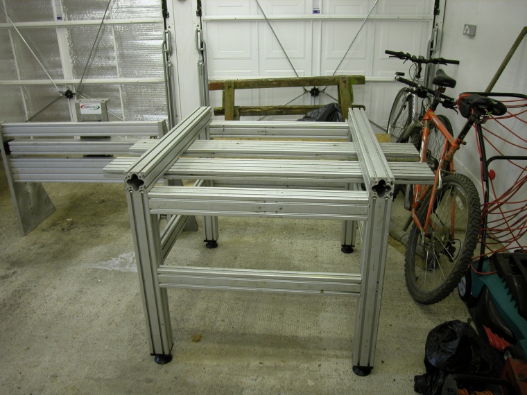

    The next photos show my machine through various stages of my build.

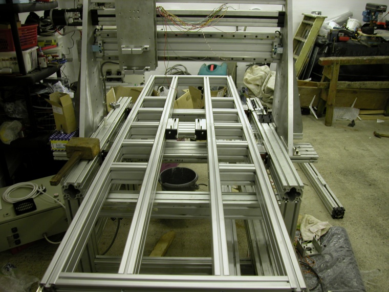

    The first is a side view of my built up Z axis,the next is my X axis and Z parts built. The next part I built up was the table that it all was going to sit on.

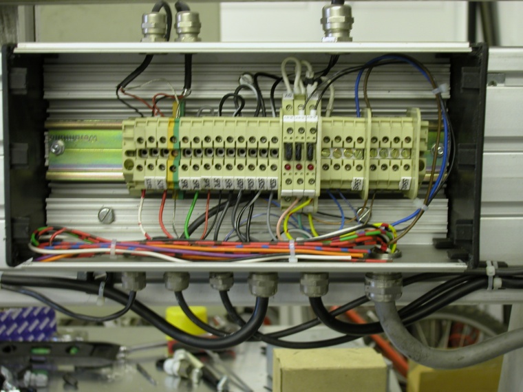

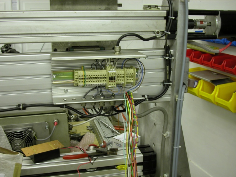

    After mounting to the table I started to wire in my limits and homing switches these all terminated into a junction box on the rear of my gantry I used shielded cable where possible then used a multicore shielded cable to connect them to my main control box.
    The main control box was fastened to the side of the table then the Y axis was built up and assembled.
Name:	Built Z axis.jpg

Name:	Rear junction box.jpg
ID:	414   Click image for larger version.
Name:	Rear Junction Box connected.jpg

Name:	Y axis table parts.jpg
ID:	416   Click image for larger version.

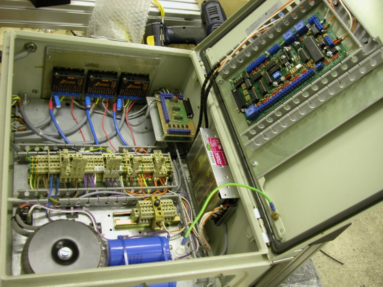

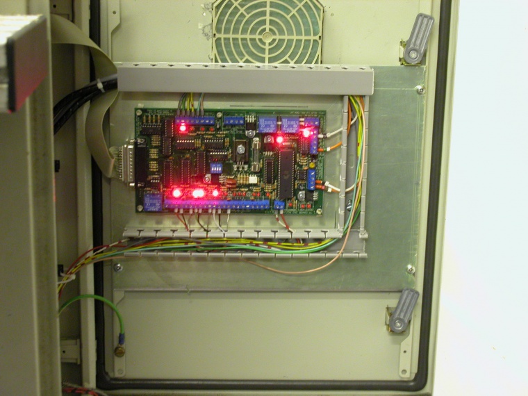

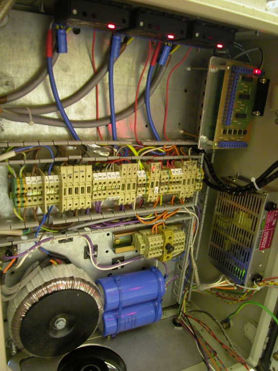

    Ok so here are some photos of the electronics side of things
Name:	control cabinet.jpg
ID:	419   Click image for larger version.
Name:	Powered Up Controller.jpg

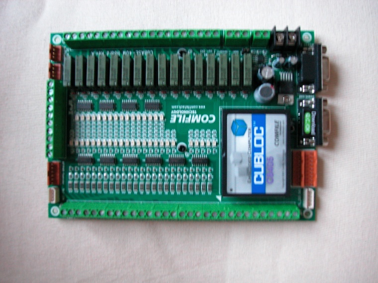

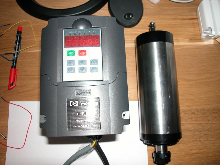

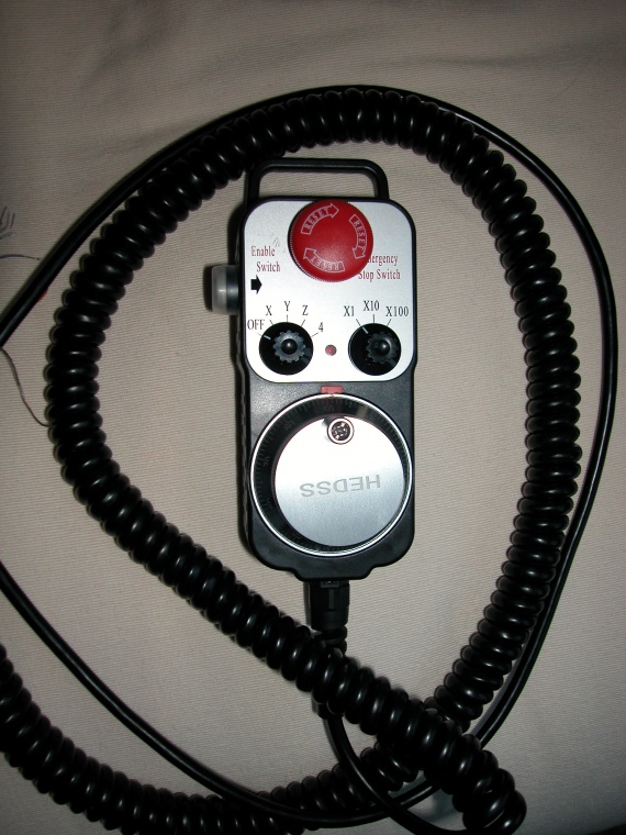

    And here is the future "to do" list, first photo shows the 2.2Kw spindle and VFD, I have had this powered up and ran it up to 24,000 RPM it is so smooth and quiet carn't wait to get onto the machine and try it.
    The next is the MPG this was purchased from Gary at Zapp,after talking to Jeff to find out how he had connected his I realised I was fast going to run out of I/O so I purchased the CUBLOC plc which has modbus connectivity. I have had this connected to my control PC and managed to fire outputs : ).
    As I progress through the above "to do" list I will keep you posted with my progress (or not)
ID:	423   Click image for larger version.
