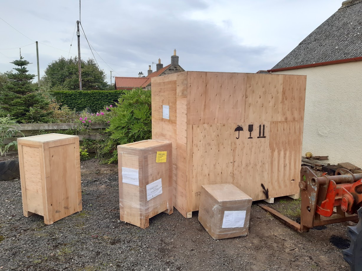

    And as part of the preparation for delivery, I've had to carry out quite a few repairs to my neighbours telehandler, as the resident forklift wasn't quite rated high enough. Although after having to do some juggling earlier, it turns out the forklift rated at 2.3t can lift more than the telehandler rated at 2.5t...
    The result of that, is this collection got delivered this morning -

    They should have been delivered yesterday, however there were other shipments within the same container that customs decided to target, so the whole container got held for over a day, before the shipping company were allowed to unload the non-targeted shipments.

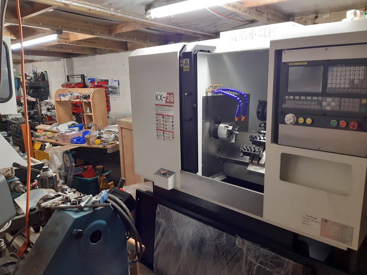

    The machine is now in the workshop. It's still not in it's final spot, as I need to workout how much room the bar feeder needs, which is going to depict the final placement, and the main bar feeder tube is still in it's crate.

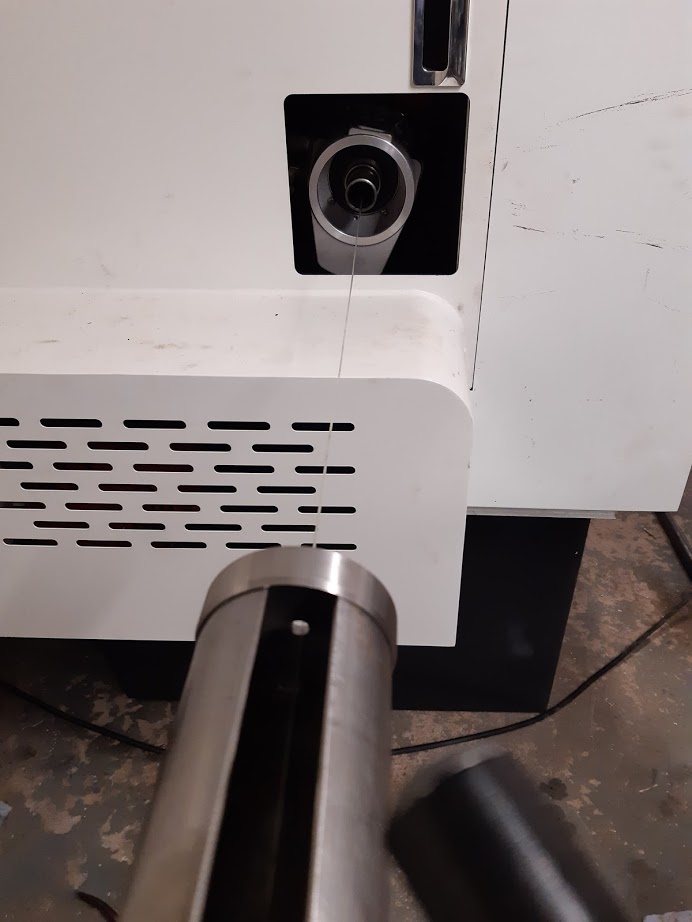

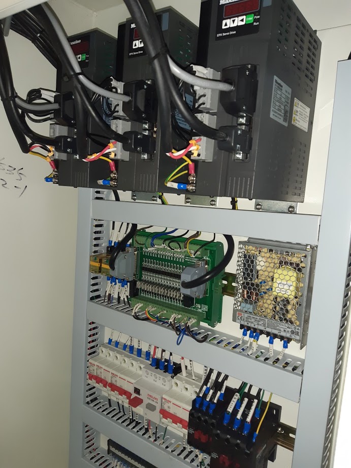

    However, I did put a plug on it, and it powers up.

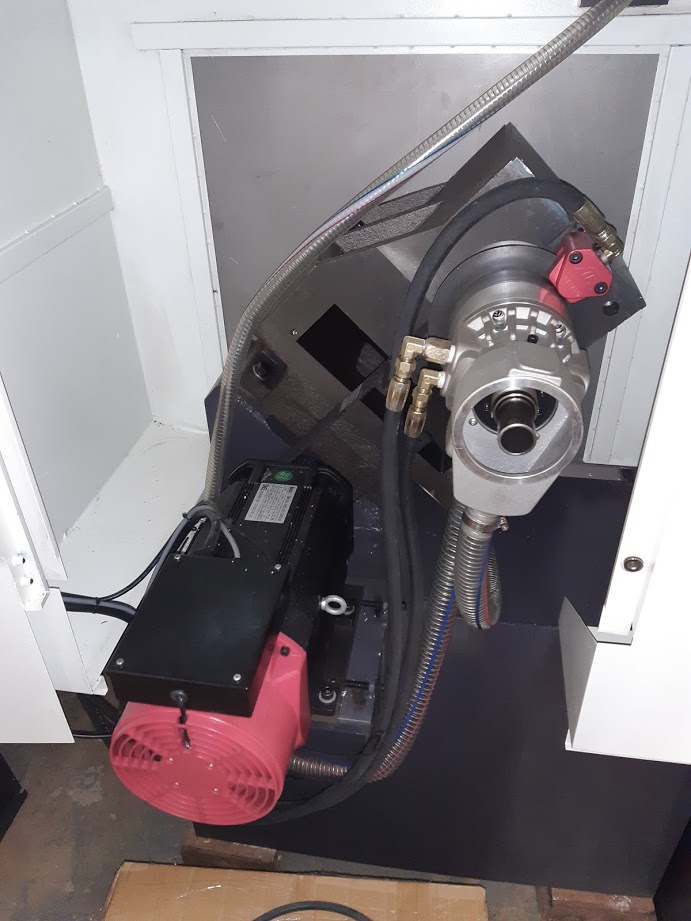

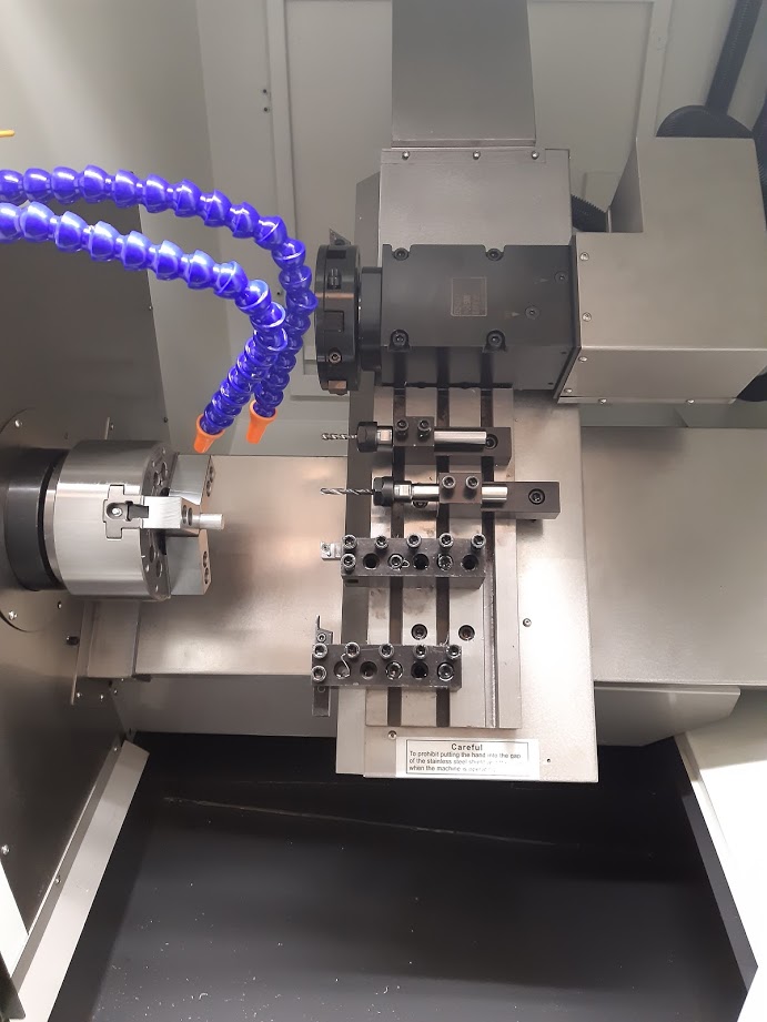

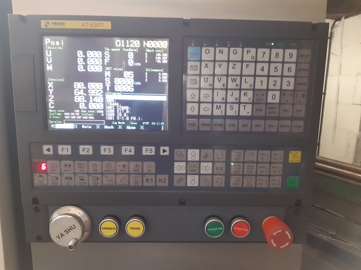

    Key specs are -
    36mm spindle through hole.
    5.5kw servo spindle with brake on spindle.
    Taiwanese hydraulic chuck.
    Live tooling fitted with Polygonal turning head, which also has an ER collet in the centre.
    700mm X travel
    230mm Y travel
    Single bar feeder.
    A few things that stand out, is the pre-sales support from the supplier was brilliant. Any questions I had were answered. I was going to opt for the GSK control, but the manual supplied for the company's own panel was pretty good. Some of the translation isn't great, but it's entirely understandable, with the exception of some of the more complex geometry feed options.
    After production the machine was programmed to make my sample part, and a video sent of the machine in operation.
    I'm out riding bicycles tomorrow, so it's probably going to be Sunday before I get it moved in to it's final spot, and get it making parts.
    For now, I'm off to read the manual to try and figure out how you home the thing...

    I got as far as emptying the old desk tonight, and swapping a couple phases so the hydraulic pump actually pumped, only to realise there's no hydraulic oil in the machine.
    I did manage to home the machine, but the hydraulic pump was making it's lack of oil known :-/
    I don't think I've got any hydraulic oil, so I'll need to see if any of the neighbours have any.

    Lives in East Lothian, United Kingdom. Last Activity: 15 Hours Ago Forum Superstar, has done so much to help others, they deserve a medal. Has a total post count of 2,994. Received thanks 376 times, giving thanks to others 9 times.
    It's now into position, and off the skates. Not quite where I was planning on putting it, as I had to turn a bit to avoid the bar feeder running down the centre of the workshop.
    I managed to find enough hydraulic oil to get the chuck working, so stuck a new length of bar in the chuck to help with the positioning to get a good visual guide to where the bar feeder needs to go.
    After finally figuring out what button the manual refers to the [enter] button as, I've got the control backed up, then spent probably far more time that I should playing with the spindle positioning and the MPG
    Unfortunately I'm back to work tomorrow, but tomorrow nights job is to hopefully get the bar feeder bolted down and plumbed in, at which point I might have to load it up and try the test program before I start modifying things for the parts I need.

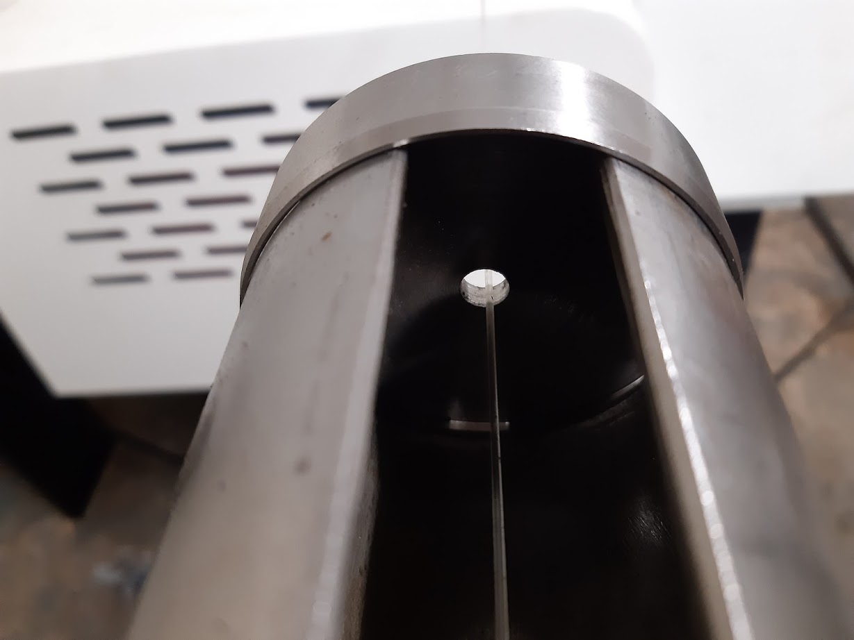

    Who knew drilling 12 holes could take so long?
    It's taken me 2 nights, to achieve this-
ID:	28855Click image for larger version.
    Although that was prior to the final finessing adjustment.
    I managed to get two rawl bolts stuck half in, after using a 12mm drill bit after eyeballing the required drill size. Then managed to drill and fit another two with a 13mm drill bit, but then the drill died, so gave up last night.
    Tonight started off reasonably well despite only having a cordless drill, but the tip gave up on the only 13mm drill bit I could find. After much shed searching, followed by screwfix searching it became apparent 13mm masonry bits are not common, so I actually measured a rawl bolt, and realised they were 12mm. Only good 12mm drills to be found were SDS bits, and the only SDS drill was my brothers 110V. So after lugging the 30+ KG site transformer 100 metres from another shed, the final holes were drilled and rawl bolts fitted in under an hour.
    So at last the bar feeder is bolted down, adjusted, wired in, and pushes bits of bar out.
    I also got the live tooling spinning, and retested the spindle positioning.
    Sometimes it's the simple things that are the most satisfying :D
    So it should all be good for a trial run tomorrow night...
