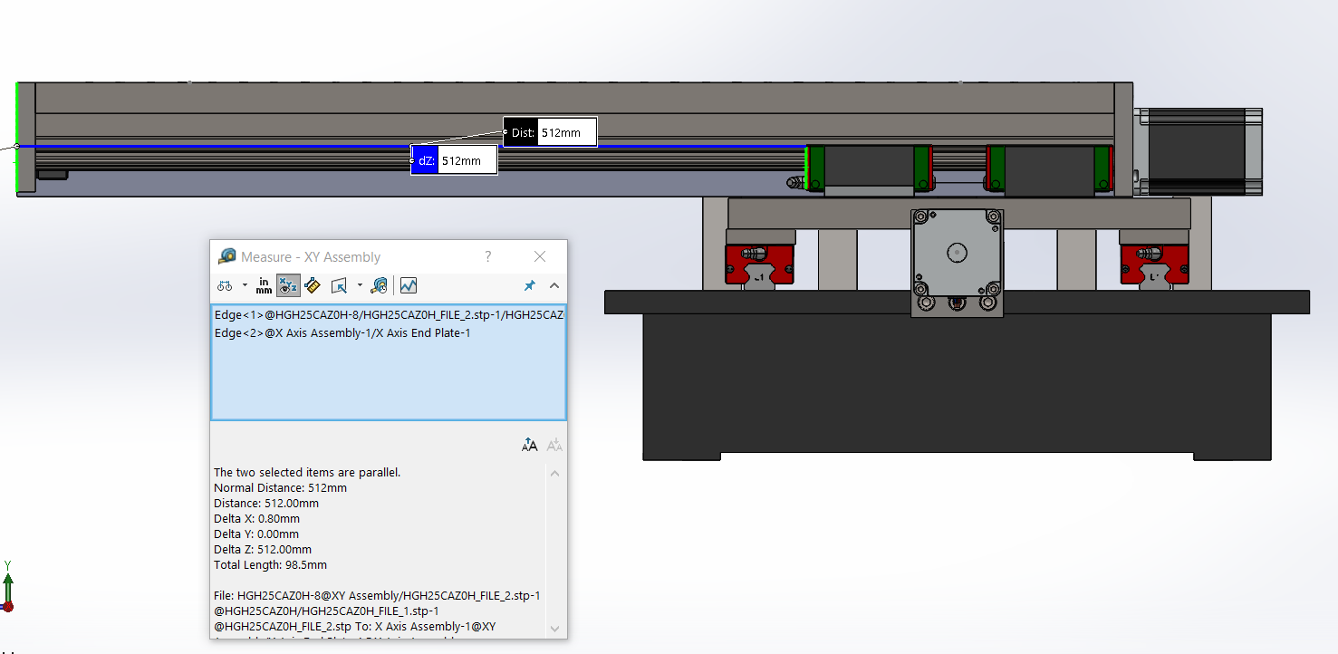

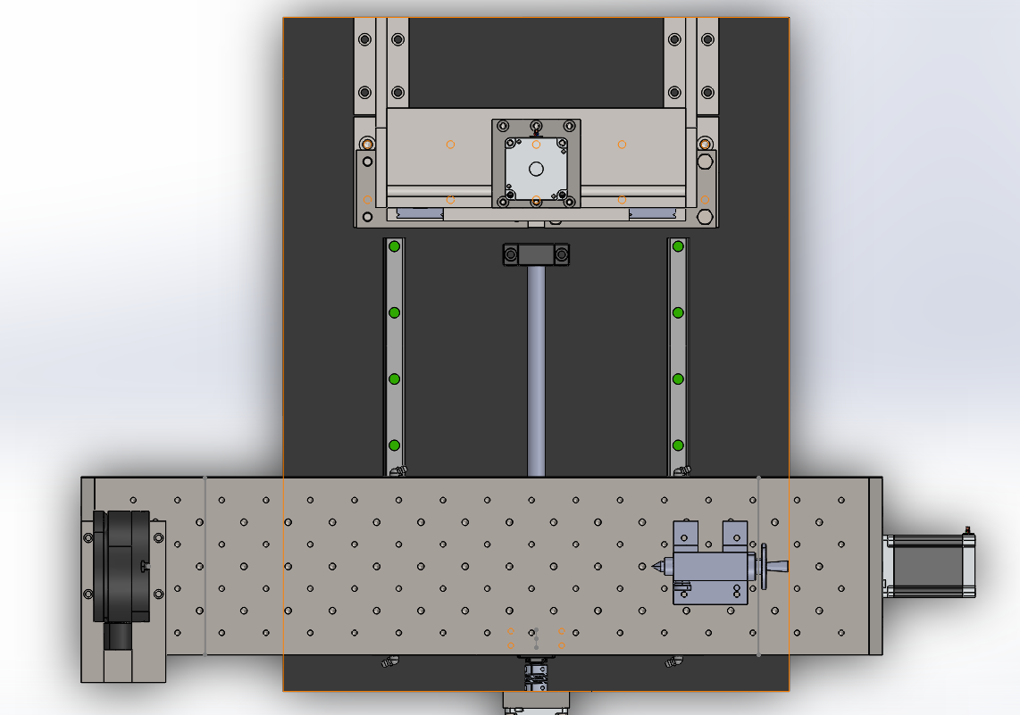

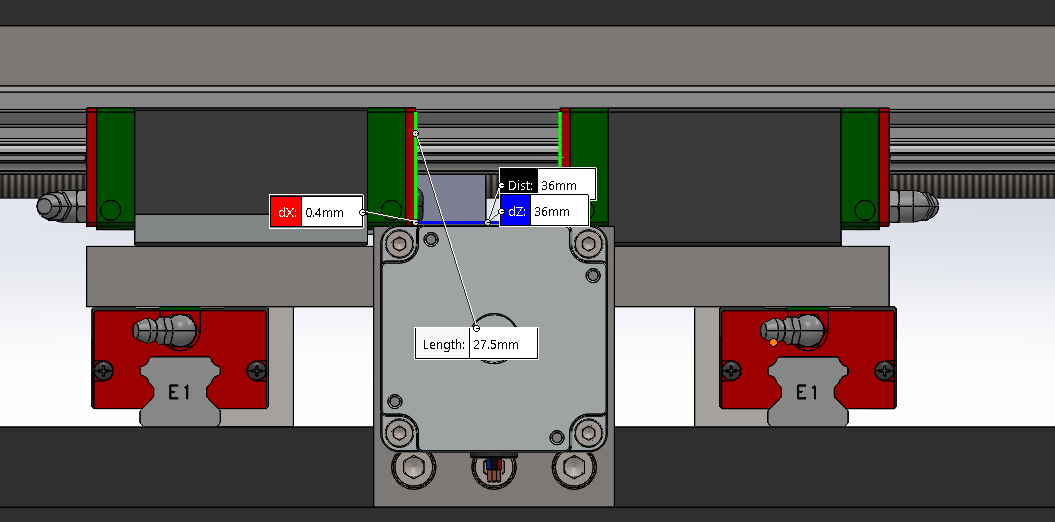

    Widen the Y-axis rail spacing, you have plenty of space so use it. Also, this will allow easier access to the bearings bolts, the way you show it now looks like you the X-axis bearings will block access to the Y-axis bearing bolts.? - One iteration actually has these wider, not sure why i closed them up but i will move them back out,. Nice easy win there
    This brings me to one thing I've been struggling with, the X axis has a lot of overhang. Using 25mm HIWINS with the block spaced 36mm apart does anyone know what the max overhang should be? Obviously the longer i make the table to more travel but there has to be a point where you lose rigidity
Name:	Mill - X blocks.png

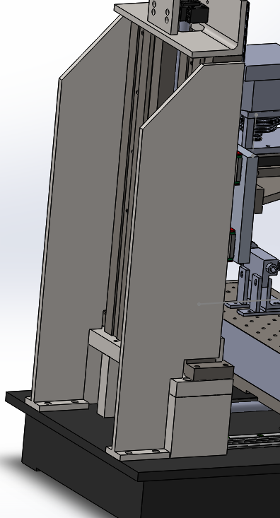

    The triangle plates at the rear I would move to the outer edges and fasten to the side of the columns, this will give a wider footprint, I'd also think about adding some lateral bracing to add sideways support. - Again another easy win. the ridiculous reason they are there is that the column came with holes tapped for the Z rack so i used these. it will actually be far easiest fixing them to the sides as i don't have to drill through the depth off the gusset plate,. Should definitely have been doing it your way in the beginning
    Like muzzer mentioned the column risers look a bit flimsy so maybe beef these up. - Still surprised but you all seem to agree. this may be one to do when i have the mill working so i can skim the sop of some stock to flatten it out. Either that or i could fit letteral section in between the risers to strengthen the riser design

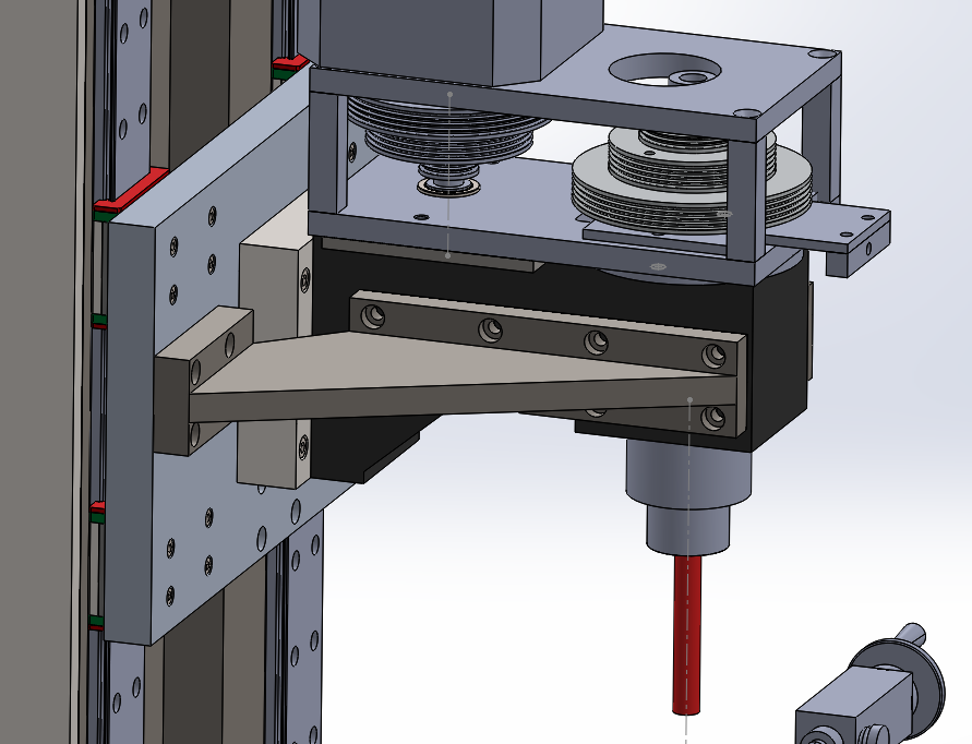

    It's been said but worth mentioning again because it's a Biggy. The Z-axis plate needs to be double the height and the spindle housing needs to be wider.
    Also, the spindle motor plate needs supporting or the vibrations will kill the spindle bearings and vibrate on the machine general. - Ill pick these up on the next revision and repost a snapshot of it

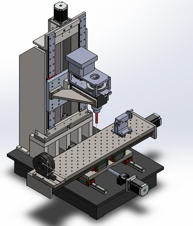

    I'm back with my updated "design".
    I think I've taken most of the advice on board, the glaring omission in the "spindly" legs. My problem with this is the ability to flatten a solid block of steel that size. I've added another leg, actually due to the fixing points clashing with the webs under the Surface plate, but it cant hurt rigidity. Once its up and running i may revisit this.
    General Overview
Name:	Screenshot 2021-02-09 224543.png
    Increased Z Carriage
    Head Strengthened Laterally
    Pully Drive Fixed down to the head at the back

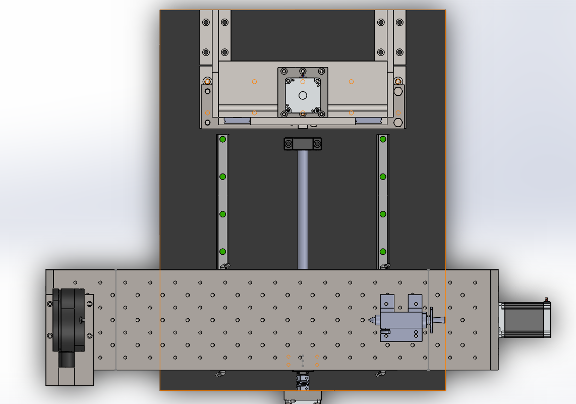

    I've also lost the T=slotted table and decided to go with a fixture plate type setup tapped for 6mm bolts and drilled and reamed for 6mm dowels for alignment. The table has got longer though which makes the overhang a bit of a worry.
Name:	Screenshot 2021-02-09 225258.png

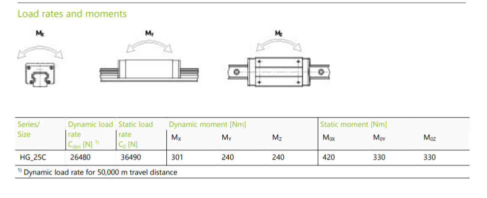

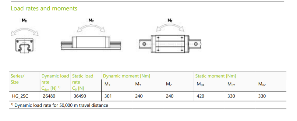

    My reading of the HIWIN Data sheet for the HGH25 say dynamic moment My is 240Nm equates to c. 24Kg at a meter for one block, my total distance from block to furthest point is c.0.5m meaning 48kg is required to hit the max, there are 2 rails, so 96Kg and that doesn't account for the blocks being in pairs per rail, which you would assume would have a fairly large impact torque applied.
    So if i understand the Data i could put over 100kg on the table at full extension and still be in the limit. If that is the case i have no worries but it just looks wrong. Could someone check my logic.
Name:	Screenshot 2021-02-09 231052.png
    The last lot of comments were a big help so any more would be appreciated.

    Starting to look almost like a Deckel
    So cant be bad !
