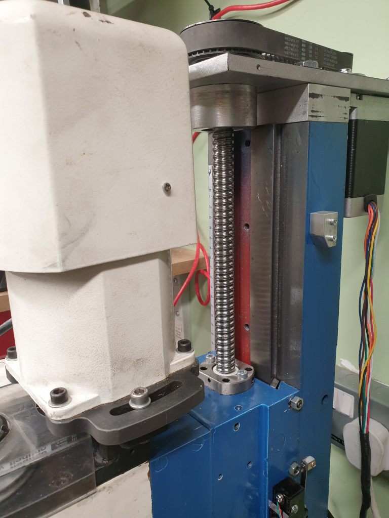

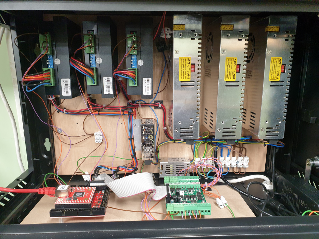

  5. #34
    OK cnc people,
    Just an update on where I am at with my mill
    I have fitted a new ball nut to the z, turned out there where no balls in the nut on the machine when I got it and the z was running up and down just on the wiper bushes ...lol, so thats fixed now.
    I have fitted hardware from uccnc, a ethernet motion controller UC300ETH and a UCSB breakout board along with installing their software, took a little figuring out but not too difficult.
    Run some test cuts in acrylic and aluminium tonight which highlighted some backlash in the x but found it was a loose nut on the thrust race, after resetting that cuts where good.
    So all in all I'm very happy, still have some guards to make and have to fit a coolant pump.

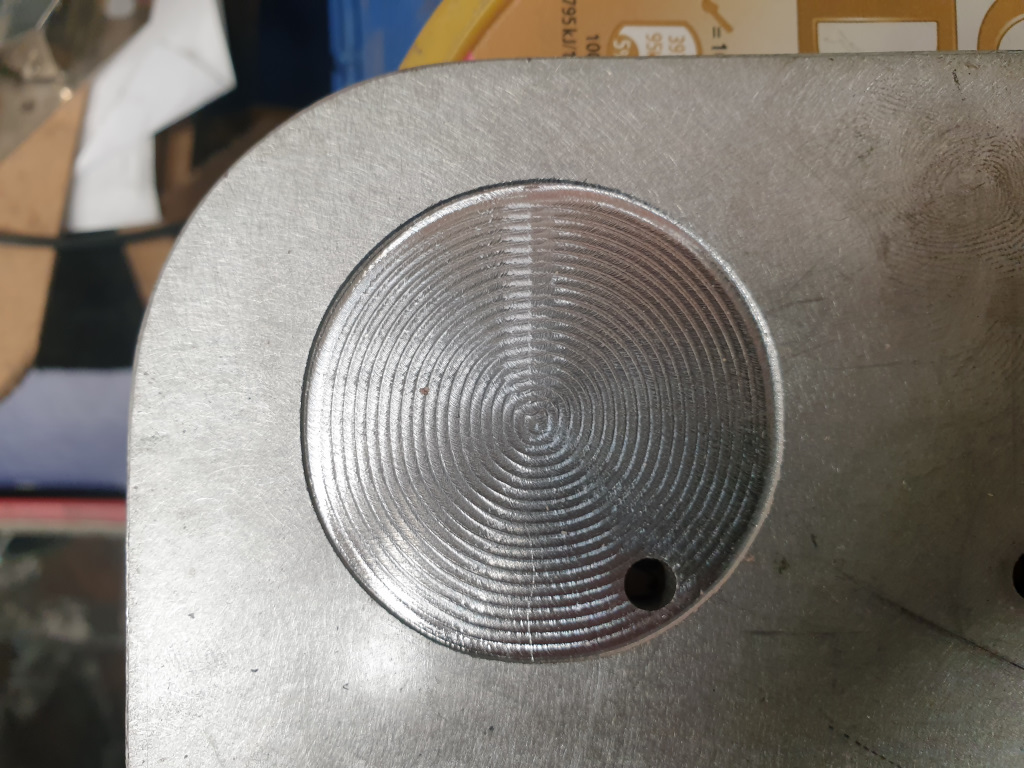

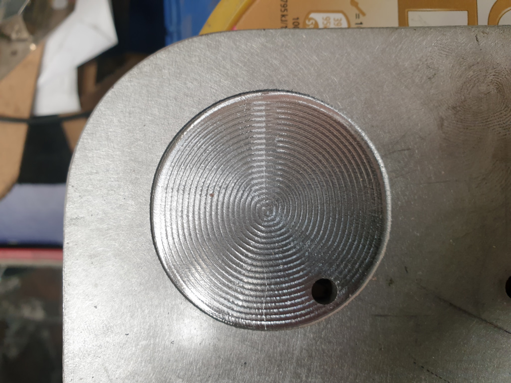

Name:	first attempt ally (1 of 1).jpg
  9. #38
    first attempt cutting ally, 1mm deep cut with 3mm end mil, 50mm diameter circle, you can see from the pattern left by the cutter i have some backlash or play issues but i think i can sort them out
  10. #39
    Might be a small element of tool deflection at play as well. Good to hear that you're getting on.

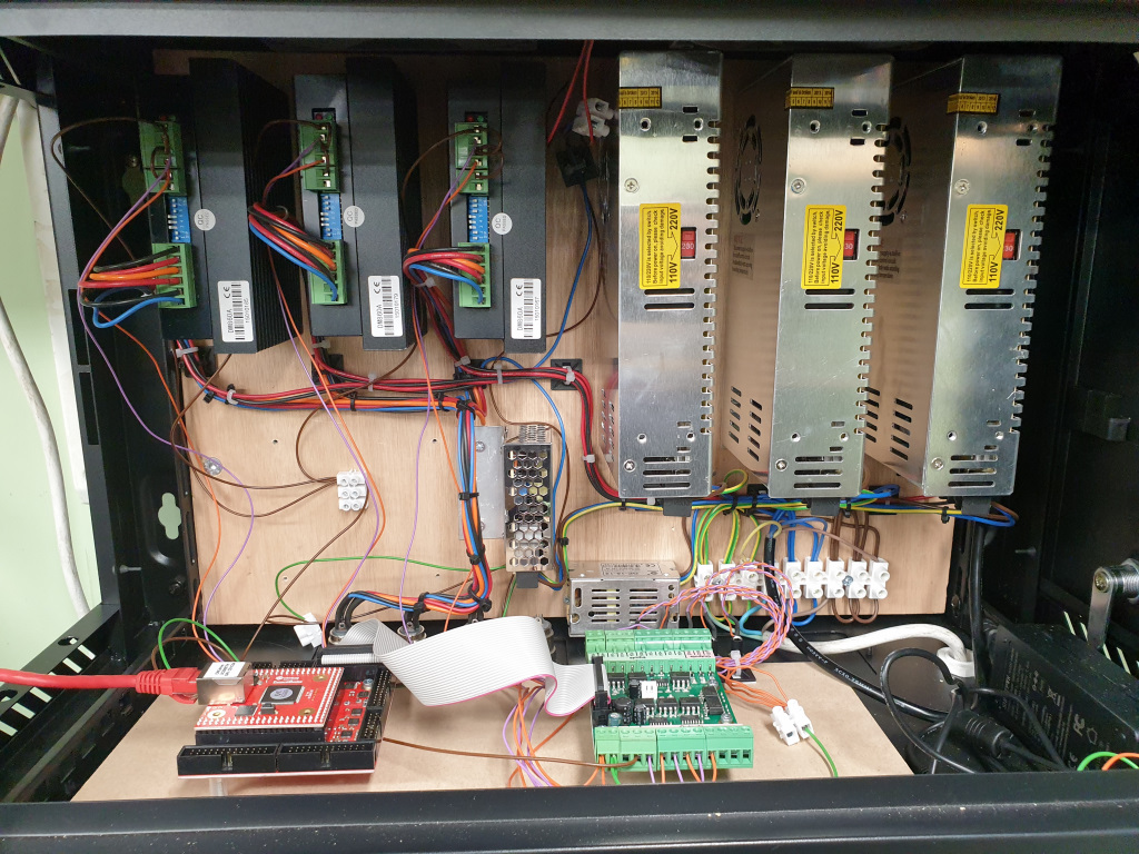

Name:	un300eth (1 of 1).jpg
    new uc300 ethernet card and breakout board wired in
Name:	new Z ball screw and nut (1 of 1).jpg
    new Z ball screw and nut fitted, when i say fitted i still have to put in the other 4 cap heads but i was eager to test
