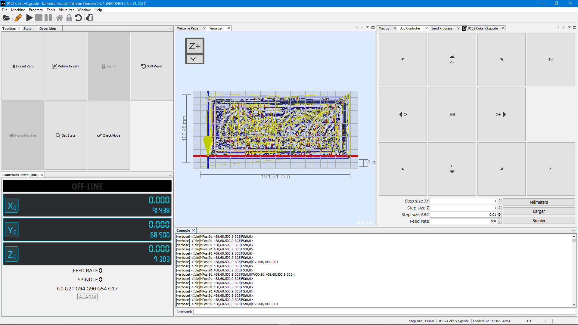

    . If i tell it to jog on the z axsis 1mm and press run the spindle runs about 20mm but on the readout red screen it says it has run only 1mm so that reads correct but the spindle is wrong
    The DRO if set to 1mm will show only 1mm.
    Colin
    First please put use the correct terms I mean tell us what is the reading on the DRO when you said you have moved down 1mm have you noticed the minus sign so it really says -1mm this in important. Now I know that when the Z goes down it goes -ve.
    When you ran the code and I am not familiar with GRBL I noticed when the Z when down and it was not -ve it said 9mm
    Now the first thing we need to get right is the fact that your machine on the Z axis it is moving 10 times too much. This has to be corrected before you carry on.
    Is there any settings that you can alter. Pleas post a pic of the settings page. Can you open the control box a post a pic of the drives?

    Hi iv'e been looking at that video link you sent me and it is very informative and helpfull so thank you for that. As far as the DRO is concerned if i set the depth of say 1mm on the DRO screen yes it doe's show the -1mm. Here is an image of the GCS in use with a Coke sign which i'm working on.
Name:	gcs test 1.png
ID:	29508G-CODE CNC BACKUP.txt This on is the setting of my cnc as followed per instructions of that tutorial video you showed me.
    I hope this helps , i'm not sure on all the termanoligybut ill get there.
    Thaqnk you freind Colin

    Colin as I have said there is no point in trying to cut anything until the parameters are set correctly.
    Now concentrate on the Z axis only .
    Find a block of wood about 50mm thick put this on the table and Zero the Z on the top of it.
    Then move the block out of the way and command the Z to go down 1mm the DRO should read -1
    Then measure arcuately how far the Z travelled down from the top of the block and report back.
    This is the line in your text file you posted that we will alter to get it right $102 = 1900.000 (Z-axis travel resolution, step/mm)
