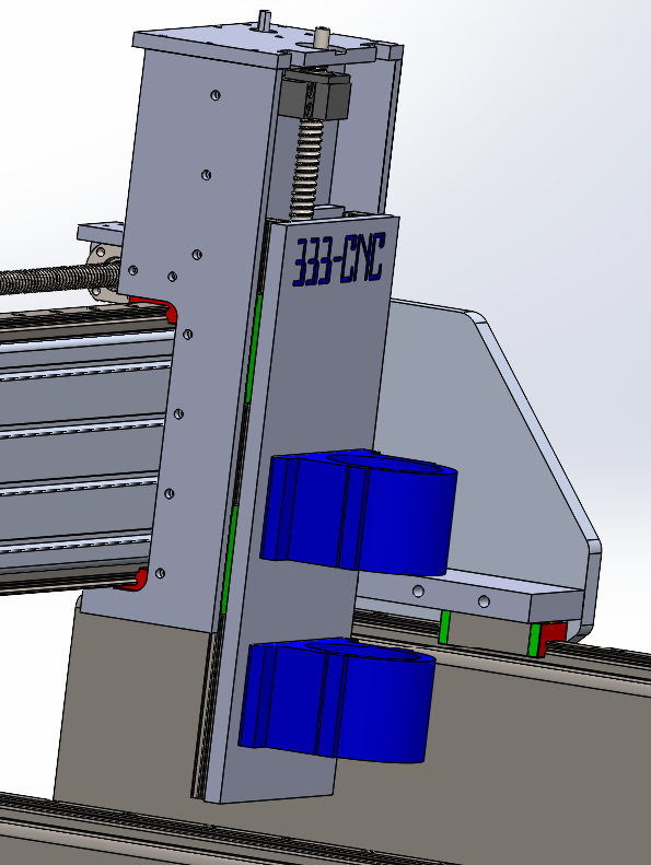

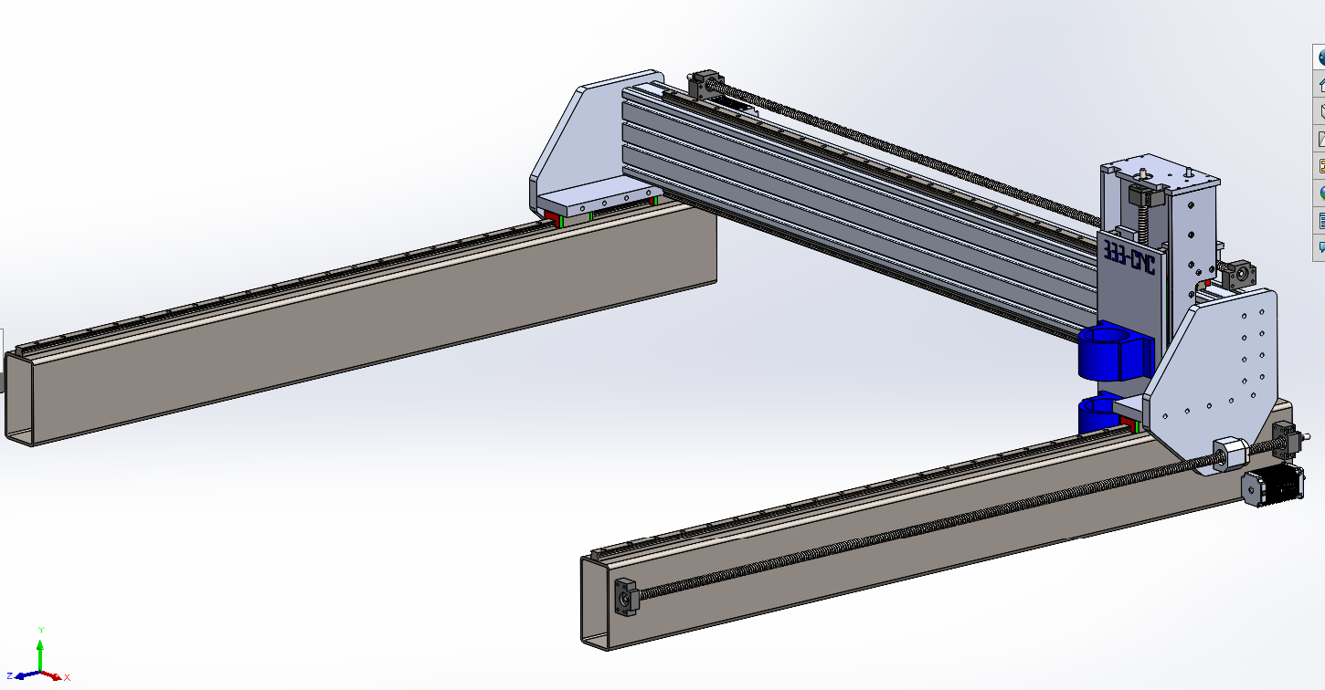

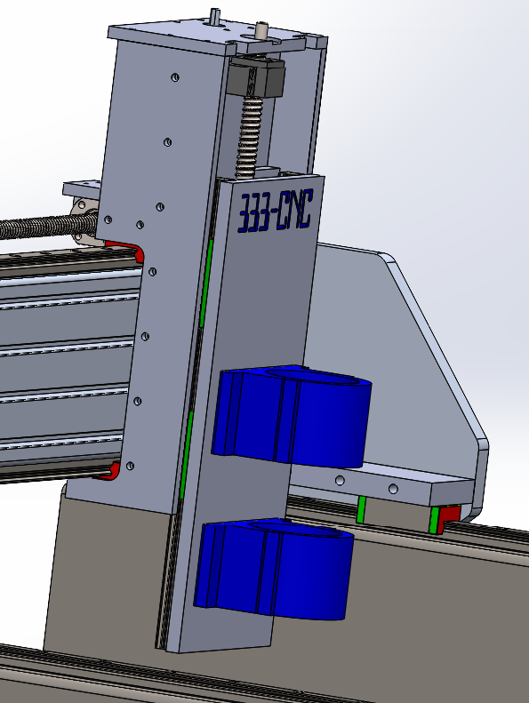

    Hello all, thought it was time to introduce myself and my CNC intentions. Last year I came across the 3d printed cnc router and thought I needed to build one so, after a little research I found myself wanting to build a much bigger, stronger and capable CNC router. I started designing last year and after researching this site I managed to come up with an idea of what I would like. I am hoping to have some constructive criticism from other members on my design. I also done the rookie error of purchasing certain parts that may be incorrect, but will right my wrongs at my expense! So a little background;
    Machine intentions are to be able to comfortably machine soft & hard woods and ideally aluminium.
    Machine size;
    Gantry - 1700 mm with 1500 mm rails mounted to 80160 HD aluminium extrusion.
    Z axis rails 400 mm with approx 175 mm travel
    Y axis rails - 1500 mm
    This gives a working area of (Y)1200 x 1300(X) allowing to use 4x4 ply or even 8x4 supported off the table, if this makes sense?
    My design work is all done on Solidworks 2020.
    Parts purchased;
    2.2 Kw water cooled Spindle (Gpenny).
    20mm square linear rails with bearings.
    1605 ball screws for all axis (Concerned these may be incorrect for build).
    Nema 23 steppers - 3Nm 4.2A - 23HS45-3504S.
    Stepper drivers DM542T.
    Below is a snip of the work so far;

    It is work in progress but thought I would post before purchasing and designing anything else.
    Thanks for reading and look forward to opinions
