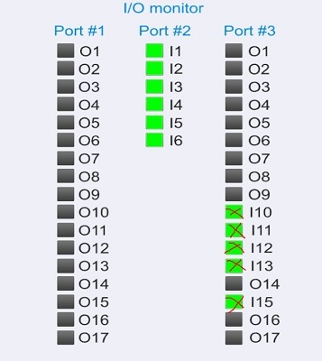

    Hi
    Trying to prepare AXBB-E to run 5 axis and ATC-6th
    Port #1 and 2 all as I wanted but on Port 3 shows active all inputs
    Those pins shows 4.6V against 0V and nothing is set or connected - any idea?

    I wouldn't sweat the port-C settings - likely pulled-high by design. I'll check my AXBB tomorrow but expect that it's normal behaviour.
