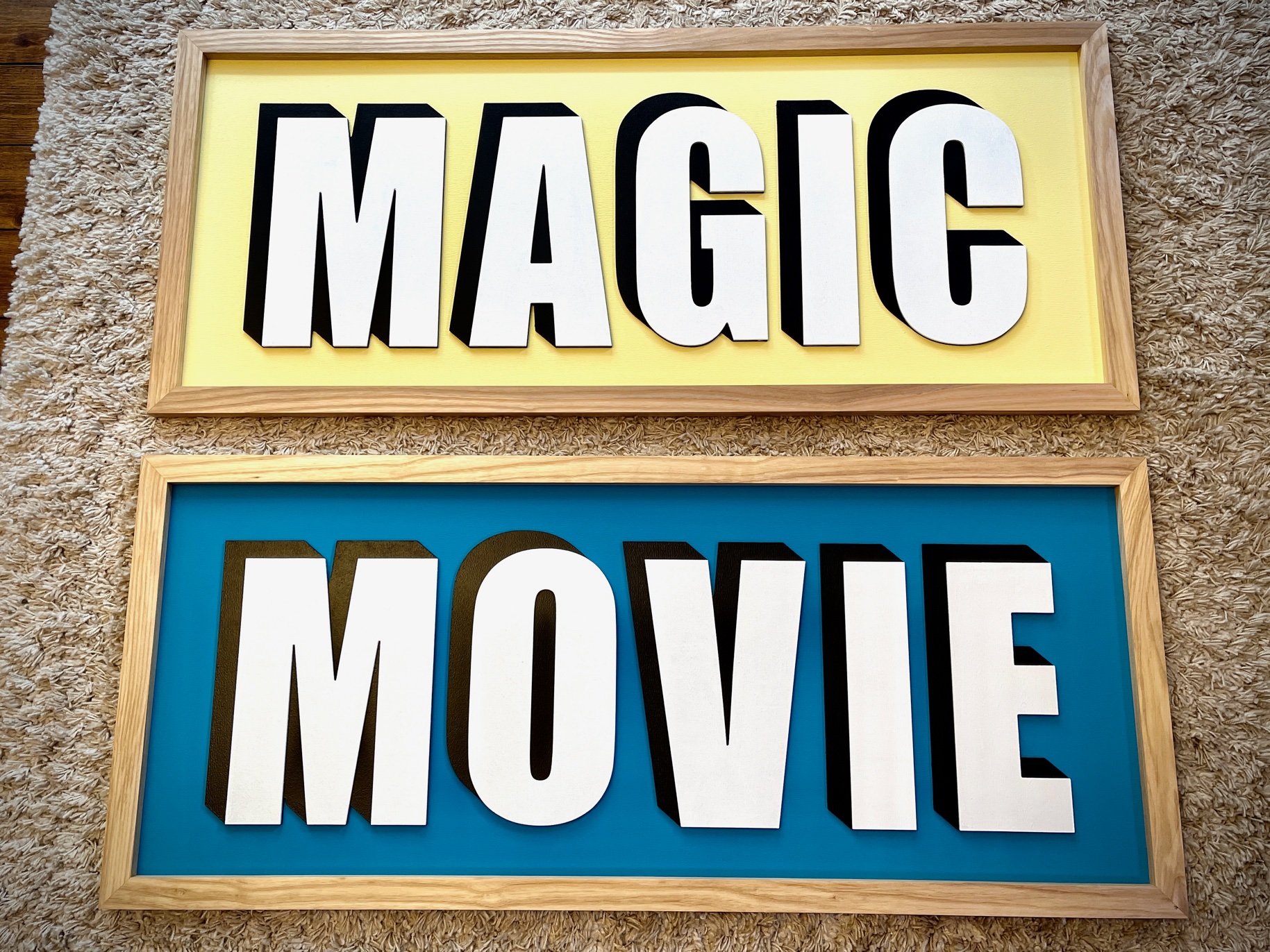

    Another family member commission. Very simple letter cutouts - not really the cnc stuff I like - crap mdf, but looks pretty effective. Idea ripped off one of those funky home wear sites. They are punting these out at £135 each with £20p&p. Recon they can’t make them fast enough. Suppose it’s all down to marketing and the platform and reach you have.
