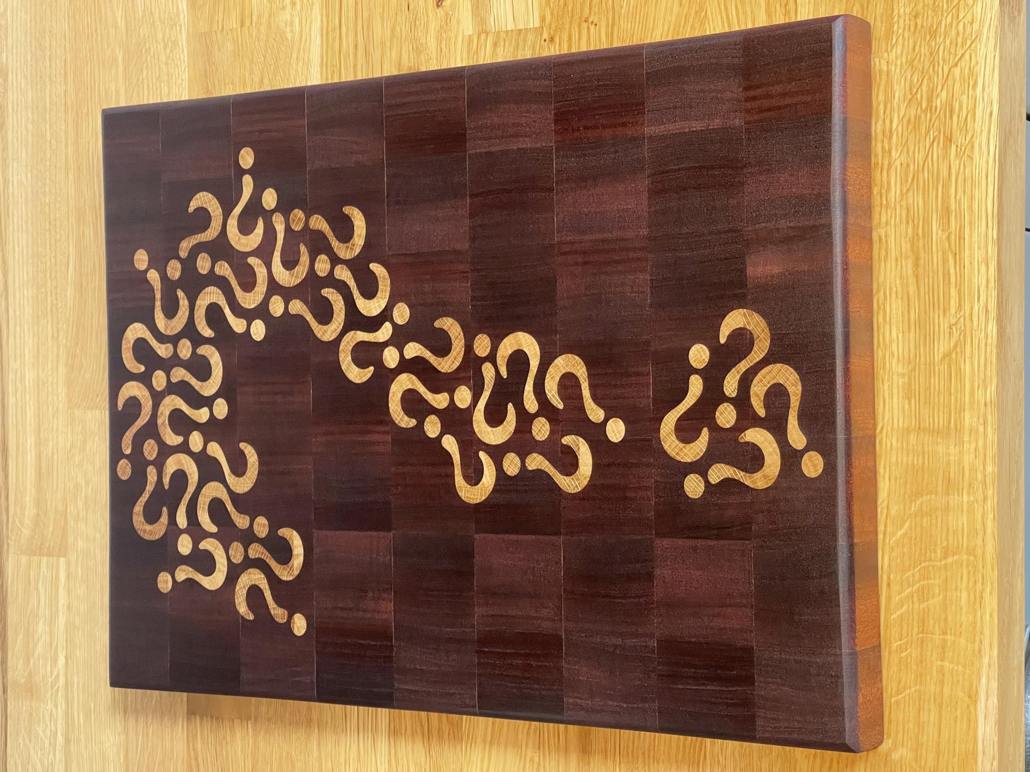

    Oh yeah, one up manship! Mine is a mere 600x900. Dean can I order a 1201x1201?!

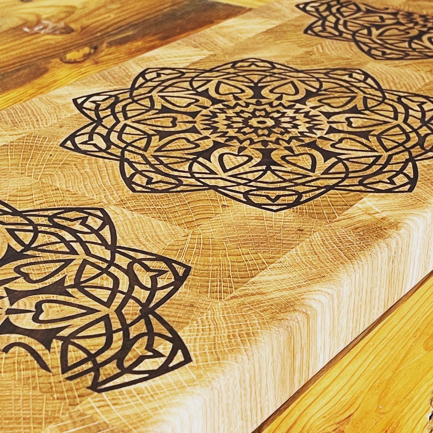

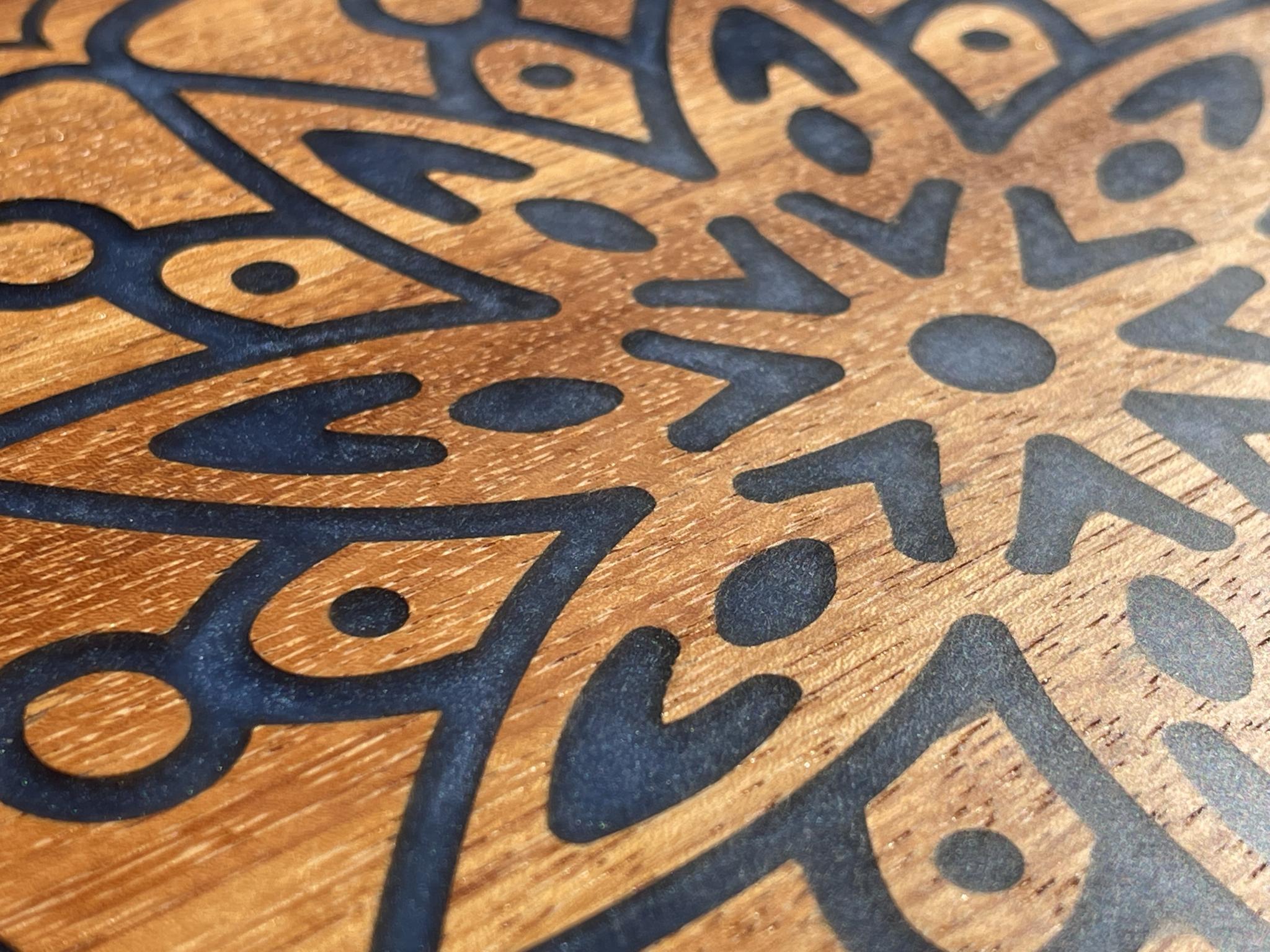

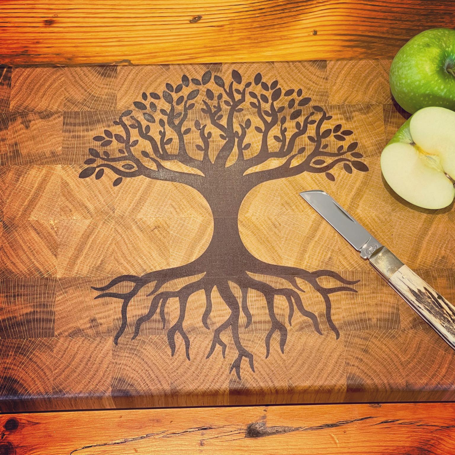

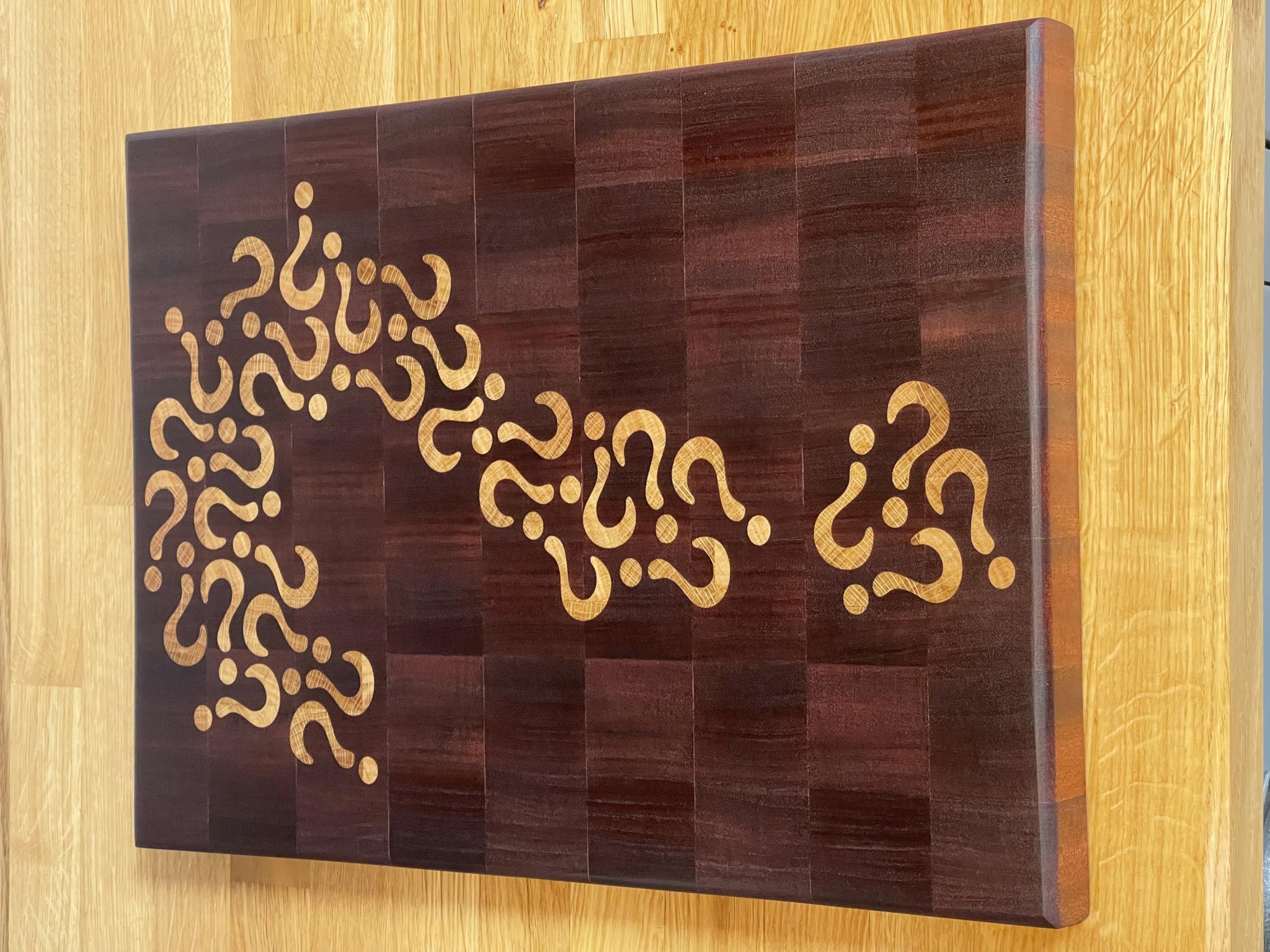

    Here are a couple more bits and bobs I’ve racked up in the last week. Still honing skills but learning all the time. Even went barmy and spent £20 on a proper make bit instead of my Banggood specials! Now that I do not want to break!
