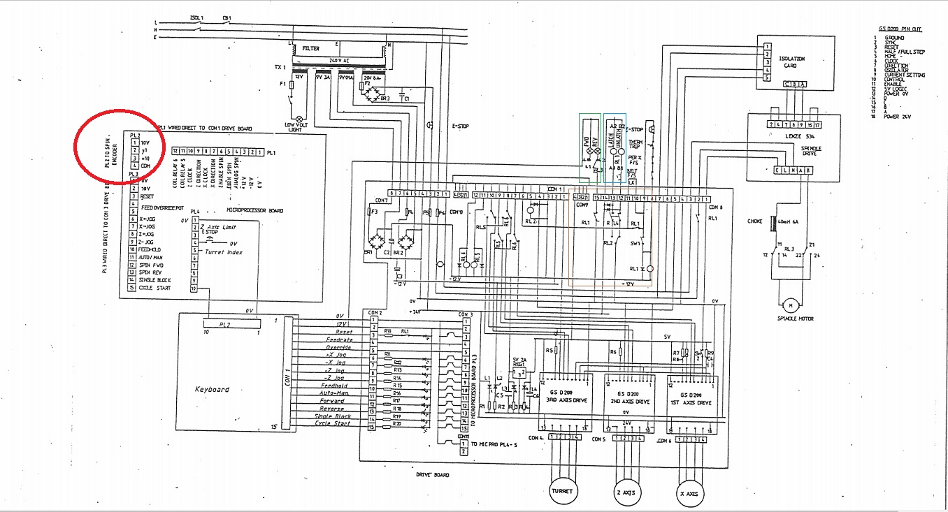

    Just seemed to stop working for no visible reason. No DC to motor at all
Name:	TCL circuit 1.jpg
    Ignore the red circle here, the culprit stuff is at the RHS of the circuit
    Mains supplies into it seem sound at 245 v on my cheap multimeter.
    Analog voltage input correct . But motor will just not start. (have tried a seperate input from rheostat which I have used to test before and still no go)
    Have tried on both linux cnc , and also on Mach 3 (on seperate computers) and still no Joy
    Transformer on iso board gives 2 x 120v outputs but nothing at all at outputs A,B,C, at the other end of the board, and of course all the electronics are totally beyond me.
    Any ideas please anyone ??

    Are you saying there is no 0 to 10volts coming out of the isolation board which is attached to the end of the lenze controller ?
    If so disconnect the isolation board to the lenze controller and connect your test potentiometer directly to the lenze controller
    The spec for the lenze controller is on line a google search finds its instantly
    For testing purposes you can use a 3 volt cell to feed an input into the lenze
    Also note that there is a pair of terminals which must be bridged together to allow the lenze to work
    I used these to connect to the relay on my BoB to turn the spindle on/off and then the voltage from the battery will set a speed or alternative to the battery is the potentiometer
    Just be careful as the terminals for the potentiometer are floating at around 110volts at speeds zero to 120 volts at full speed
    This is the purpose of the isolation board to but a isolated ‘bridge’ between the BOB and the lenses controllers high voltage
    On my boxford vmc190 the lenze was perfect but the isolation board was toast
    I used a diycnc.com board to provide the isolation between the lenze and the BoB
    Paul
