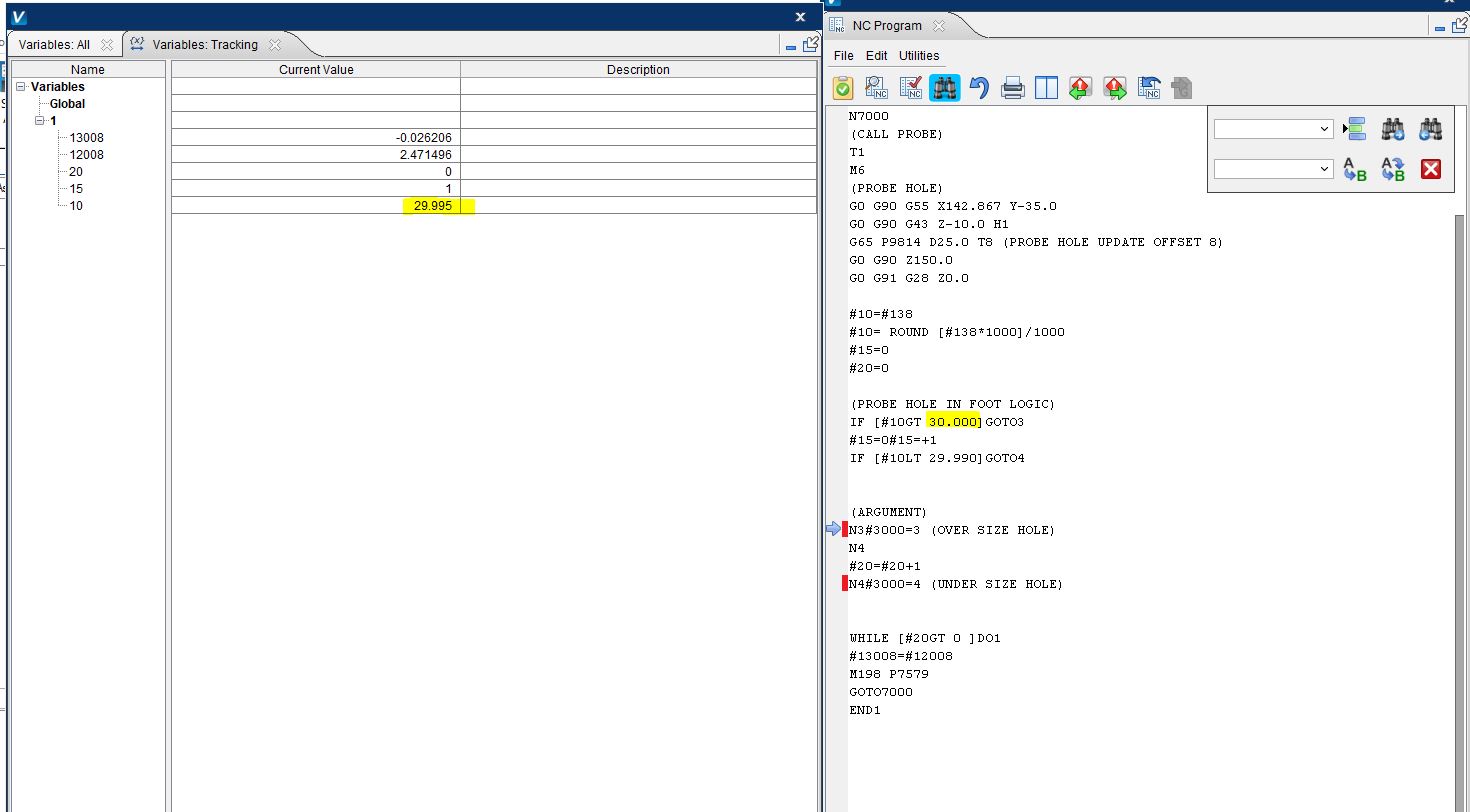

    Hi Guys,
    I new to macro b and am trying to learn it. Apart from Peter Smid books, I cannot find anything else half decent to read.
    I set my self a project where I want to
    1). machine a hole
    2). probe the hole and update the offset
    3). then re-machine hole to size
    4). then check with probe
    5). give the user a message of good or bad on machine
    I'm sure I have seen a cycle that does this but id like to write a macro. to help me learn the logic
    Also, why is the logic saying it is oversize when its 5 microns smaller?
    I have attached a screenshot.
    Thanks to anyone who can help me understand this
