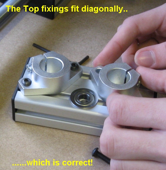

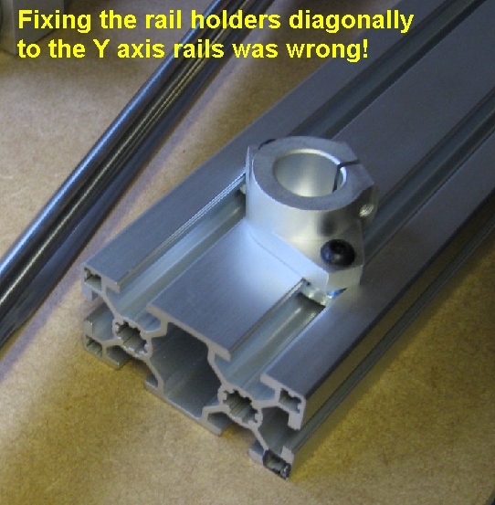

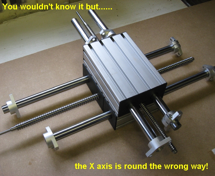

    Without any reference material, it's therefore a case of looking at the parts, placing them together, more looking at parts, no idea which part to start with, bolting a couple of parts together only to realise its back to front and you have to undo it and start again. the sequence is probably 2nd nature to those in the know but not for a first timer.

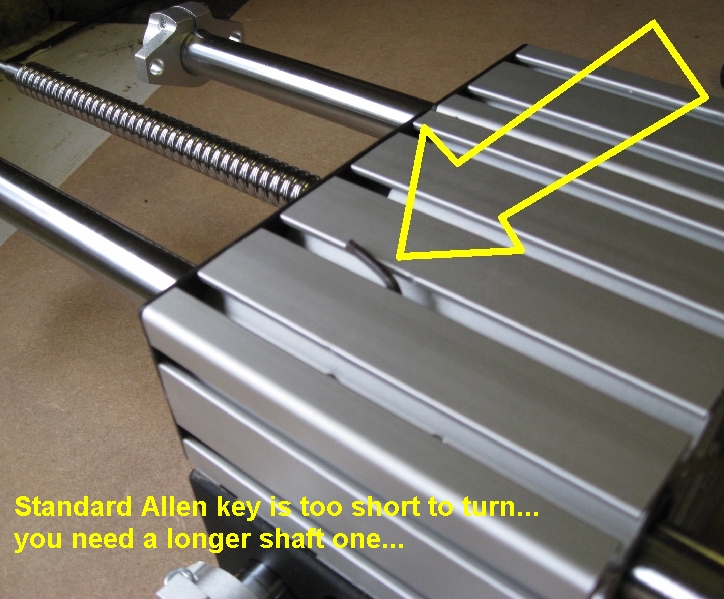

    Now I pride myself on having a excellent tool selection sockets, spanners, drivers, allen keys etc etc, however,the next 'problem' was discovering you need a longer allen key than standard to put two deep box aluminium sections together. so a quick trip to the hardware store to buy one for 45p and £1.00 to park!
    Once again you can buy flat pack furniture for hundreds of pounds and have single use allen keys and spanners to put together your purchase, it's the little things like this which makes it a better experience. unfortunately going out to buy one allen key just made me more p***** off! for the price I paid this is something which could have easily been included.

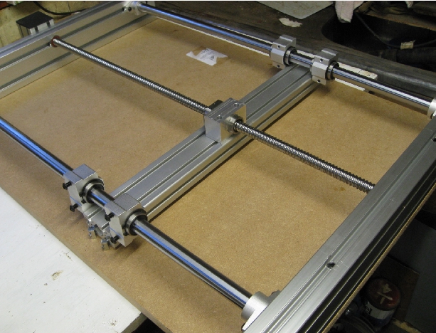

    That a side, after a couple of false starts, it started to come together. my 15yr old helped i.e I told him to tighten the screws 'here' and 'there' and we made fair progress through the sequence.

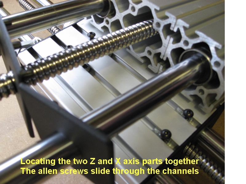

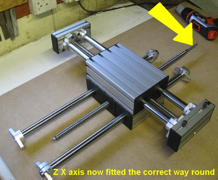

    To be fair there are only two complete parts to build: the lower Y axis and the upper x,z axis parts.
    i quess they can be built in any order and then you just bolt the two sections together. I started with the x, z axis parts, then put them to one side whilst i built the y axis base. when It came to putting the two together, you realise how heavy and awkward its all become, turning it on its side to locate screws etc then came the next problem, there were no special nuts to join the two parts together. I checked the packaging several times, I wrongly assumed they were a sort of nyloc nut, once again a check list would have identified their abscense and an exploded diagram would have shed the light on the fact they were of a special shape and design.
    I had to wait a week for the 'missing parts' to arrive before I could bolt the two parts together......

    On the allen ket front may I sugest that you invest in some T-handle keys, they will come in very handy.

    I have a one of Kevin unit (mine it is the same like that YouTube link) and what I can tell you is you mad a BIG mistake buying that. I know it is too late... You will find many things will go wrong and also you will find you need to make your own modification to have a working machine.
    To start check:
    - assembly ball screw housing Y axis.
    On mine I found a piece of plastic which it is supposed to work like a nut fixing. After I put all and try to tune machine with Mach that piece came out and Y ball screw was unusable. Speak with Kevin and replacement (I don't know why he didn't put that initially) came next day.
    - the end of X ball screw has a screw which supposed to line up the ball screw in bearing
    Try not to move the machine to the end of ball screw movement. If you do that that screw will came off and you will need to dismantle entire X axis to fix that. A "quick" fix is to install limit switch on all axis.
    - Z axis has the same problems. Do not run the axis till the end of movement linear bearings will be affected.
    On mine I found the Z axis with a Proxxon spindle don't reach the surface and I need to "lift up" the T-slot table with some 20 mm aluminium profile's and proper bolts.
    About the support - that it is almost NIL. That guy (Kevin) take your money and after that you are on your own. If you have a problem you must send the unit for fixing and you need to pay for shipping and everything.
    I don't know if he don't know much about how this machine must be made it (in all stages - design - stress (with Algor or something else) - manufacturing) or he doesn’t care about that.
    Anyway if you still have the original packaging box I suggest to send that back for a full refund. Make sure you secure very good what it is inside and pay insurance for package.
    I don't have anything with that company but I am an unsatisfied customer which pay a lot of money (with all 1700 GBP mechanical parts only since I have all electronics parts) and still must work and spend more money to have a working machine. I also want to advise people to pay attention when they spend money on this junk.
