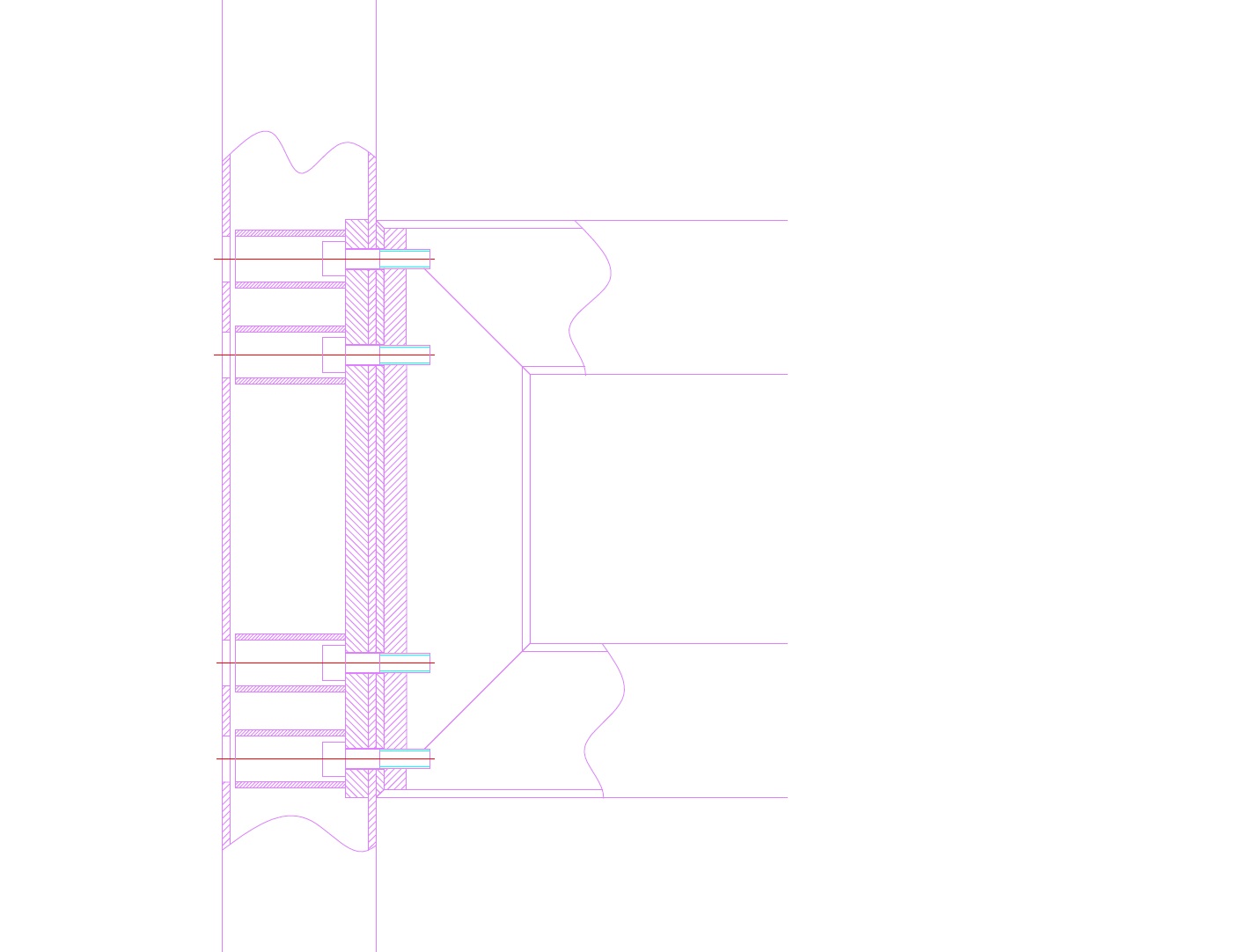

  11. #10
Name:	Frame connection.jpg
    the sides of the frame are welded symmetrically in a plane to reduce post-deformation. bolted together with hardened screws
