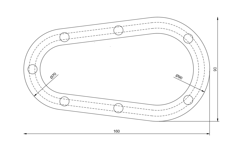

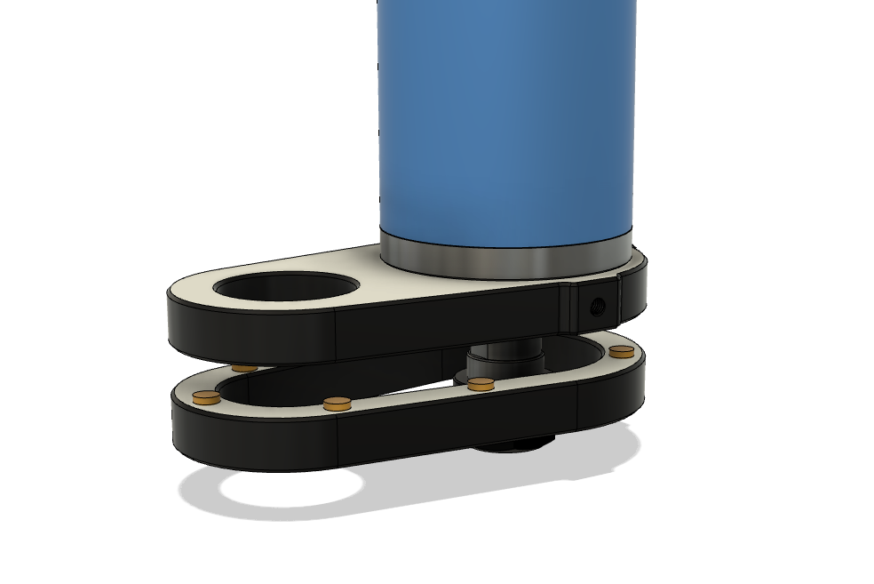

    I'll include some pics of the fusion 360 model for sizing and scale but it's a small 2 part dust boot with about a 4-5mm thick layer of bristles glued into a channel on the underside. The drawings won't show the bristles in situ but it's too cold and late for me to go in and take a pic of the actual dust boot at the minute.

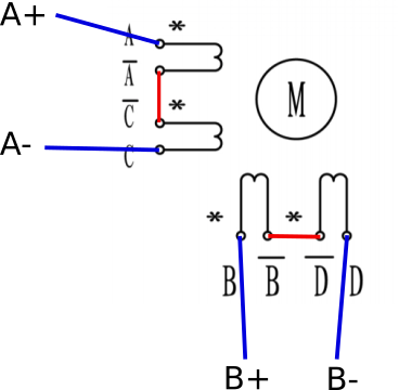

    Ok, this bit is a little confusing.? Are you saying the motors only have 4 wires or it's got 8 wires and your only using 4 of them.?
    The motors have 8 wires but only 4 are in use, the other wires are soldered together in their respective pairs. I'll include a sketch but i think the A+A-/B+B- polarities in the sketch might be different as I can't see the motors at the minute.
Name:	rough idea - wiring.png
    If it's an 8 wire motor then you have it wired wrong which would explain all your problems, in fact, if I'm correct then I'm surprised it even works.

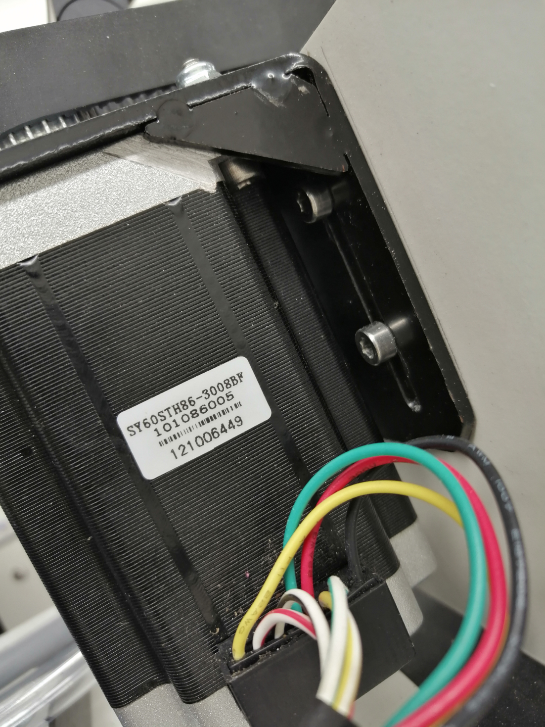

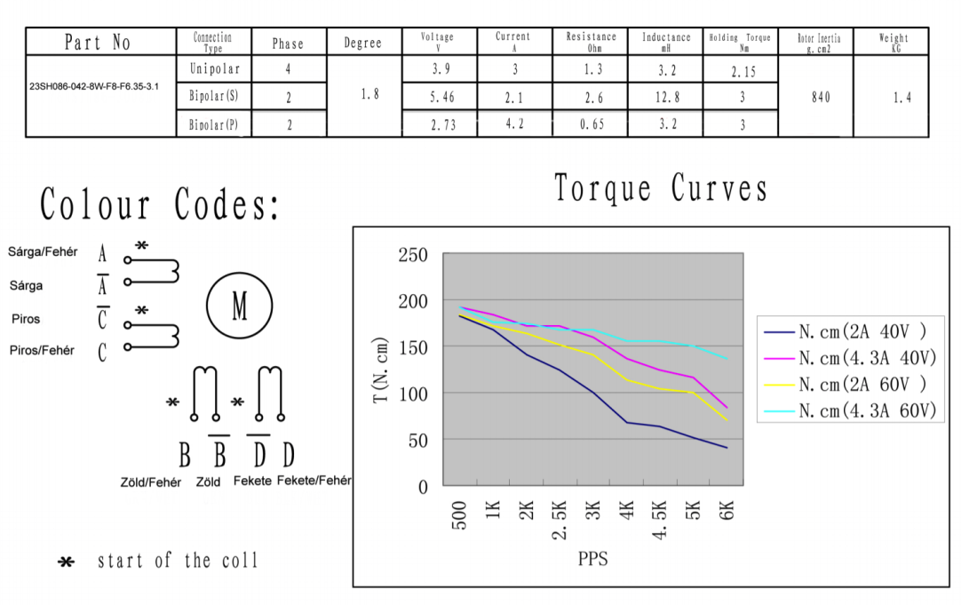

    Here's the motor pic and what I think is the closest match to the spec sheet for them, the colours are in Hungarian but i translated them manually and they were the same colours. You can see in the pic that the white/coloured wires are paired together to get what you see in the sketch of the wiring.

    Like Neale says the best way to wire the coils for a router is in parallel. then you would set the current to 4.2a in protune. When setting current always use the peak value.
    So does the PeakCur box in ProTuner refer to the total amperage the driver supplies to each coil or to the motor? If a spec sheet says 2.5A or 4.0A per phase do I double that figure in ProTuner's PeakCur box? This is what I find hard to understand, If Leadshine stated that the figure was for each phase or if it was for each motor in total it would make it much less confusing.

    I'm running 4x AM882 drivers with a 68v/500W PSU (Leadshine) to 4x SYS80STH86 - 3008BF currently wired in series. As for vel/acc I'm running OK at 6000mm/min with 1200mm/s2 without stalling.
    Thanks again chaps, I can see my soldering station coming out again soon but before I do that will I need another 68v linear power supply to deal with the extra amps required for parallel? I read many posts from those that went from series to parallel and have had better results but it was either laziness or amperage concerns that pointed me to wire them in series.

    Your current/voltage sums are correct - power = volts x amps - but in this case, because the loads are pulses, of varying levels, and don't happen at the same time on all motors, then the average is lower than the sums suggest. In addition, using a linear PSU is a great idea as it is able to cope with short duration peak pulse overloads with ease, as long as the average load stays within spec. Translation - you can safely get away with it! Switch-mode supplies are cheaper, smaller, and lighter but do not like even very short duration overloads and go rapidly into sulk mode.
    In your wiring diagram, connect A to C, -A to -C (can't replicate the exact terms in your diagram but I'm sure you can see what I mean), and then A/C to A+ on the driver, -A/-C to A- on the driver. Ditto for B&D. I think you know that you only then need four wires back to the driver.

    Your motors are Nema 34 so running them in parallel becomes even more important for a router. Large motors like these have a higher inductance than smaller NEMA 23 motors which means you require more volts to get the same rpm. Torque drops away much sooner up the curve with NEMA 34's so if you have them wired in series this compounds this even more which is why higher volts are needed to get high speeds out of nema34s.
    What does bother me and makes me wonder if you have an issue is that while they won't spin fast when wired in series they shouldn't easily stall at lower RPM and no way should a few bristles from a dust shoe cause missed steps.? A series wired NEMA 34 with 68V should rip that dust shoe off the machine and not even know it's done it.!
    If you wire the motors in parallel and set the current to 4.2a then with 68Vdc you should expect to get approx 900 to 1100rpm before torque starts to drop away at any significant rate. So if you have a 5mm pitch and are getting 6000mm/min without stalling then your about right, but if you have a 10mm pitch then you should be seeing roughly double that.!
    Quote Originally Posted by PaulP View Post
    The setting is per phase so just set protune to the spec sheet per phase rating ie: 4.2a
