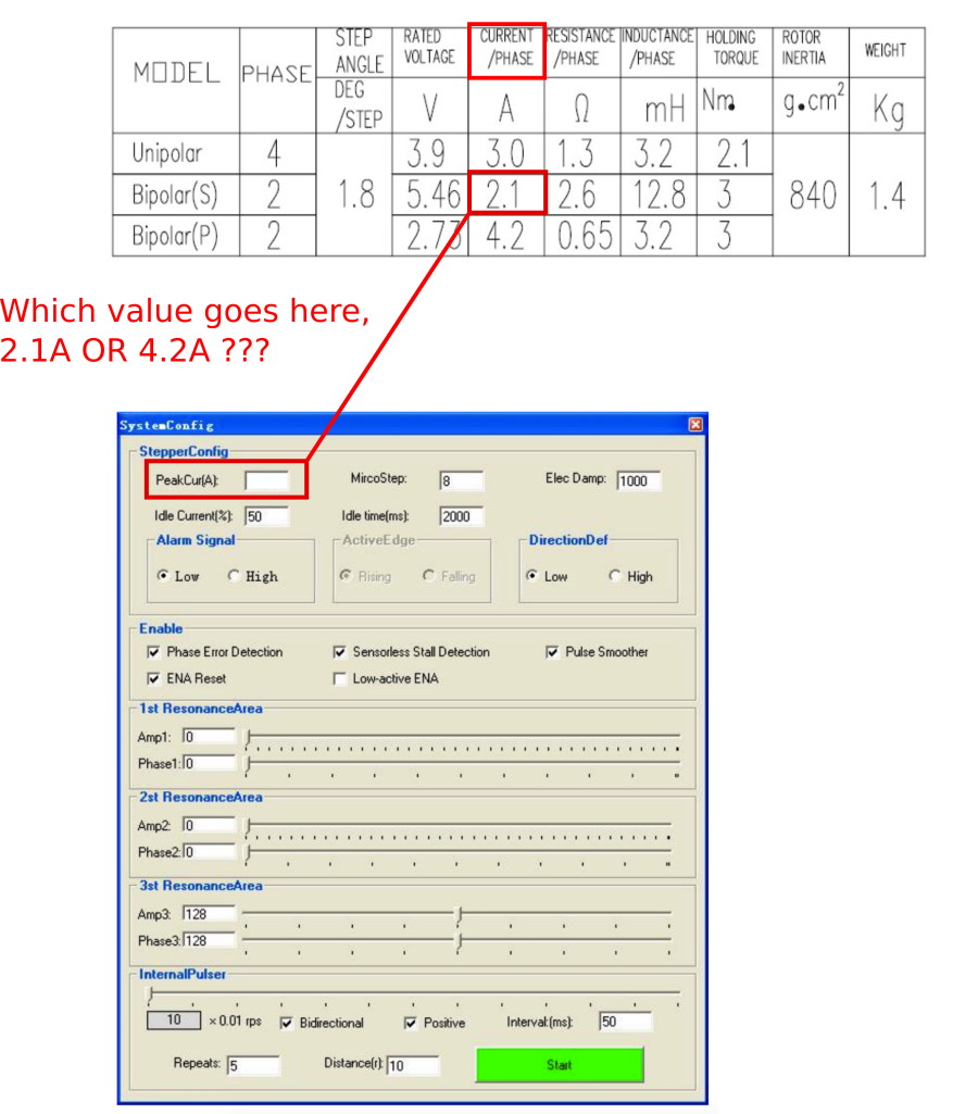

    I'm using Leadshine's AM882 drivers on 3N.m steppers and am at the point of tuning them all up using Leadshine's ProTuner Software. What I can't understand is the current/phase is stated at 2.1A but can't for the life of me work out if the amp setting in ProTuner is asking me to put in the value per phase or the total value required by both phases combined. I'm running these drivers/steppers at 68v.
    I'd be grateful to find out.
    This only came to light this evening as it looks like my machine lost some steps somewhere tonight. I've been running the machine without my new dust boot and everything comes out to within 0.05mm but I added my self made dust boot with fairly rigid bristles (rigid compared to a soft paintbrush) to run a program and it definitely caused some loss of position. I suspect the bristles may be causing the issue but at present my drives are set to 2.1A in ProTuner. If it's a lack of amps going to the motors then I can up the amperage but if 2.1A is the correct value to use then I'll have to make a new softer bristle plate for the dust boot. I should mention that I ran the program 4 times, twice with the dust boot on and had geometric errors in the same places then twice without the dust boot both of these were perfect but I was caked in Trespa dust, which I really hate.
    Thanks for reading this I really like to know what the score is with this because I can't stand being next to the machine with a hoover hose trying to catch all the dust/chips flying out.
    Here's what I mean as an illustration....

    I'm fairly confident in saying that currents are always specified per phase where steppers are concerned.
    Cheers for the info Kitwn,
    The boot is defo causing the shift, it's repeatedly working fine on this part without it and on other parts without it but with it on it was squashed right down and catching edges, plus if my steppers are 'under amped' by 50% it wouldn't surprise me to fail in the same 2 spots. It'll be easier to re-tune (up the amps) the steppers than it will be to make a new bristle skirt, but only if it's the under-amped issue causing the problem. The boot assembly weighs about 400g so no real weight on the system.
    My main concern before looking into the bristle issue is the amps being fed to the steppers. I sense they are too low, it's a dual screw axis on X and a single on the Y both use 5mm pitch screws. Before I changed the "PeakCur(A)" value in ProTuner from 4A to 2A it could do 5mm cuts with a 1/4in 2 fluted cutter, now it struggles and sometimes triggers the stall/estop when doing 3mm passes in Trespa (HPL).
    The problem was that the motors were getting almost too hot to touch and I wasn't sure if the PeakCur(A) was too high and would burn the motors out. So I lowered it a while back to 2A but now I noticed some missed steps I'm wondering if it should be set to the 2.1A or the 4.2A.
    I get that the currents are always specified per phase on motor specs but what about in ProTuner? Does ProTuner's "PeakCur(A)" refer to the current for each phase or to an individual phase?
    Currently I'm set on 2A but am wondering if I should really have set the value in ProTuner to 4.2A, or at least to somewhere closer to 4.2A like 3.8A.
    Just for the record I'm running all stepper in series configurations, ie 4 wires.

    "Almost too hot to touch" is about right for steppers! Particularly if you also use the "half current when stationary" setting, I wouldn't worry too much.
    Current sounds low - I think I run my 3Nm steppers at about 3.something amps on the "crank it up until you can't rest your hand on them then wind it back a bit" basis.
    Bit worried that you say you are using a series configuration. For best torque, parallel wiring is advised. As long as your PSU can take it (can supply enough current) parallel beats series hands down.

    Like Neal has said if they are 8 wire steppers then I would use them in a parallel configuration as you will get more torque.
    I run AM882 drive on my router at 3. something A with twin screws and 68V PS. Steppers are happy at 60'C and above.

    Ok, this bit is a little confusing.? Are you saying the motors only have 4 wires or it's got 8 wires and your only using 4 of them.?
    If it's an 8 wire motor then you have it wired wrong which would explain all your problems, in fact, if I'm correct then I'm surprised it even works.
    For series or parallel, you still use all 8 wires but connected in a different order. If it's a 4 wire motor then you don't have the option to wire parallel or series because that is already determined by the factory.
    Often 4 wire motors are series-wound but you can get them parallel wound but would need to ask the manufacturer to know for sure.
    The problem with Series wound motors is that you need twice the amount of volts to get the same speed/torque as a parallel wound motor. For a Mill, series-wound is a good choice because higher torque is produced at lower RPM but it quickly drops away as the RPM rise which isn't good for a router. So if you do have series-wound motors then it's highly likely you don't have enough volts which is why torque is dropping away as the RPM's rise and your getting missed steps
    Like Neale says the best way to wire the coils for a router is in parallel. then you would set the current to 4.2a in protune. When setting current always use the peak value.
    Whta voltage are you running and what velocity and Acc do you have them tuned at.?

    OK lots of food for thought given here, thanks in advance for this help...
    Originally they were set to 4A in ProTuner but I could have fried eggs on them as they were almost too hot to touch. I started to worry a bit which is why I reduced the PeakCur to 2A. At 2A they don't get hot which I thought was better but I now think that might be wrong.
    I've been debating whether or not to switch to parallel as it seems to be what everyone is doing with their routers. I got lazy doing the electronics as I started to get fed up so ended up setting each motor in series. I was mistaken at the time because for some reason I imagined all 8 wires on the motor had to go all the way back to the driver, ie using an 8 core 1.5mm2 cy cable. Each of my motors has a plug with 4 connections going to their respective A+A-/B+B- socket coming from the driver. To go parallel I assume I solder the respective 'spare' wires together on the motor plug. Is that correct?
    As for the PSU it's a Leadshine 68v 500W linear PSU from Zapp. Since my machine has 4 motors in total if I changed the wiring to parallel would I need another PSU as I thought 500w/68v = 7.35A and if 2 motors in parallel are set to 3.5A each then my single PSU stated above would only be supplying enough for 2 motors. I'll get another 68v 500w PSU if needs be but wanted to check before shelling out again.

    The motors have 8 wires but only 4 are in use, the other wires are soldered together in their respective pairs. I'll include a sketch but i think the A+A-/B+B- polarities in the sketch might be different as I can't see the motors at the minute.
    So does the PeakCur box in ProTuner refer to the total amperage the driver supplies to each coil or to the motor? If a spec sheet says 2.5A or 4.0A per phase do I double that figure in ProTuner's PeakCur box? This is what I find hard to understand, If Leadshine stated that the figure was for each phase or if it was for each motor in total it would make it much less confusing.
    What voltage are you running and what velocity and Acc do you have them tuned at.?
    I'm running 4x AM882 drivers with a 68v/500W PSU (Leadshine) to 4x SYS80STH86 - 3008BF currently wired in series. As for vel/acc I'm running OK at 6000mm/min with 1200mm/s2 without stalling.

    Ditto - although the transformer did go pop one day! But that seems to have been some random internal short as before that time it never even got warm. Those current figures are, to be honest, a bit vague. They don't really correspond with anything very much and in practice the load the drivers and motors put on the power supply is much less than your sums suggest. Hence my comments about motor temperature - for most practical purposes it's as good a guide as any! If you can hold the motor in your hand without it being too hot, then it's no more than 60C and that's fine for a stepper. It's what they do!
    Your current/voltage sums are correct - power = volts x amps - but in this case, because the loads are pulses, of varying levels, and don't happen at the same time on all motors, then the average is lower than the sums suggest. In addition, using a linear PSU is a great idea as it is able to cope with short duration peak pulse overloads with ease, as long as the average load stays within spec. Translation - you can safely get away with it! Switch-mode supplies are cheaper, smaller, and lighter but do not like even very short duration overloads and go rapidly into sulk mode.
    In your wiring diagram, connect A to C, -A to -C (can't replicate the exact terms in your diagram but I'm sure you can see what I mean), and then A/C to A+ on the driver, -A/-C to A- on the driver. Ditto for B&D. I think you know that you only then need four wires back to the driver.
