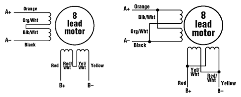

    Bit worried that you say you are using a series configuration. For best torque, parallel wiring is advised. As long as your PSU can take it (can supply enough current) parallel beats series hands down.

    Like Neal has said if they are 8 wire steppers then I would use them in a parallel configuration as you will get more torque.

    Ok, this bit is a little confusing.? Are you saying the motors only have 4 wires or it's got 8 wires and your only using 4 of them.?
    If it's an 8 wire motor then you have it wired wrong which would explain all your problems, in fact, if I'm correct then I'm surprised it even works.
    For series or parallel, you still use all 8 wires but connected in a different order. If it's a 4 wire motor then you don't have the option to wire parallel or series because that is already determined by the factory.
    Often 4 wire motors are series-wound but you can get them parallel wound but would need to ask the manufacturer to know for sure.
    The problem with Series wound motors is that you need twice the amount of volts to get the same speed/torque as a parallel wound motor. For a Mill, series-wound is a good choice because higher torque is produced at lower RPM but it quickly drops away as the RPM rise which isn't good for a router. So if you do have series-wound motors then it's highly likely you don't have enough volts which is why torque is dropping away as the RPM's rise and your getting missed steps
    Like Neale says the best way to wire the coils for a router is in parallel. then you would set the current to 4.2a in protune. When setting current always use the peak value.
    I've been debating whether or not to switch to parallel as it seems to be what everyone is doing with their routers. I got lazy doing the electronics as I started to get fed up so ended up setting each motor in series. I was mistaken at the time because for some reason I imagined all 8 wires on the motor had to go all the way back to the driver, ie using an 8 core 1.5mm2 cy cable. Each of my motors has a plug with 4 connections going to their respective A+A-/B+B- socket coming from the driver. To go parallel I assume I solder the respective 'spare' wires together on the motor plug. Is that correct?
    The motors have 8 wires but only 4 are in use, the other wires are soldered together in their respective pairs. I'll include a sketch but i think the A+A-/B+B- polarities in the sketch might be different as I can't see the motors at the minute.
    They do work but when I fire up their linear power supply you can hear a very slight whistling sound, it's high pitch and really annoying to be honest, when they drivers get the ENA high signal they switch off and go quiet. These motors were bought from zapp some years ago but I can't find them on zapp now so am unable to confirm the drawing is defo for this motor. The motors are labelled as SYS80STH86 - 3008BF. Do you hear any sounds from your AM882 powered motors when they are idle?
    So does the PeakCur box in ProTuner refer to the total amperage the driver supplies to each coil or to the motor? If a spec sheet says 2.5A or 4.0A per phase do I double that figure in ProTuner's PeakCur box? This is what I find hard to understand, If Leadshine stated that the figure was for each phase or if it was for each motor in total it would make it much less confusing.

    In your wiring diagram, connect A to C, -A to -C (can't replicate the exact terms in your diagram but I'm sure you can see what I mean), and then A/C to A+ on the driver, -A/-C to A- on the driver. Ditto for B&D. I think you know that you only then need four wires back to the driver.
