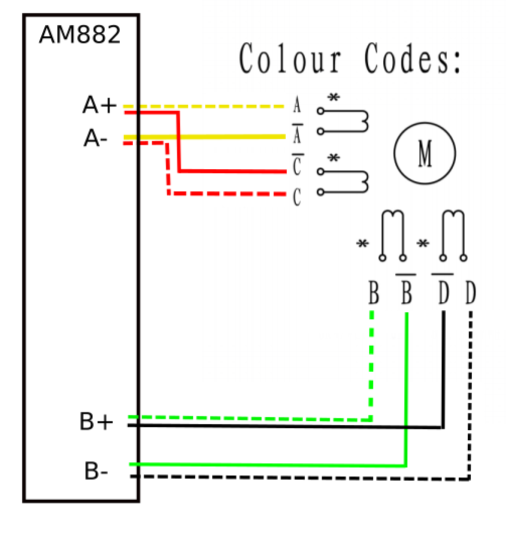

    My main concern before looking into the bristle issue is the amps being fed to the steppers. I sense they are too low, it's a dual screw axis on X and a single on the Y both use 5mm pitch screws. Before I changed the "PeakCur(A)" value in ProTuner from 4A to 2A it could do 5mm cuts with a 1/4in 2 fluted cutter, now it struggles and sometimes triggers the stall/estop when doing 3mm passes in Trespa (HPL).
    The problem was that the motors were getting almost too hot to touch and I wasn't sure if the PeakCur(A) was too high and would burn the motors out. So I lowered it a while back to 2A but now I noticed some missed steps I'm wondering if it should be set to the 2.1A or the 4.2A.
    I get that the currents are always specified per phase on motor specs but what about in ProTuner? Does ProTuner's "PeakCur(A)" refer to the current for each phase or to an individual phase?
    Currently I'm set on 2A but am wondering if I should really have set the value in ProTuner to 4.2A, or at least to somewhere closer to 4.2A like 3.8A.
    Just for the record I'm running all stepper in series configurations, ie 4 wires.

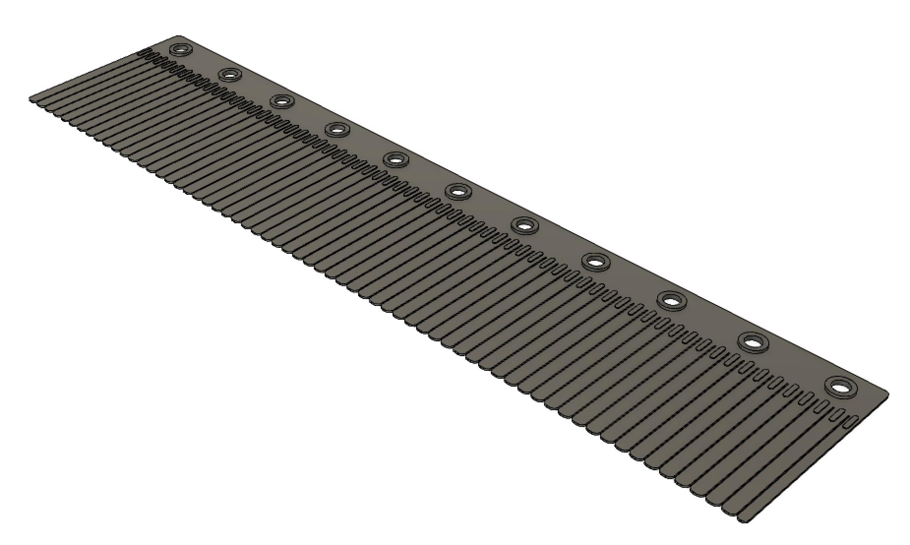

    I'll include some pics of the fusion 360 model for sizing and scale but it's a small 2 part dust boot with about a 4-5mm thick layer of bristles glued into a channel on the underside. The drawings won't show the bristles in situ but it's too cold and late for me to go in and take a pic of the actual dust boot at the minute.

    And if you are generating that much drag with the dust shoe, you need to do something about it! I've made mine adjustable by using a series of 1/2" or so plywood plates with small magnets glued in so I can easily adjust height to suit cutter length, etc. I managed to rip the bristle strip off mine recently due to a little accident and as a quick fix staple-gunned overlapping strips of plastic from an old milk bottle round the edge. Crude but effective! Strips are probably around 1.5" long to give flexibility when going over edges of work and so on.

    Ok, this bit is a little confusing.? Are you saying the motors only have 4 wires or it's got 8 wires and your only using 4 of them.?
    If it's an 8 wire motor then you have it wired wrong which would explain all your problems, in fact, if I'm correct then I'm surprised it even works.
    For series or parallel, you still use all 8 wires but connected in a different order. If it's a 4 wire motor then you don't have the option to wire parallel or series because that is already determined by the factory.
    Often 4 wire motors are series-wound but you can get them parallel wound but would need to ask the manufacturer to know for sure.
    The problem with Series wound motors is that you need twice the amount of volts to get the same speed/torque as a parallel wound motor. For a Mill, series-wound is a good choice because higher torque is produced at lower RPM but it quickly drops away as the RPM rise which isn't good for a router. So if you do have series-wound motors then it's highly likely you don't have enough volts which is why torque is dropping away as the RPM's rise and your getting missed steps
    Like Neale says the best way to wire the coils for a router is in parallel. then you would set the current to 4.2a in protune. When setting current always use the peak value.
    I like that milk bottle idea for skirting it defo beats the tedium of gluing bristles into a channel. I did see that video on youtube of some german chap making one but he used a small metal tube squashed at one end to help with the fiddlyness of the bristles. Similarly to the milk bottle idea I was thinking of drawing up and printing some strips on the 3d printer. Maybe 2 layers of 0.2mm with a rim with holes for securing it.

    The motors have 8 wires but only 4 are in use, the other wires are soldered together in their respective pairs. I'll include a sketch but i think the A+A-/B+B- polarities in the sketch might be different as I can't see the motors at the minute.
Name:	rough idea - wiring.png
    They do work but when I fire up their linear power supply you can hear a very slight whistling sound, it's high pitch and really annoying to be honest, when they drivers get the ENA high signal they switch off and go quiet. These motors were bought from zapp some years ago but I can't find them on zapp now so am unable to confirm the drawing is defo for this motor. The motors are labelled as SYS80STH86 - 3008BF. Do you hear any sounds from your AM882 powered motors when they are idle?
    So does the PeakCur box in ProTuner refer to the total amperage the driver supplies to each coil or to the motor? If a spec sheet says 2.5A or 4.0A per phase do I double that figure in ProTuner's PeakCur box? This is what I find hard to understand, If Leadshine stated that the figure was for each phase or if it was for each motor in total it would make it much less confusing.

    In your wiring diagram, connect A to C, -A to -C (can't replicate the exact terms in your diagram but I'm sure you can see what I mean), and then A/C to A+ on the driver, -A/-C to A- on the driver. Ditto for B&D. I think you know that you only then need four wires back to the driver.
    I did have a strip of draught excluder brush with long bristles for my dust shoe but it was a pain to make - getting the groove right was tricky with the balance between too tight/too loose and bending the strip to fit was just a bit fiddly. My cheap and cheerful solution works at least as well and costs nowt into the bargain! That's an engineering solution...
