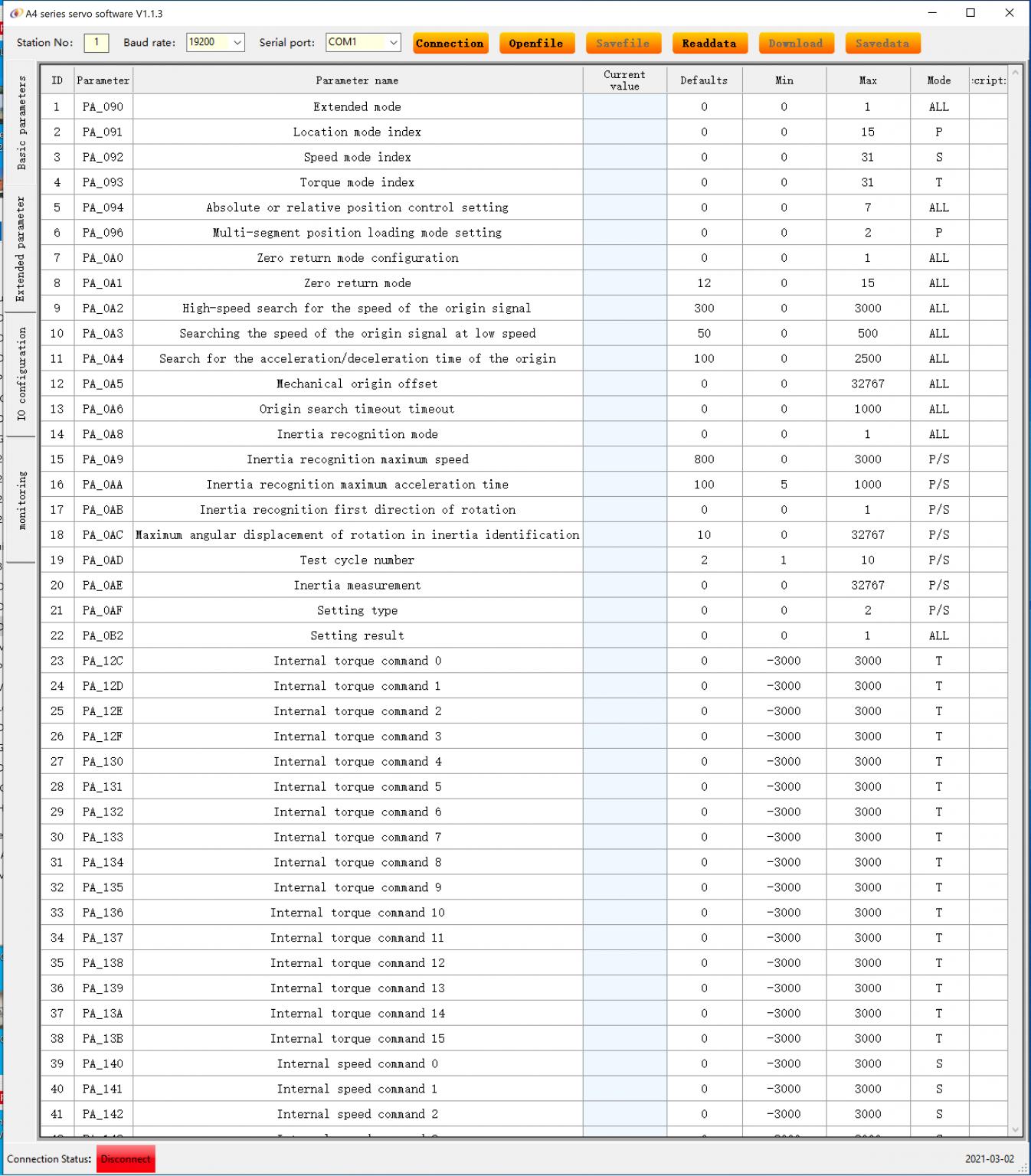

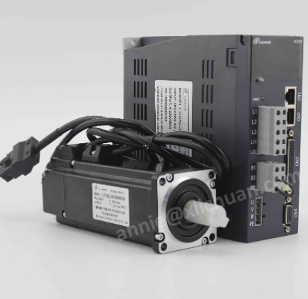

    Has anyone here got experience of tuning any of the AC Servos from China. I am considering getting some, specifically the Lichuan A4 type as per the pic below. I downloaded their software and eventually managed to get it loaded on an old XP computer (couldn't get to work on W10 even in compatibility) The software however looks to be just an easy means of setting parameters and there doesn't seem to be much in the way of tuning compatibility built in, in other words it is just a computerised method of enter parameters rather than using the drives buttons.
    I am a bit wary of buying the drives/motors in case they are a nightmare to tune.

    Aye, info is non existent on those Lichaun servos and the software is Chinese only as far as I can make out. I don't think there is any automatic tuning in them or at least I don't see any mention of it and if there was such a thing you would think it would be getting shouted about.

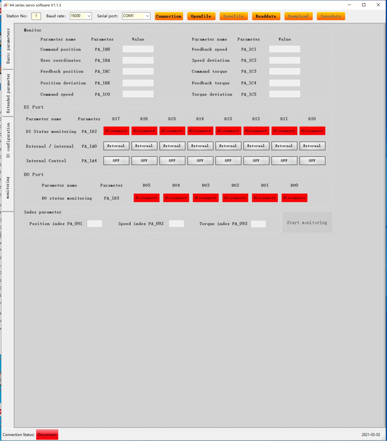

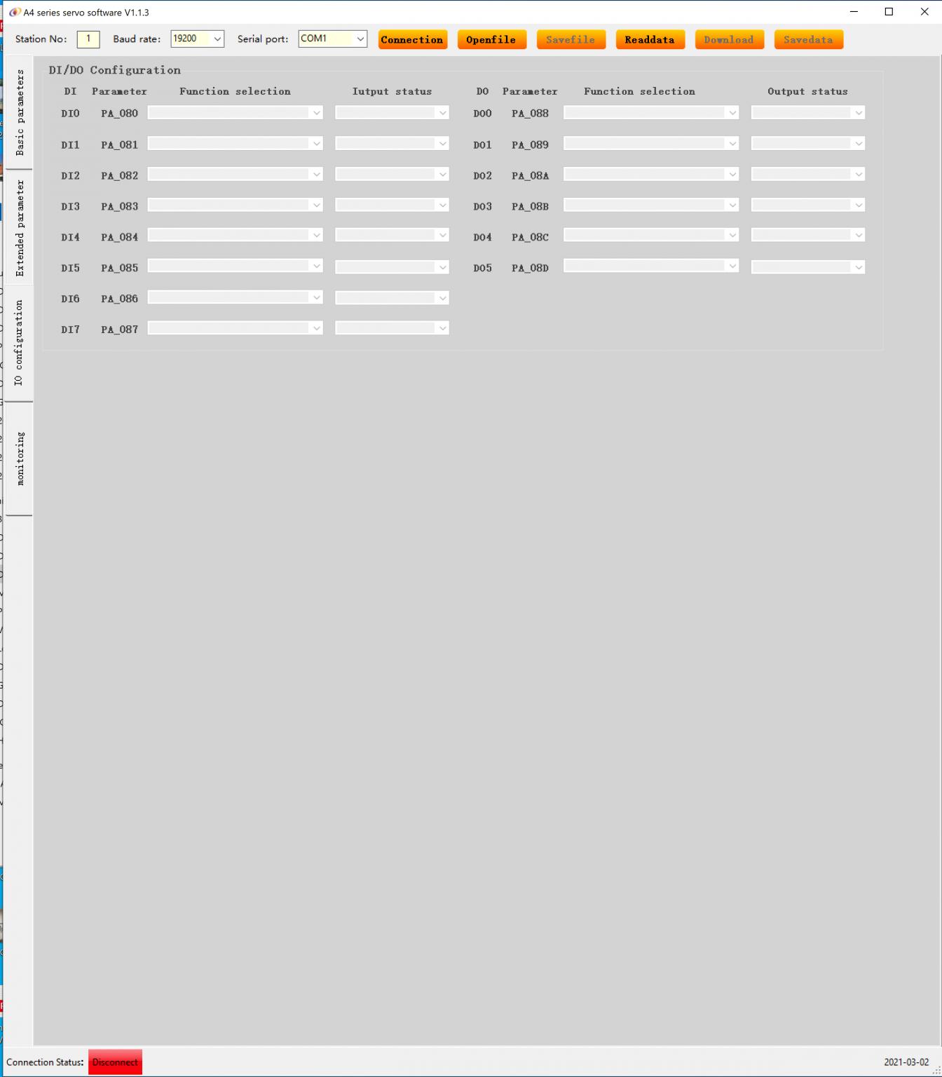

    i've been on with them and this is this what they sent me when i specifically asked about tuning. Is this what you found? It doesnt look too promising?
Name:	Screenshot 2021-03-02 at 10.34.07.jpg
Name:	Screenshot 2021-03-02 at 10.33.59.jpg
Name:	Screenshot 2021-03-02 at 10.33.52.jpg

    That is a bit better than I found because what I saw was all in Chinese 😁
