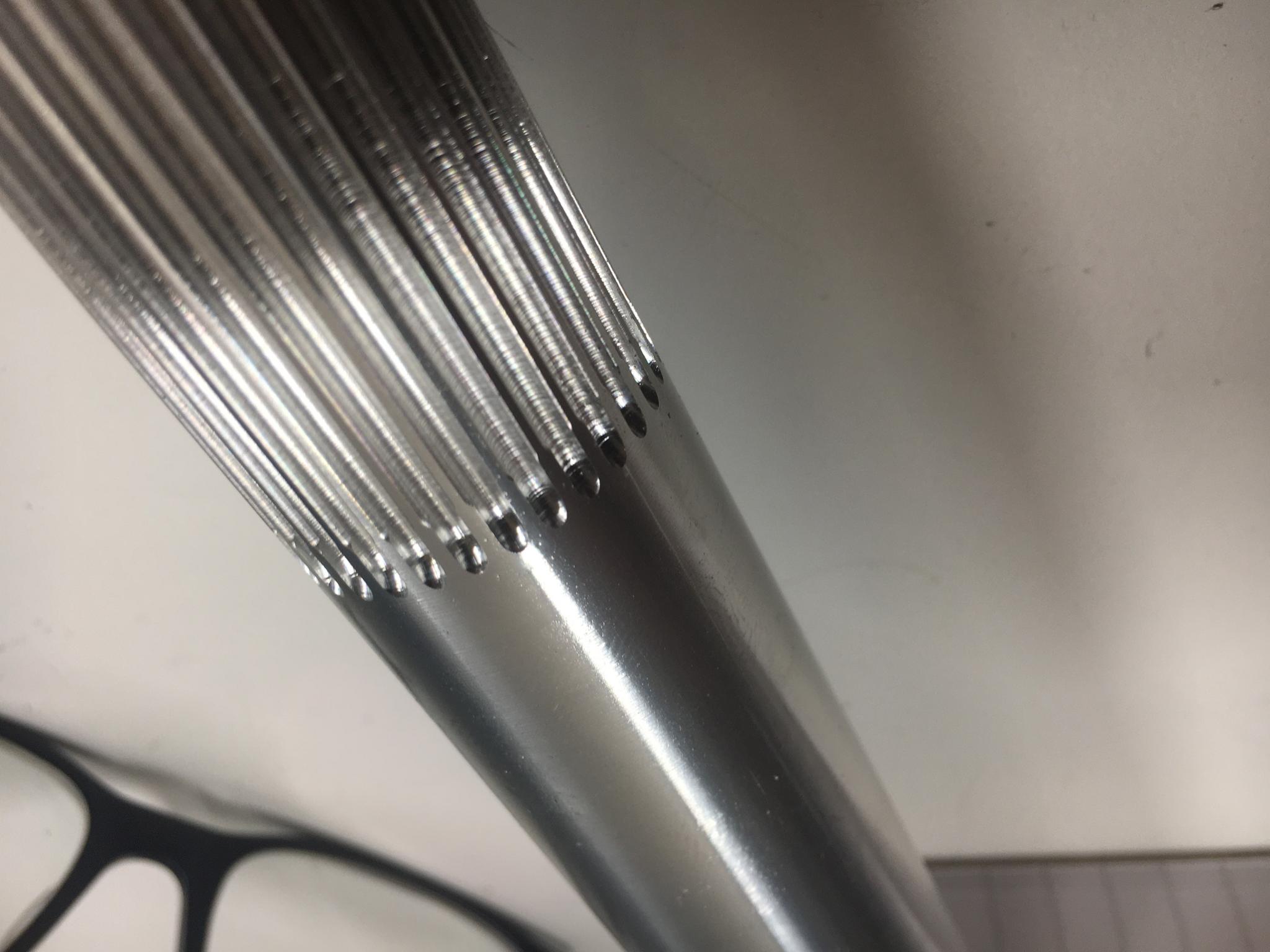

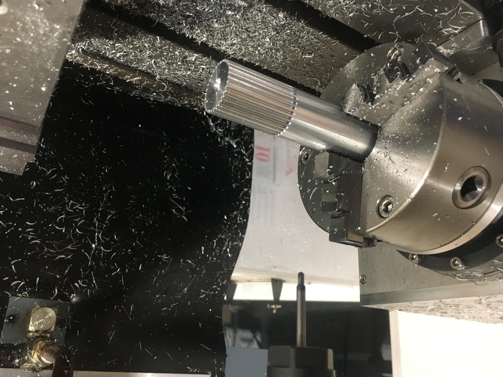

    I've just made my own HTD3 pulley due to the crap backlash in the Chinesium pulleystock used in the pulleys I got from Bearingboys. Wasn't planning on doing that but it seemed the only concrete solution, short of buying loads of random pulleys from various suppliers and hoping some were ok. Also gave me the opportunity to break out the 4th axis again. This uses a Yaskawa Sigma servo and motor.
    With an iPhone and Windows 10, this forum doesn't know which orientation to use on the photos, although they look OK in W10. Every forum seems to be different! What is the way to fix it here?
