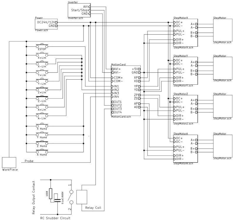

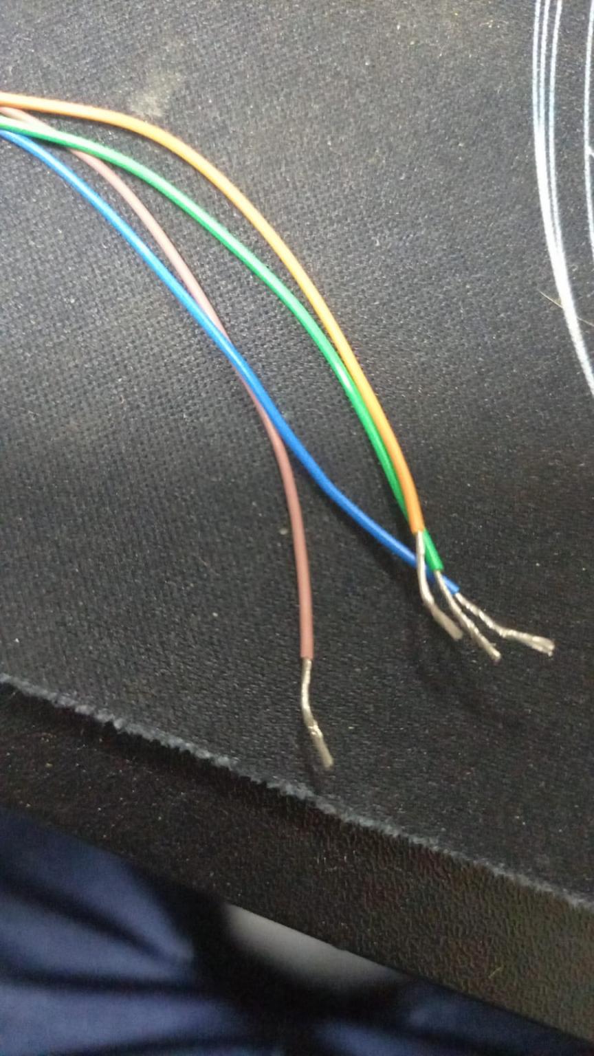

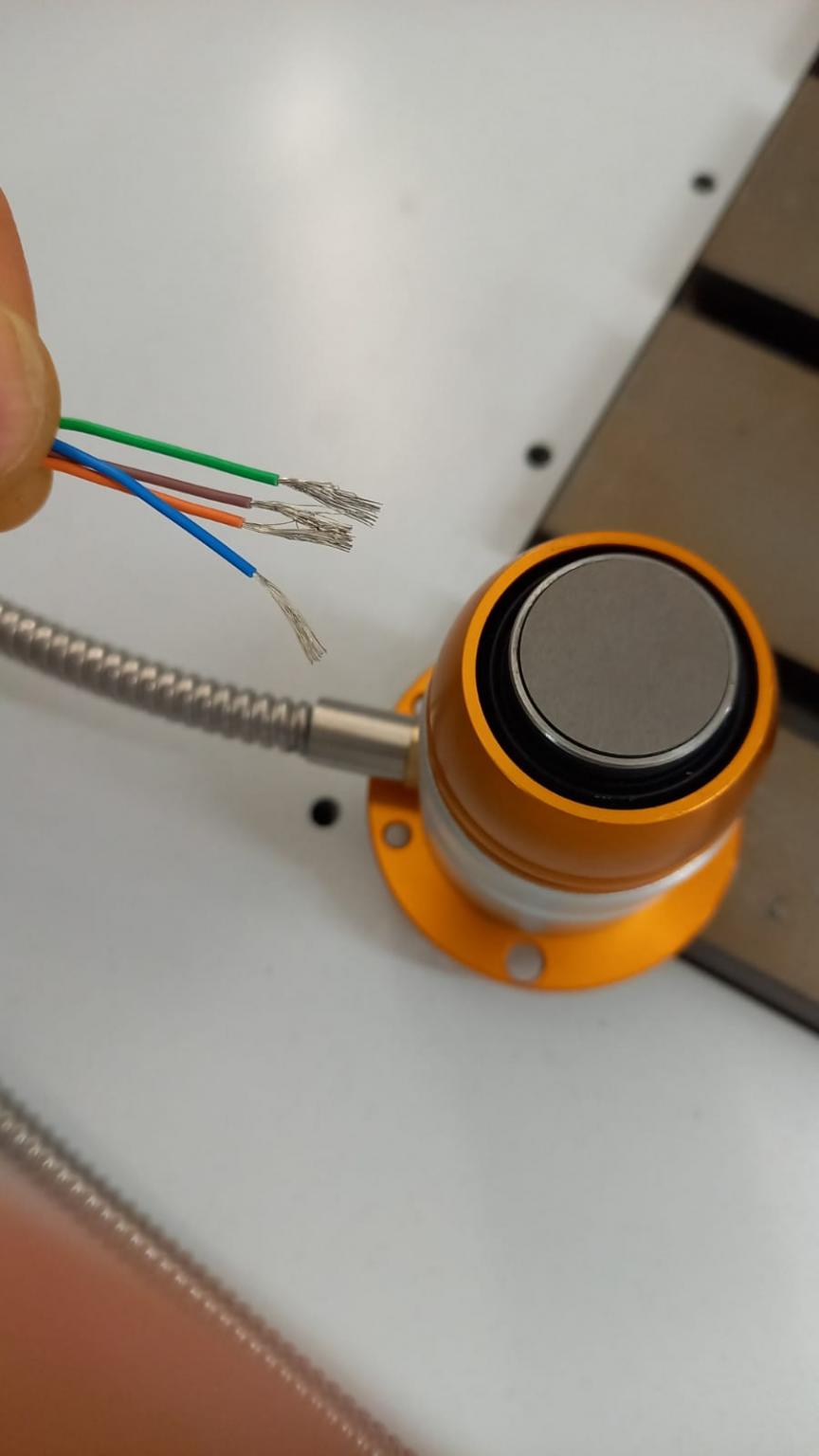

    I've purchased a Chinese Z axis toolsetter, the problem is that instructions are in Chinese and the diagram doesn't even indicate which cables are what. It has 4 cables brown, green, blue and orange, I want to plug it into the CNC board and set it up on Mach3. Anybody has experience this this kind of Z probes? The vendor doesn't even understand English so it's been pointless to ask them for instructions.
    I managed to decipher that one cable (don't know the colour) goes to IN2 and another goes to DCM (also don't know which colour)

    Also if you have a multi meter you can sort the wire out into pairs they could be 2 switches inside the top one for the tool setter and a further one lower down to wire into the e-stop chain .
    Or it could just you one switch and one pair of wire would be for the electronics.

    This scheme is the same as the one provided by the vendor I tried translating the whole document it on apps or google translate but it's not working . I'm asking a friend of mine who speaks Chinese to translate it for me, but basically it's a short paper that contains this scheme.

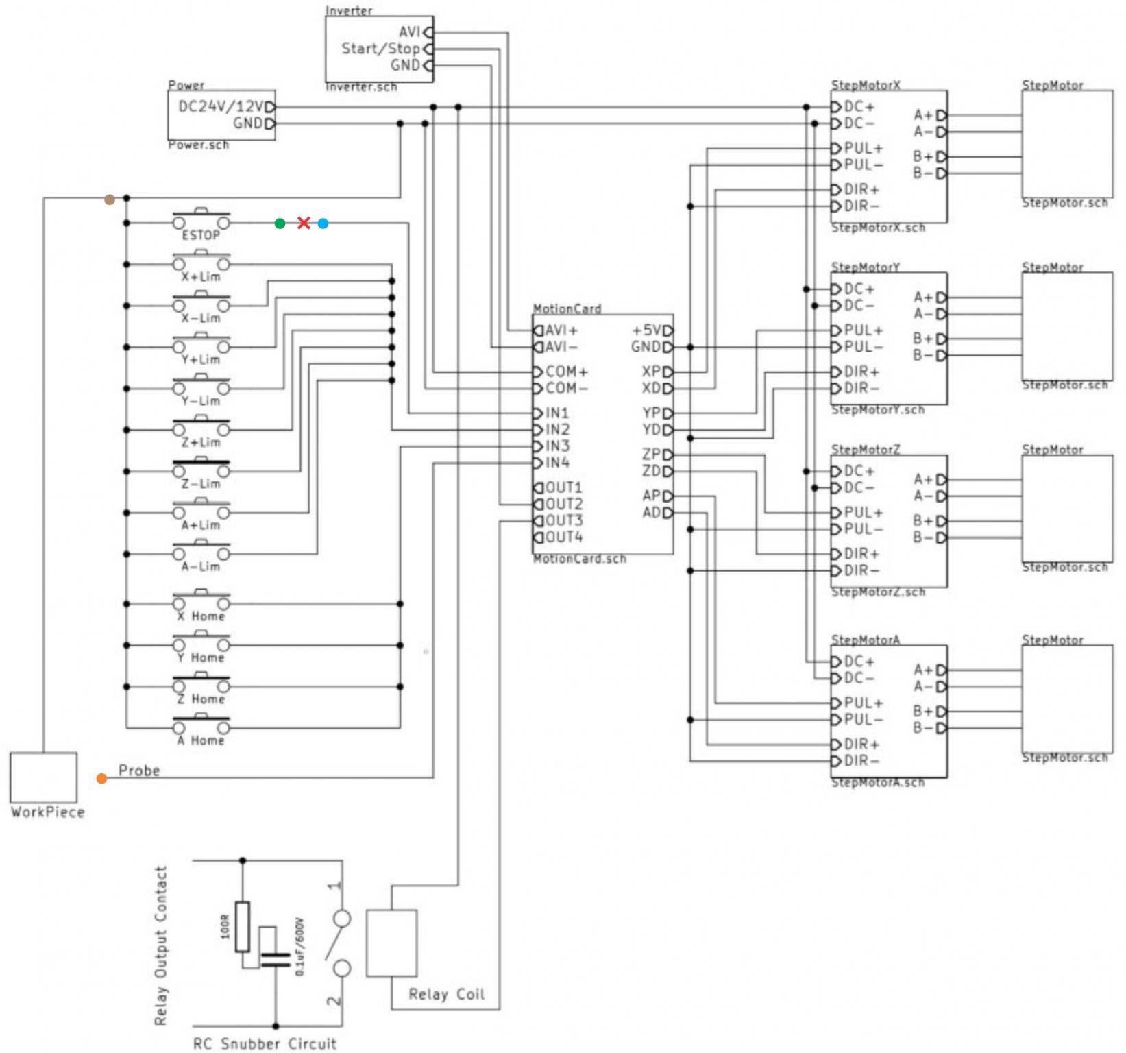

    According to the scheme that you attached, your Brown+Orange wires are for tool setter, Green+Blue should be connected in series with your E-stop switch.

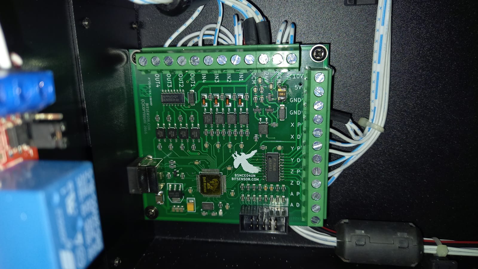

    I found the scheme for the control board, so based on this in which pins should I plug the cables?

    I have that exact tool setter. I have the orange and brown wires connected to ground and probe, and the blue and green connected to estop and earth
    Estop switch from the tool setter should be connected in SERIES with Estop switch in your system.
