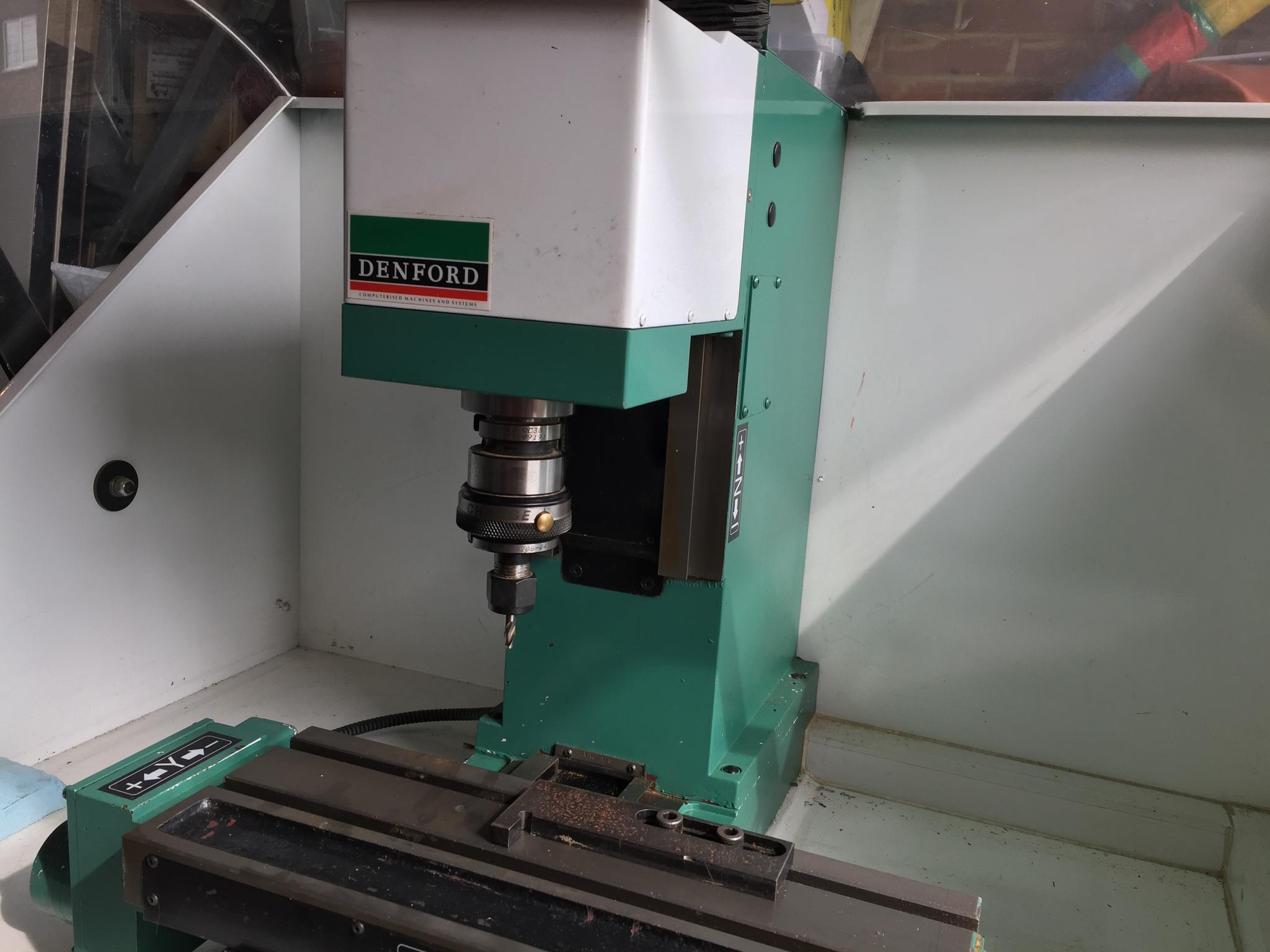

    I bought a denford novamill, it didn’t come with the control box so I decided to build my own control box and operator interface. This is my diary!

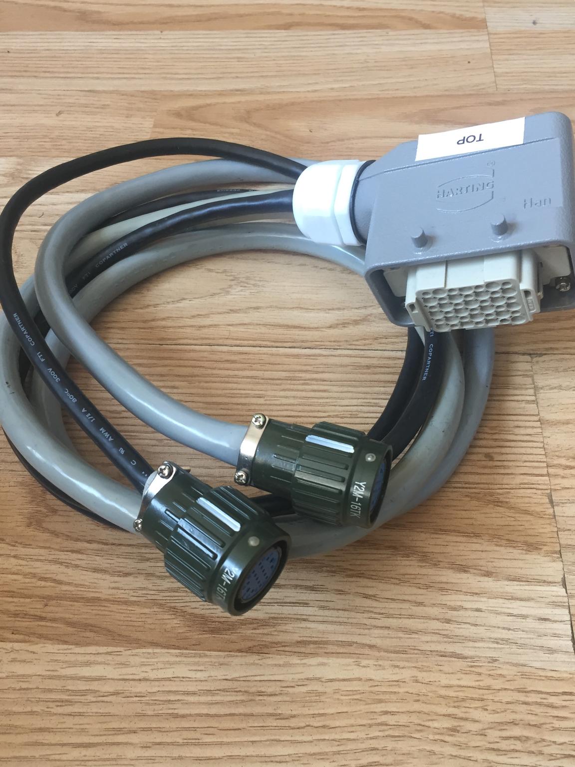

    I managed to source the correct connector for the machine made by harting and some industrial multi core cable and some screened cable witch I had left over from another project. http://www.mycncuk.com/threads/11102...=Emco+retrofit
    Using some aviation type connectors I made up a cable to provide power to the machine and receive limit switch signals from it.

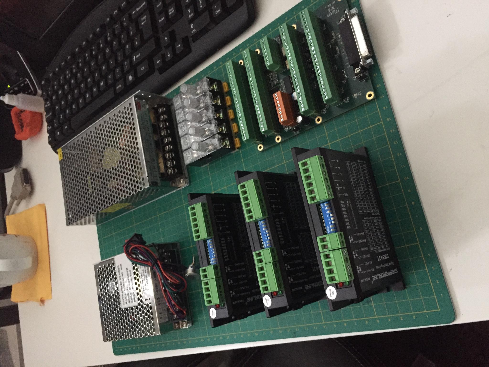

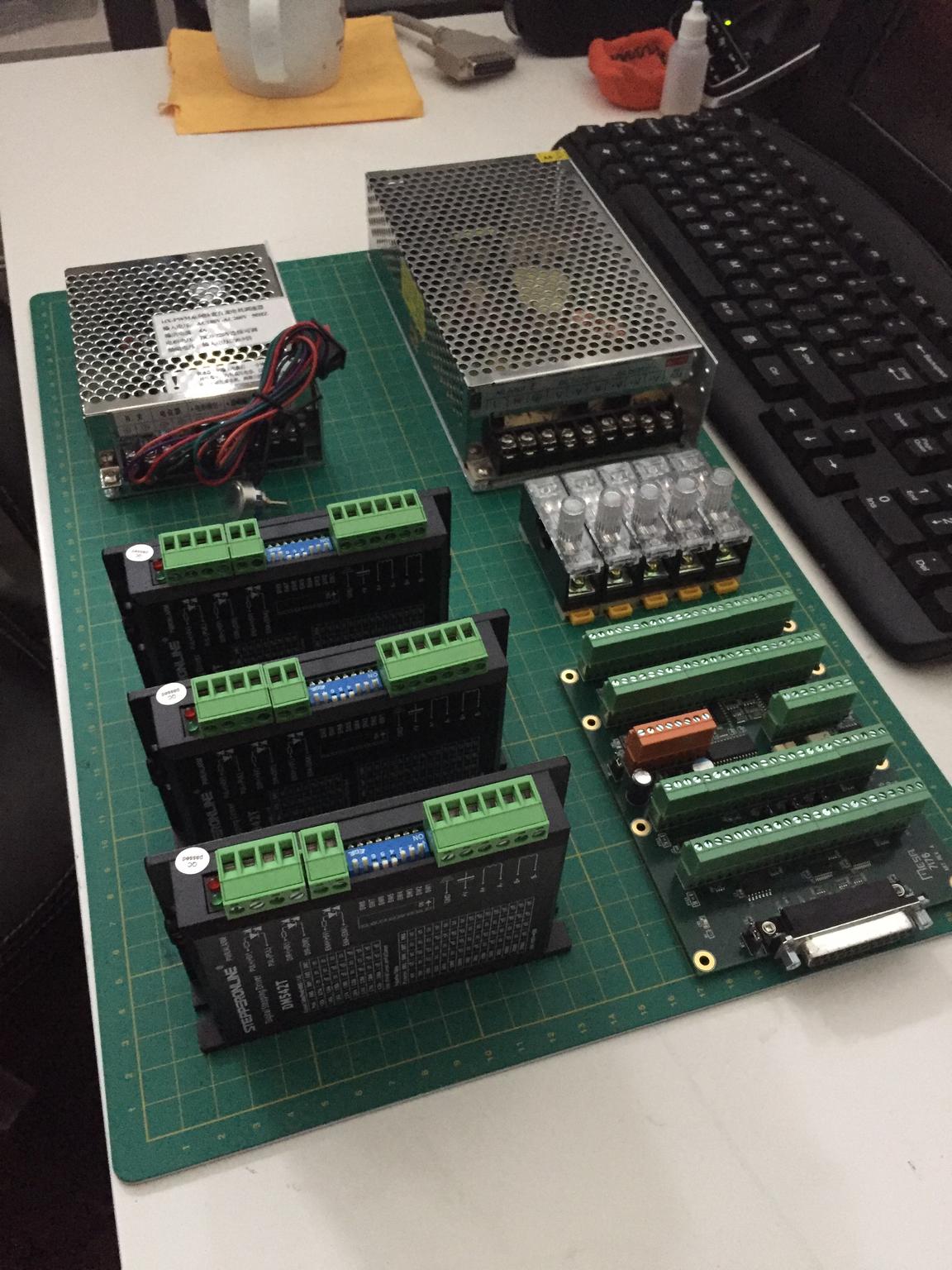

    I then went eBay shopping for the rest of the components.

    For the spindle drive I got a Parker 508 dc drive, it will power the dc motor with the 180v dc 8A it requires.
    X y and z axis stepper motors will be powered by dm542 digital stepper drives.

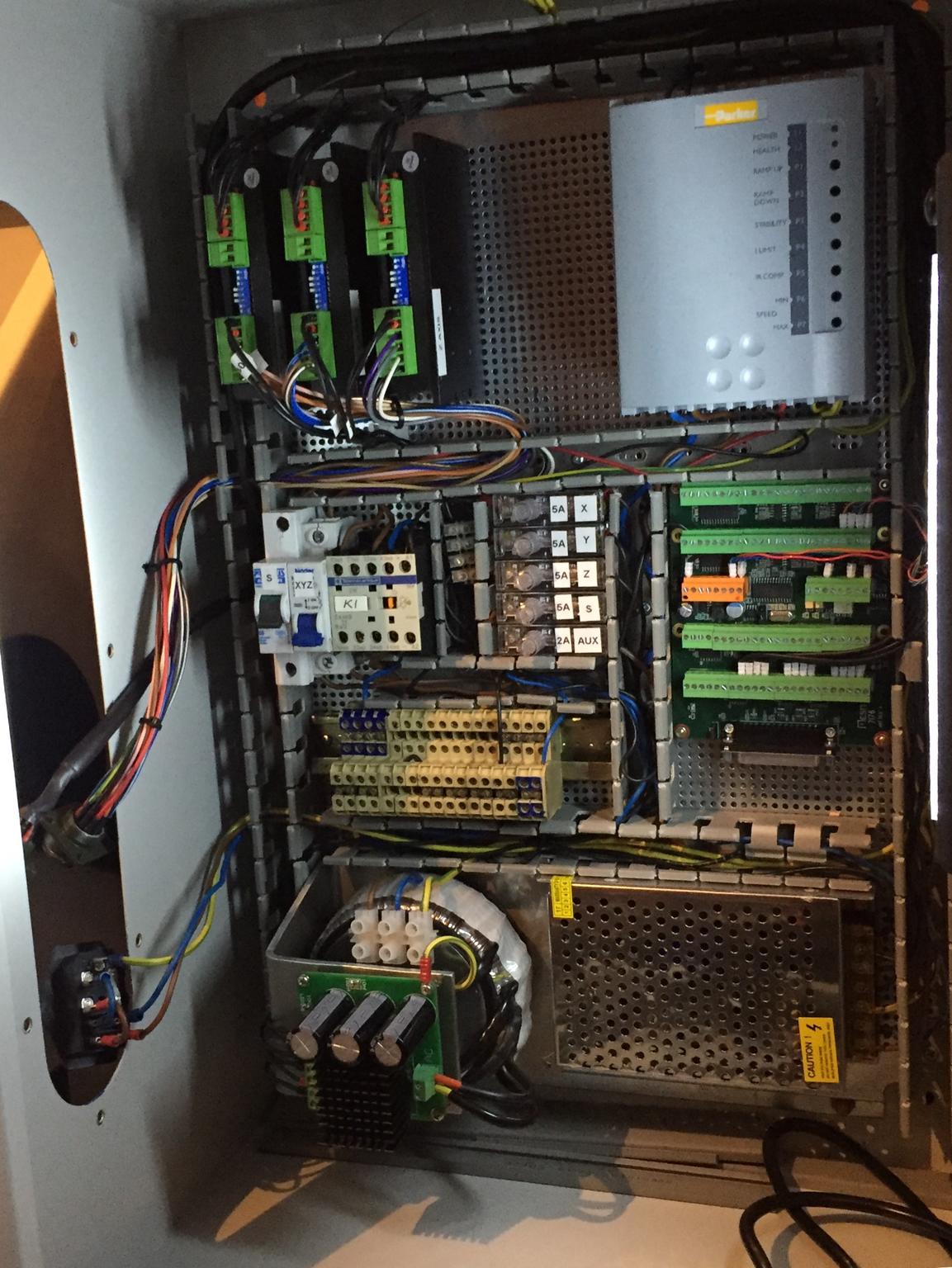

    I designed my own safety circuit with fuses, contactor, and mcb’s.
    I made it all look tidy with some slotted trunking. I did by best to separate the control signal wires from the ac and dc power by routing them around the outside whilst routing the power trough the centre. Any crossovers are at 90 degrees and I utilised shielded cable where applicable.

    For this build I will be using linuxcnc specifically the 5i25 fpga card and the 7i76 breakout board from Mesa electronics in California.

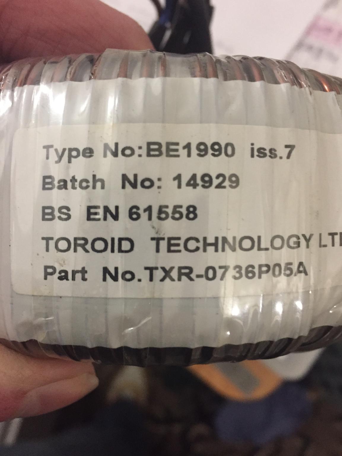

    The power supply for the stepper drives will be 40 volts or thereabouts, I got a toroidal transformer and a rectifier circuit and made my own power supply.

    Here’s the control box almost complete:Click image for larger version.

    I’ve left a space so I can add another drive for a 4th axis later.

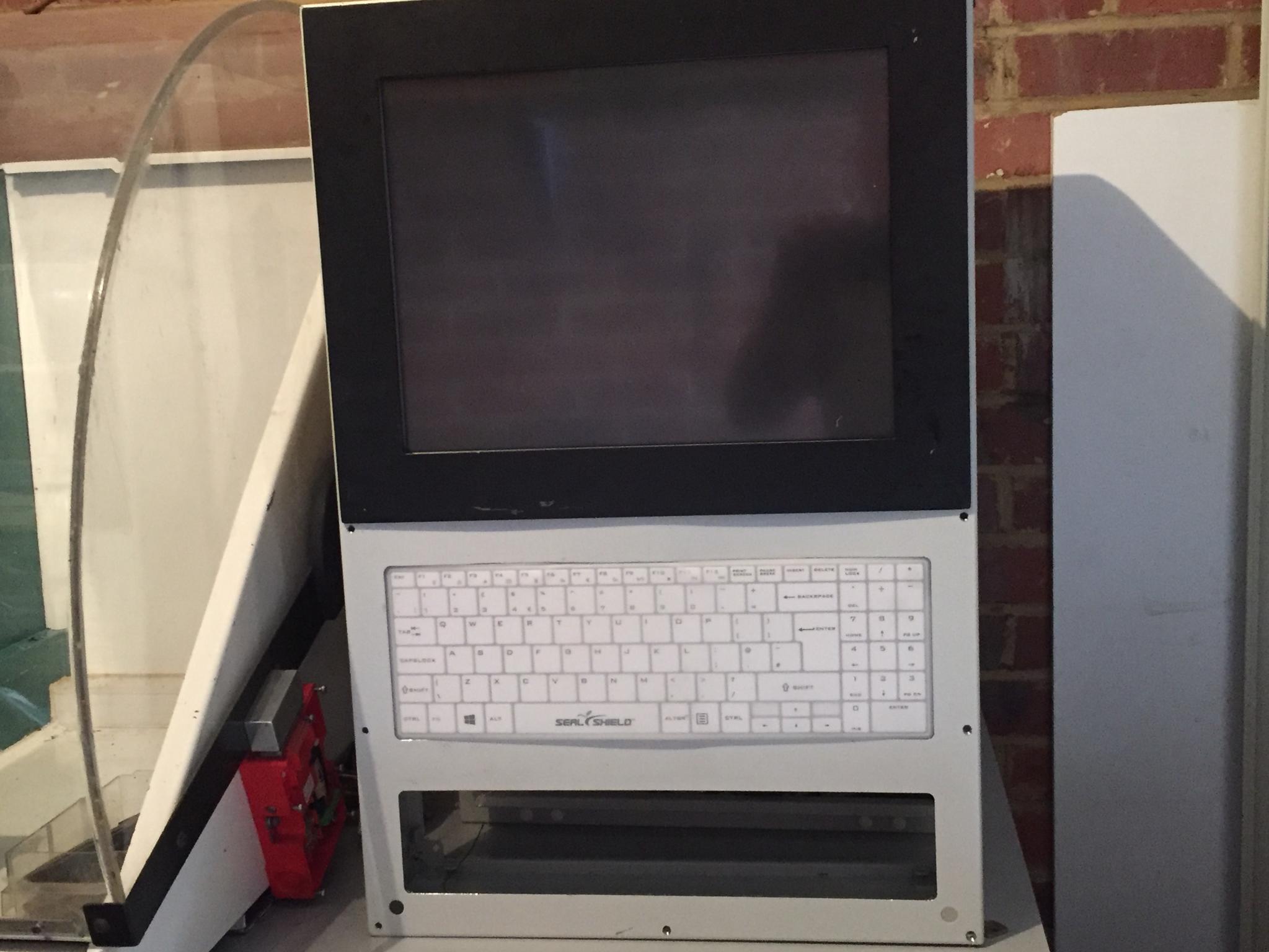

    I’ve made a start on the operator interface. For this I’ll be using a 17” touch screen monitor and a waterproof keyboard. The aperture at the bottom will house the start/feed hold buttons, a feed override pot, and a spindle load meter.

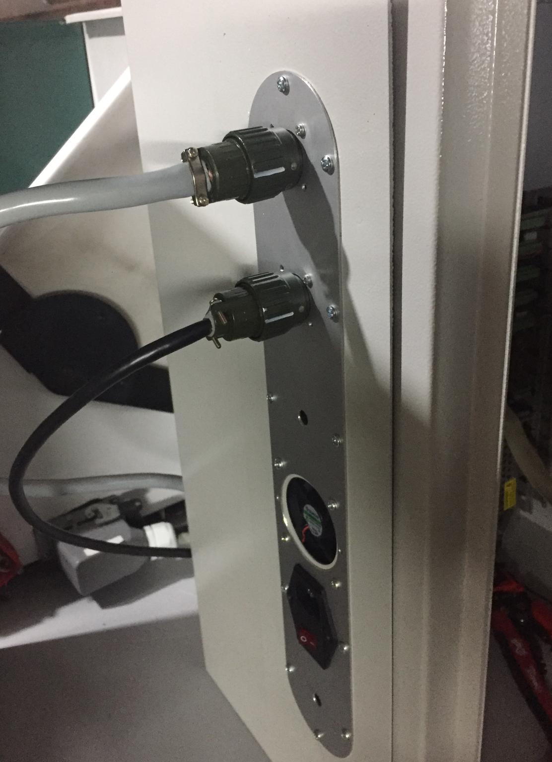

    Today I temporarily plugged in the machine and configured linuxcnc. I needed to cut an i/o plate for the cabinet. Specifically the holes for ac input, cooling fan and plugs for the machine. I had previously machined the outside profile on a machining centre as it was too big to machine on my denford mill.

    I’ve left a couple of locations empty, one will be for the mpg and the other for a 4th axis.

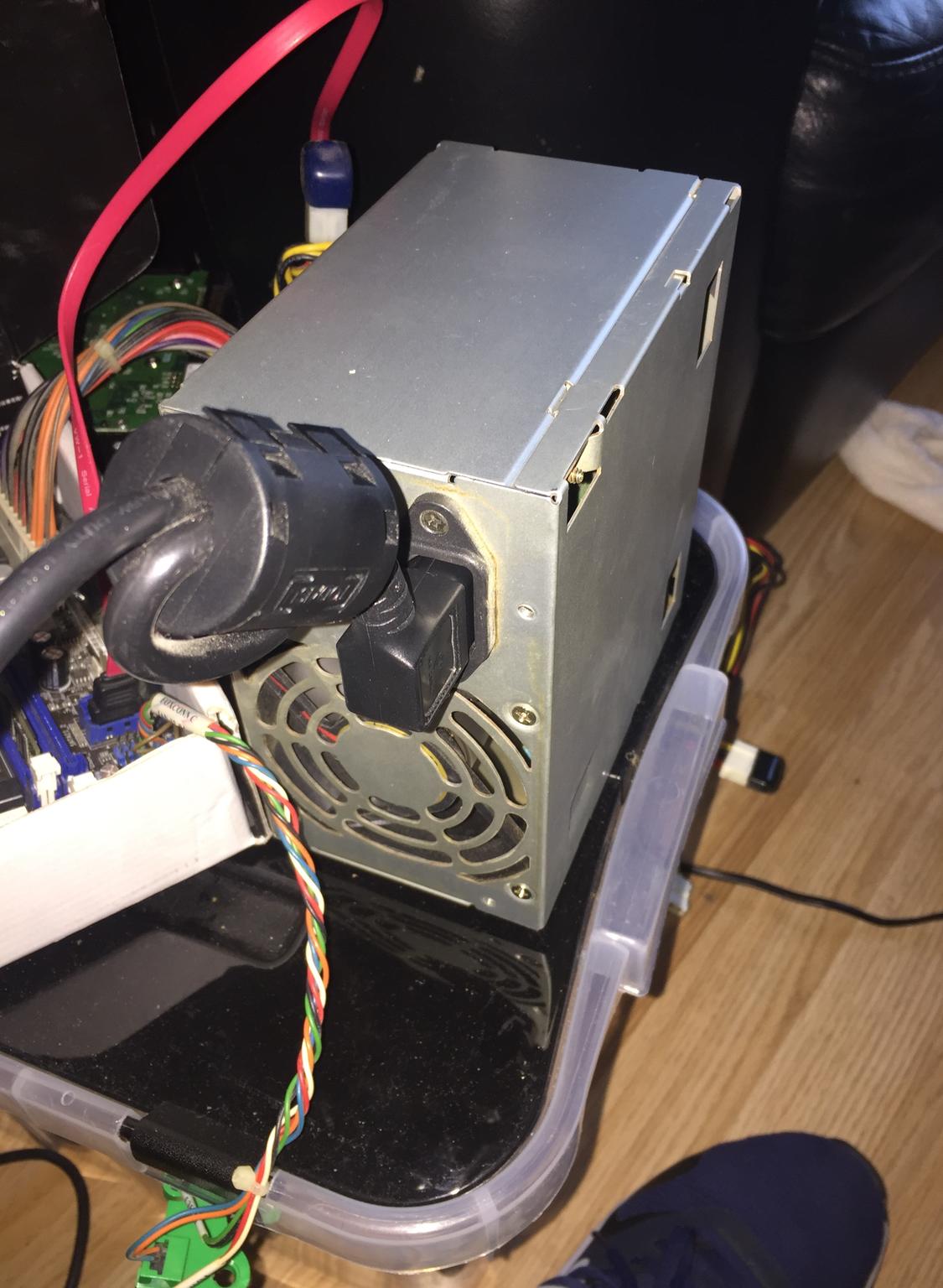

    It’s an Asrock mini ITX with Intel Atom D425 and 4gb ram. Linuxcnc has a program included in the package that lets you test the mb to see if it’s suitable for use with linuxcnc. Although it’s not that important as I will be using the fpga card to generate the stepper steps. This motherboard appears to be more than fit for its intended purpose, it’s tiny size will help with the install I’m sure.
    I’ve also salvaged a 250w itx power supply and 120gb SATA hd from an old pc. It took me about an hour to plug it in on the bench, install linuxcnc from a usb and copy the files from the old pc to the new one. So it’s now ready to be installed in the cabinet...somewhere...

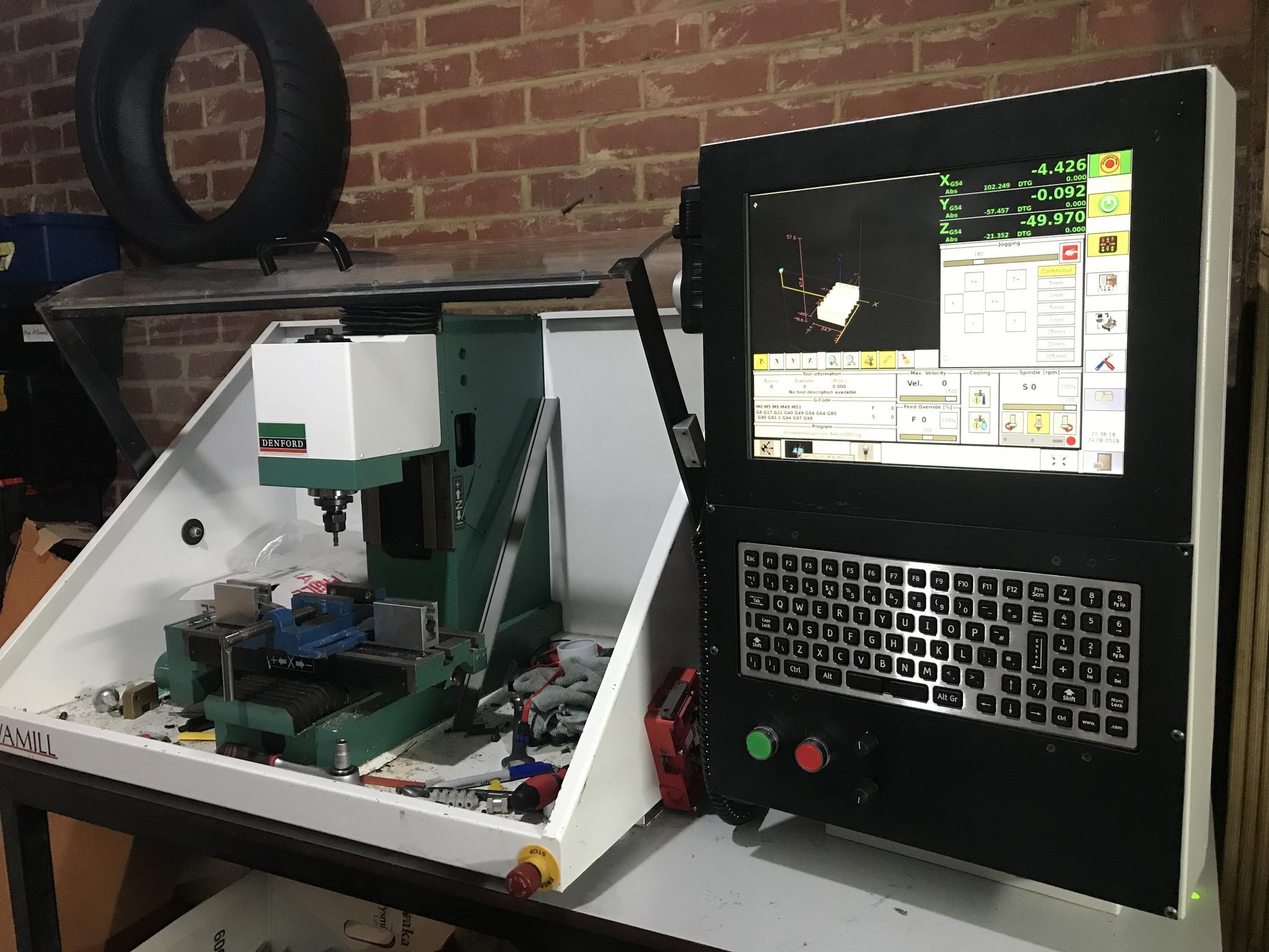

    I’ve now changed the keyboard for a storm interface stainless steel one, and wired in my buttons for the start, pause, feed override and spindle override.
    I raised the mounting of the operator interface for better comfort when using the touch scree controls and also to make it better for keyboard input. Not that I’ve used the keyboard for input though, I’ve been using fusion for all my work.
