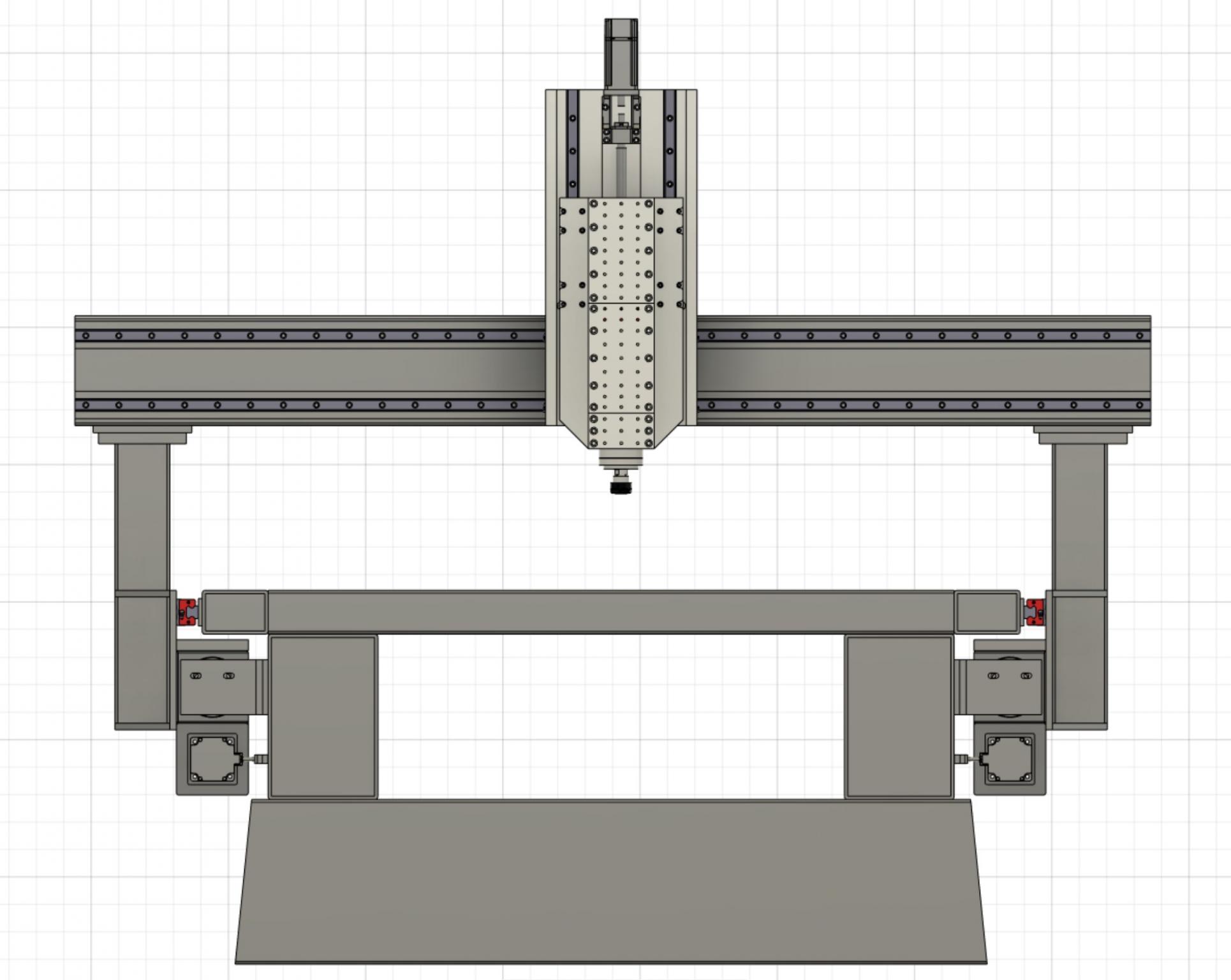

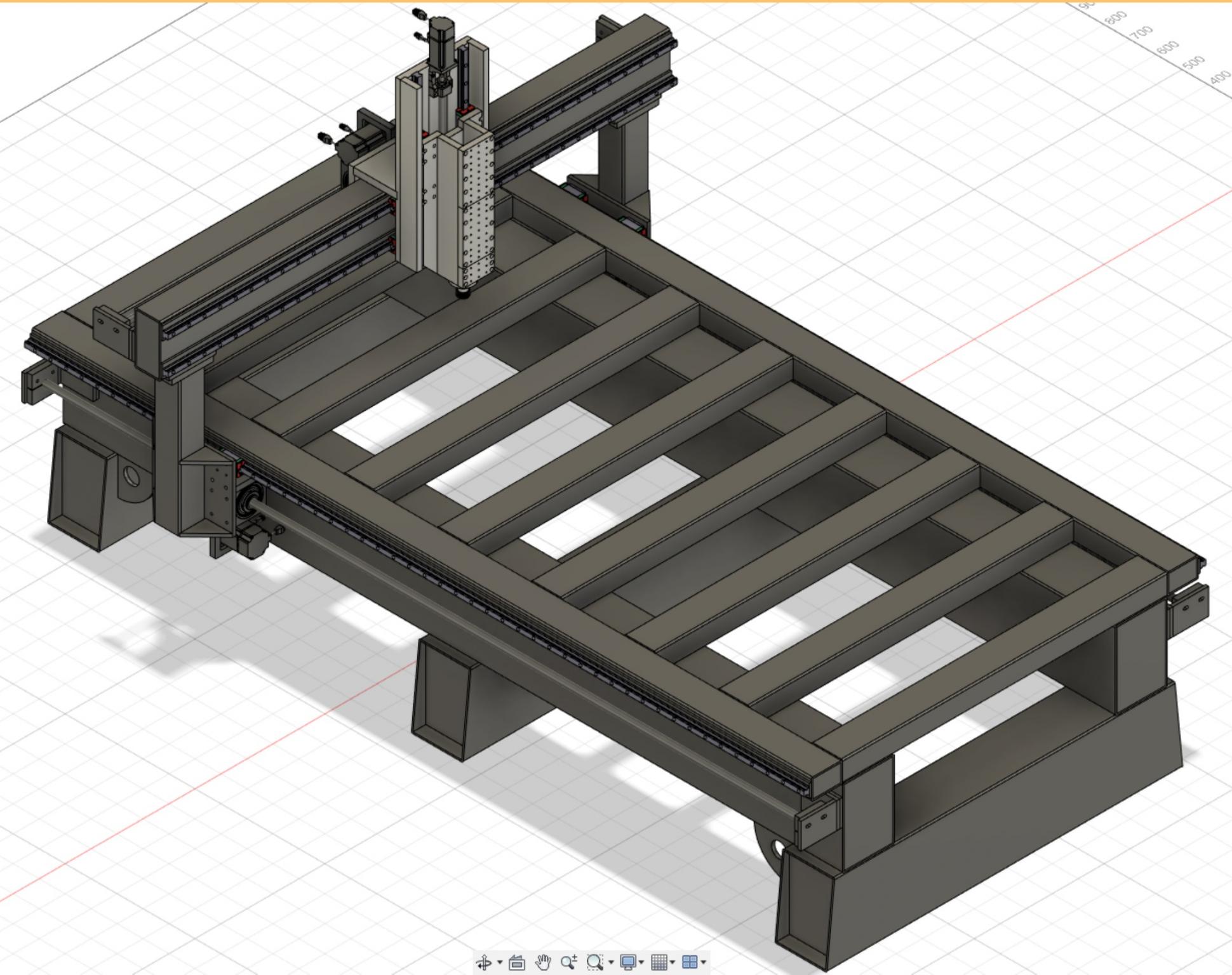

    My First Official Thread:

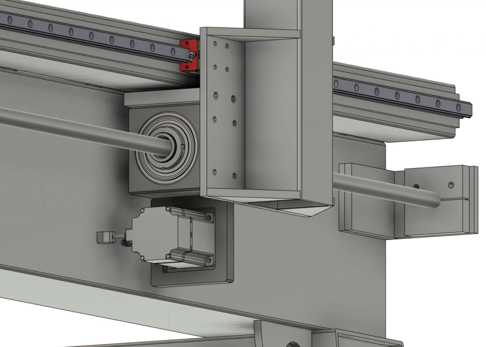

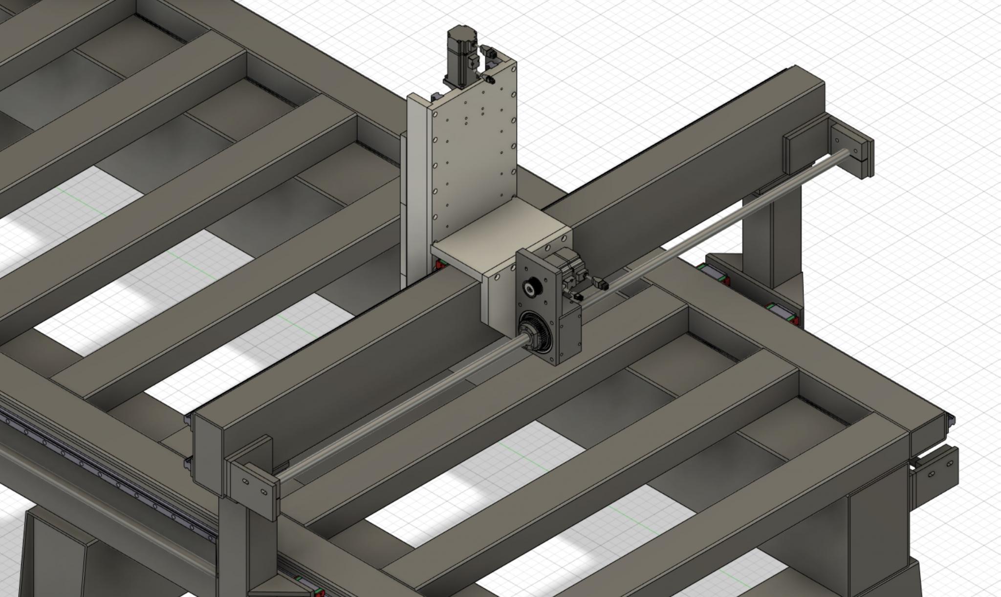

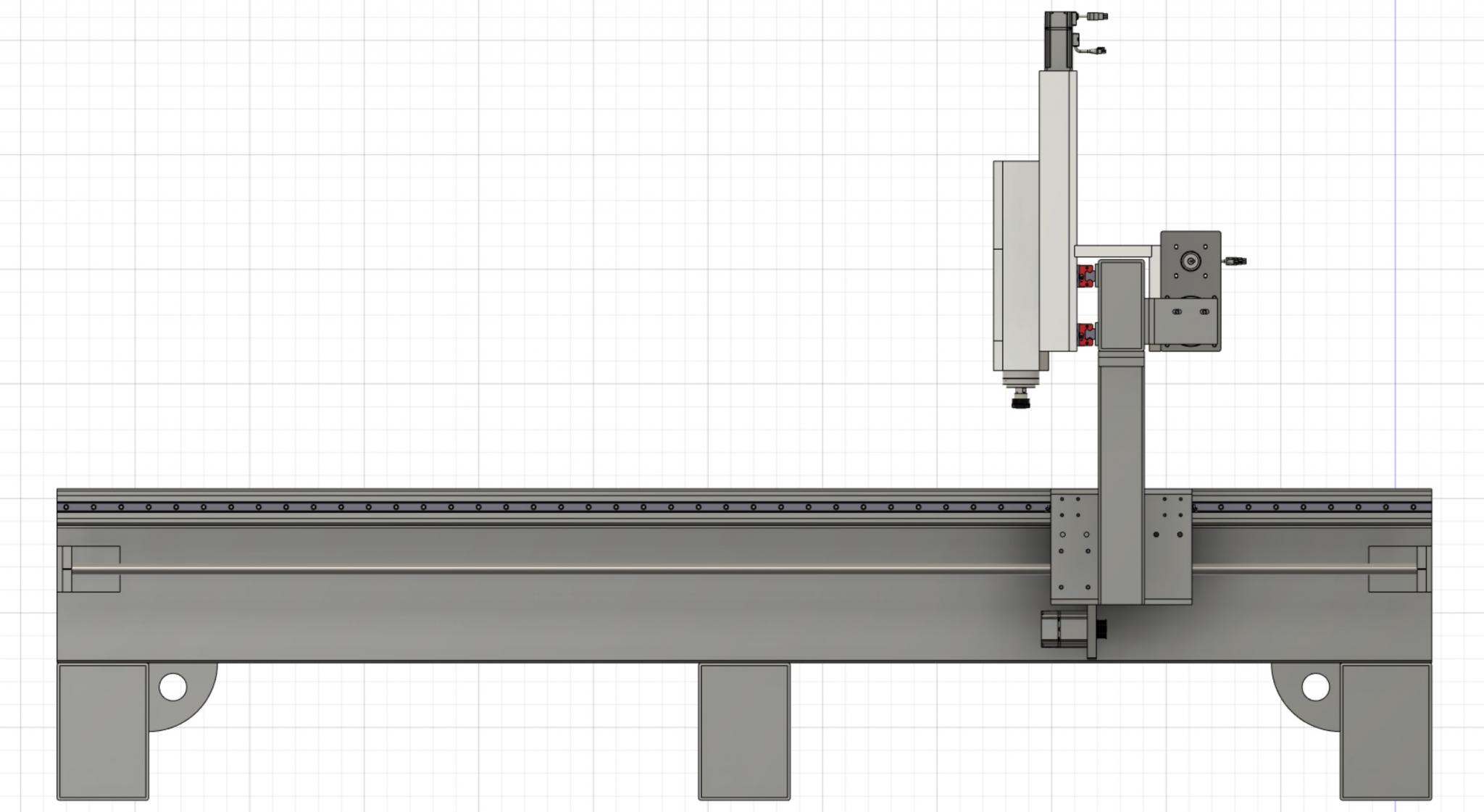

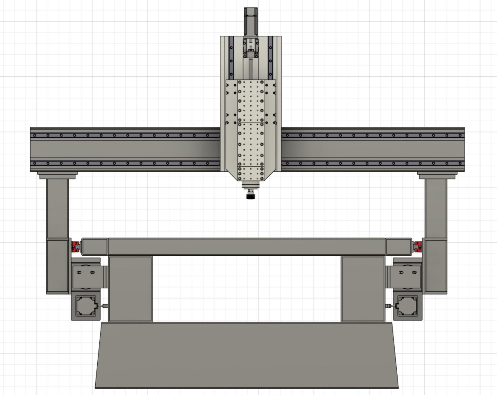

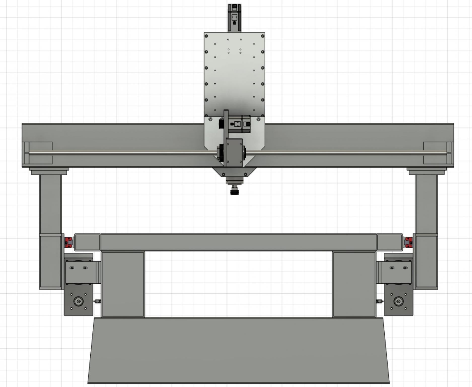

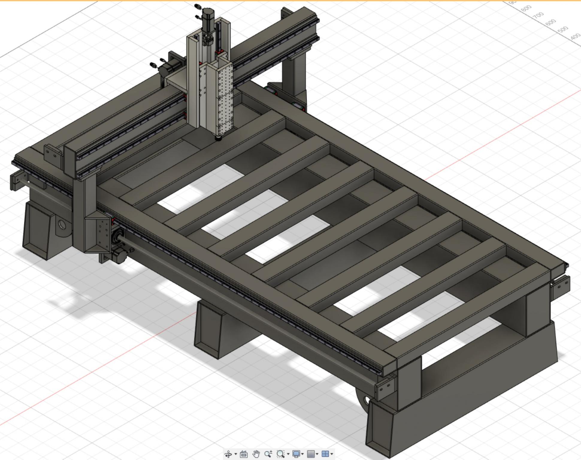

    This is to be considered The love Child from mixing many desgin ideas from official branded machines and design ideas inspired by threads i have gone through here in the forum. Mainly Shopsabre base and gantry design. with implementation from Jonathan Rotating nut mixed with Hasse Germany. and z axis inspired from Boyan Silyavski build with twist.
    The design is not finished but in final stage right now so i thought to use all of you helpful experience to correct me before i start this mega project
    This is the first cnc to design or build, i have good experience in welding and got access to a few big size machines, so it was easier choose steel.
    The main tasks required from this build: to be able to work with full sheet of MDF, plywood,.. etc and to be able to process aluminum plate stock
    Workspace as mentioned in the thread title 1200*2400 with 300mm Z Clearance and 400mm travel "i know it's not optimal but i would like to hear your thoughts about it, if it can be managed or it will end up as a weak point in design
    The steel will be used in this build
    Base 200x300, 80x120 mm
    Gantry 100x200, 100x100 mm
    Steel Plates from 12 and 20 mm as end plates
    Materials Till now will be updated if any change happen
    X Axis:
    4x HGH 25 Blocks with HGR25 Rails By Hiwin
    SNFU 2510 TbiMotion Ball Screw
    750W Schneider Electric lexium26 servo and drive Geared 2:1
    Y Axis:
    2x SNFU 2510 TbiMotion Ball Screw
    2x 750W Schneider Electric lexium26 servo and drive Geared 2:1
    Z Axis:
    1x SNFU 2010 TbiMotion Ball Screw
    1x SYK MBCB15-D Motor Mount
    1x SYK BF-15 Screw Support
    1x 400W Schneider Electric lexium26 servo and drive Direct Drive 1:1
