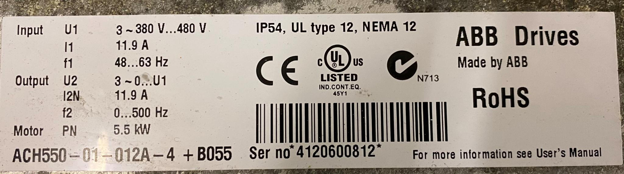

    So, my VFD has decided to crap out on me and in need of a replacement before monday ASAP. in the meantime i have 4 of the below VFD would these work and if so can somone help me get it wired up. start stop would be fine but would look at going into speed control.
    my Spindle is a 4.5Kw
    This is the inverter i have which is above the spindle the other ones are only 4s
    Manual http://www.mke.co.uk/files/abbach550hvacusermanual.pdf
    I will need to do a factory reset as this was installed on site for a pump
    any help would be greatly appreciated!

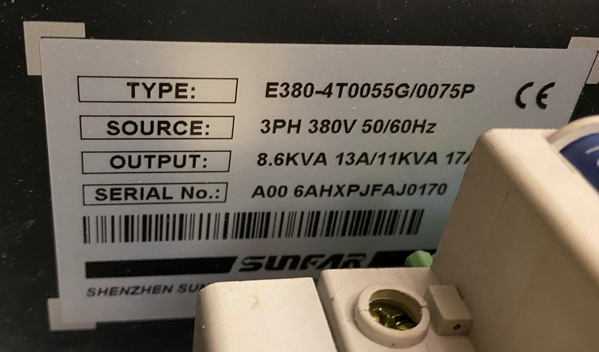

    This is my old VFD

    If your motor is only 4.5kW and you have some 5.5kW VFDs, you should be fine. The voltages look suitable unless I missed something. The old VFD was only being used at half of rated power but should have been fine there.
    Obvs you need to set up the new VFD with the nameplate numbers from the motor. Usually stuff like max phase current, max frequency, number of poles etc.

    Cheers, I’ll give it a go tomorrow. I’m just trying to get through the manual. Looks ok to be fair but the speed control looks a little complicated from the Chinese ones
