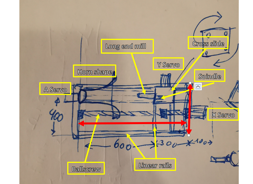

    I am thinking about building a mill to make loudspeaker horns. In their simplest form they are axi-symmetric, so a type of lathe might be well suited, but many are elliptical or have other shapes that are challenging to turn on a lathe.
    As I am a newbie in this field of engineering I am looking for some guidance.

    As much as possible out of alu profile, Bosch rexroth or similar. Special mounts, end plates etc. made to fit.
    Control
    My layout calls for a machine that works in cylindrical/polar coordinates, which I'm slowly realising might be quite difficult to realise as a DIY project. I have started to look into controllers and software and such, but it takes some time to dig through it all. Does this call for a 4 axis controller?

    I have a made a rough sketch of the layout here:

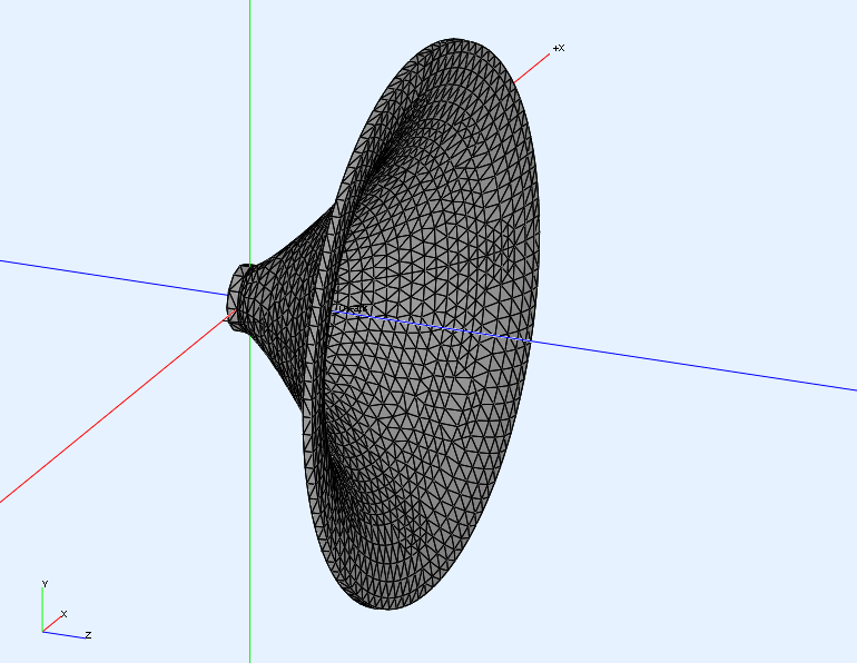

    This is a typical example of a mesh of a horn:

    Is this coordinate system doomed to fail?
    How much travel is possible for the spindle axis before it starts wobbling, should it be horizontal?

    I wouldn't worry about polar coordinates, I've designed and machined/had machined a number of horns from 3D models on normal 3 axis CNC without any problems; some (for tweeters) that needed quite fine and accurate details. Much quicker and easier to go with hardware that's easily available and let the CAM software do the work IMHO.

    Yeah, I've sorta come to the same conclusion since I posted :)
