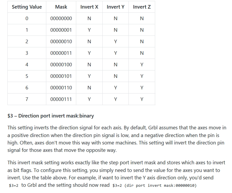

    To me its strange that there seems to be no individual setting for X and Y inverts etc.

    $3=5 (Step direction invert) ... Is 5 the correct number ? I would have thought 0 or 1 !!

    You need to view the table that comes with GRBL to work out that question about $3=5 It is actually settings for reversing the XYZ motor directions without having to physically doing it with the wiring.
    anything equal to =0 means disabled, =1 is enabled , other numbers are from the table above and are used in several of the settings.
