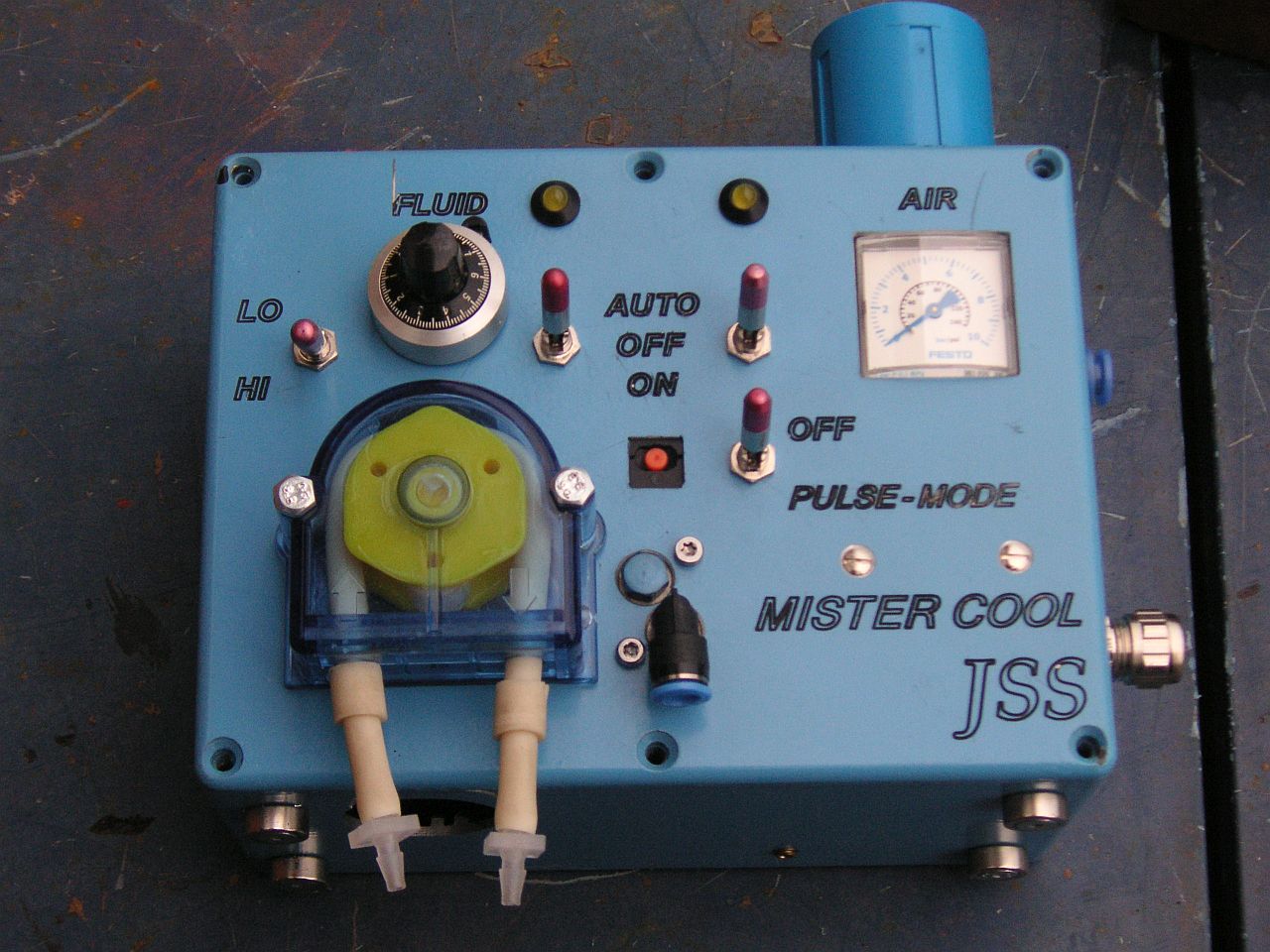

    Not mist but a very controlled drip of coolant using a step motor powered peri pump
    I can turn constant for about 8 hours on around a litre of coolant mix. I do not recover the coolant as most evaporates and the remaining oil sticks mainly to the swarf
    It works incredibly well

    Paul I like the idea of a stepper motor powered peristaltic pump with a controlled drip rate. I will do some research to make up a small system. Do you use normal coolant mix or ethanol water?
    My effort

    Normal soluble oil and water at around 6% oil
    When thread cutting I find some engine oil from the oil can works better than the coolant drip and as I don’t recover the coolant no issues with tramp oil
    I made mine from mainly 3D printed parts three skate board roller bearings and a length of model aircraft silicon tubing plus a nema23 stepper I had lying around. Control was an eBay special rotary knob that generates step pulses and a £6 stepper driver. All working from 12v from the pc psu

    Paul - I'm struggling to consider 1 litre of fluid over an 8 hour period to be a "coolant", rather than a lubricant. That's around 2ml per minute if my sums are right. Even if it were fully evaporated during machining, that's got to be a fairly small cooling effect. When you say it works incredibly well, are you referring to the surface finish rather than the temperature of the cutter and work?
    Both, the part comes off cool as does the tool. Surface finish is excellent
    Tool life is also excellent
    I turn mainly aluminium
    I dried it dry first and got pick up on the tools and poor surface finish. Then tried a brush and coolant and was much better but I didn’t like the idea of being there with the brush and coolant all the time so devised the drip method with the peri pump
    Pump on off is controlled under gcode from linuxcnc but speed of pump rotation is on a manual control knob. 90% of the time it is in one position but I do turn it up for parting operations
