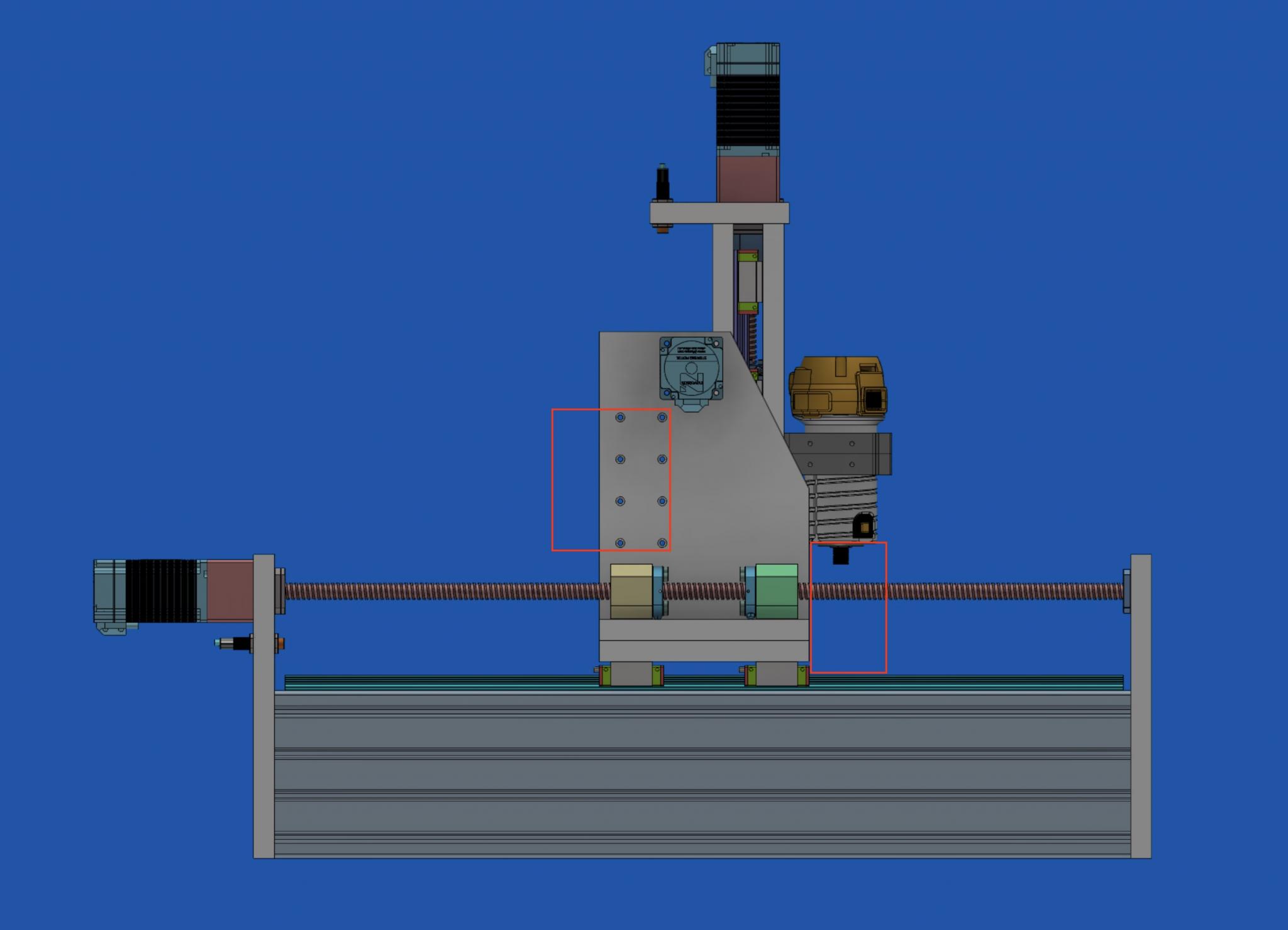

    After further considerations, planning and design, I have revised my previous design and made several chnages.
    I am now moving to the build stage and will likely start to build some assembly in the next week or two, so this is my last chance to take on board some feedback and fix any errors or oversights!
    This is the latest design...

    Hi ian,
    I hope you havent started yet, because I would strongly reccommend to go with design option 2.
    - The reason is, that the arrangement of the x-rails of option 1 is allmost pointless. The idea to have more than one rail is all about having a broad base (by putting them apart as much as possible) to compensate larger moments (to make the design stiffer).
    In design option 2 you have a far better stiffness using the same components, hence you will get closer to your design goal of a 0.01mm precision (wich is tough to achieve)
    - Option 2 will also have less debris falling on these rails.
    More ideas:
    - Another improvement to option 2 in that same direction would be by placing the x-spindle also on the outside, having less debris on it and the nuts beeing in the middle of the 4 wagons (seen y-wise optimum for transferring forces) . The spindle and its nuts can even be put on the outside of the cheek, making it more accessible to adjust (you are going for a 2 nut spring loaded design, I take it), to grease and to clean.
    - Increase the cheek plates thickness to 4/3 of what they are now. Same goes for the plates of all the z-parts.
    - Consider side-plates for the moving z-plate to increase the second moment of inertia in x-direction (y-direction is never a problem there)
    - Also prepare the design to hold a "real" milling spindle later. Starting cheap with a handhold router is absolutely ok, but you will later want to get a spindle built for that CNC-purpose anyway, e.g. in the 2.5KW region.
    - If you then will go for a watercooled version, you will also have a quieter machine when milling plastics.
    Furthermore:
    - Rubber bumpers that stick out allmost as much as the end sensors on the x and y axes may save the thing in case of an end sensor failure. To find space for the bumpers on the z axis is more tricky, but there are doughnut shaped solutions, that mount right around the spindle end bearings or around the nuts.
    - Concerning the mentioned axial versus the tangential use of these type of approach-sensors: To my experience, the axial use you have chosen is far more precise (repettitive correctness). That would also improve such an end sensor as an absolute home sensor, if you intend to use them that way.
    - To avoid destruction of the sensors in case of collision, I use plastic (printed) adaptors around them, which will break under stress, so that the sensors will just be pushed through their larger mounting holes.

    It's been a long time since I worked on or posted an update on my build. I had to put the parts into storage and my build was delayed as I had to move twice and didn't have the space for the machine. I worked on it in short burst and am now starting to make progress again and attach a few pictures. I used a Openbuilds workbee and initially cut plates from Delrin. I then partly assembled the machine using the Delrin plates and then machine aluminium plates but unfortunately I cannot locate pictures of this interim step. The surface finish though is very bad and I will likely finish these by hand to improve it.
    Herewith a couple of pictures to show the current state. Next steps are to complete the wiring in the next week or so.
    During assembly I realised that I've not allowed for proper adjustability and one of the first tasks will be to cut two new plates to improve the fore/aft and lateral adjustments.
