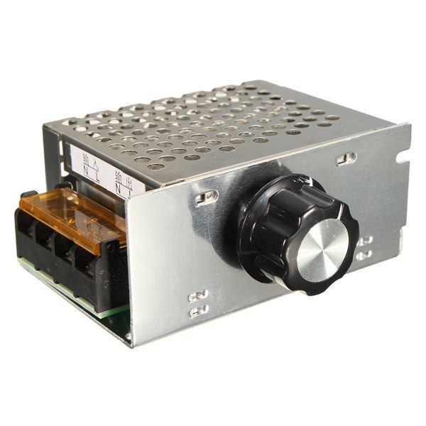

    Hi i brought a mini table saw which came with a combination off-on-speed controller. when started the motor "pulses" it seems to reach speed then just drops off then starts up again. the faster the speed controlled the faster it pulses and dies.
    10,000 rmp is over twice what i want to use a rpm
    I tried a 500w fan -light dimmer but that let all the magic smoke out.
    Can someone answer if a 500W ceiling fan speed controller work with this motor. ive already blown $25 for the dimmer and a 500w fan controller is $50.
    or do i need a AC 220V 4000W SCR Voltage Regulator Dimmer Electronic Motor Speed Controller
    specs
    input voltage: AC 220V
    Voltage regulation: AC 0-220V
    Maximum power: 4000 W
    Current: 25A
    as in pic
    appreciate any help
    regards Richard

    It depends on what kind of motor is fitted.
    If it's an induction motor, then the only way to control speed is by altering the supply frequency, which you can't really do with a single phase motor.
    If it's a DC brushed motor, then that SCR drive should work.
    Surely there is something wrong with that "on-off speed controller". The way you describe it, is not normal, no motor speed controller should do that. Contact the seller and request a repair or refund. Is the saw OK if you run at full speed?
    There is also no way of knowing that the dimmer you are showing is for inductive or resistive loads, and since it seems to be a cheap eBay version, I'd suspect it is NOT as you describe it, it can definitely not handle 4kW inductive load.
    You say it is for a mini table saw, but how is the motor? What sort of brand and design is that? What are the motor specifications? I have a Proxxon mini saw with 85W motor, I don't even dream about reducing the rpm, because it would just stop. Also my large Bosch is always running at full speed, even though it has a 1.8kW motor. Why would you want to reduce the rpm? You know that by doing that, you also severely reduce the torque.

    Regarding that dimmer, it is probably made for 500W resistive load, not the same as 500W inductive, which a motor is. Also, as I said before, reducing the rpm through voltage reduction means reducing the torque, so I think that's generally a bad idea.
