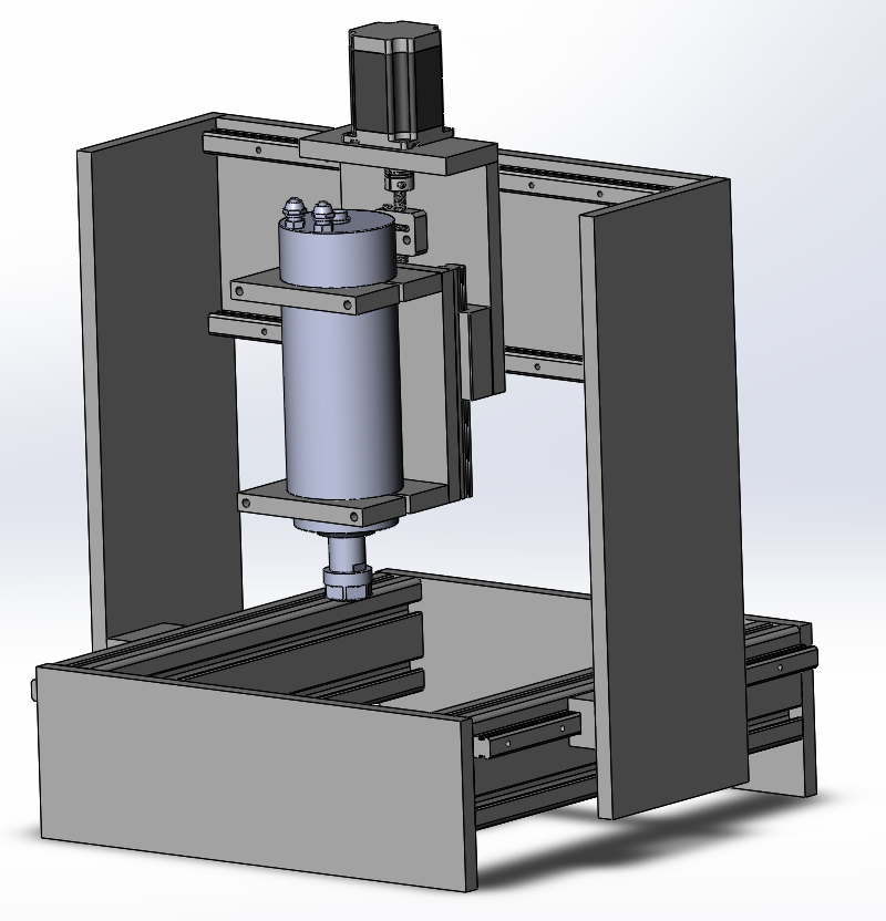

    I'm new to CNC and am currently planning my first DIY CNC build. I have many questions as you'd imagine but i'd really appreciate any help you can offer!
    I plan to use a 2.2kW chinese spindle, which i believe has the power to cut steel (does it?):
    http://www.ebay.co.uk/itm/2-2KW-WATE...3D181806514041
    I get the impression that with the right kit, it's not TOO difficult to cut aluminium parts on a DIY machine. By the right kit, i mean anti-backlash nuts for leadscrews and rails/ bearing carriages for linear guidance. From my research these are the best options for good overall stiffness on a budget.
    I've seen videos of people cutting STEEL on these machines, which i'd love to do. I get the impression that the main design criteria for cutting harder materials will be the stiffness of the rig, however i'm not sure about how to calculate the required stiffness as I can't find a reliable way of finding the maximum force on the cutter. I have access to FEA software, so if i knew the forces involved, i could get a good idea of what i'd need of the frame. I won't be cutting steel all too often, and the spindle is quiet, so I don't mind if I have to feed extremely slow or take super shallow cuts.
    I don't want to just over engineer the hell out of it, although it's a tempting option, as I'd like to keep the price down.
    I've attached a picture of my design as it stands, in case you're interested. Let me know if you've any ideas to easily increase the stiffness. The plates are 1/2 inch aluminium, the ally profiles are 40x80. This gives a 300x300 cutting area 100mm z travel.

    I see you have been impressed by other peoples videos where they cut steel on their routers. So lets cut the crap- the answer is:
    If you want to properly cut metal- buy or make a proper metal cutting machine.
    Detailed, i write this down for the benefit of others in the future that drop here with similar questions:
    -with the machine you have drawn would be next to impossible. Forget aluminum, all need be steel, all needs to be braced in all directions, the thicker and the heavier-the better. You could use aluminum, but must be reinforced with steel.

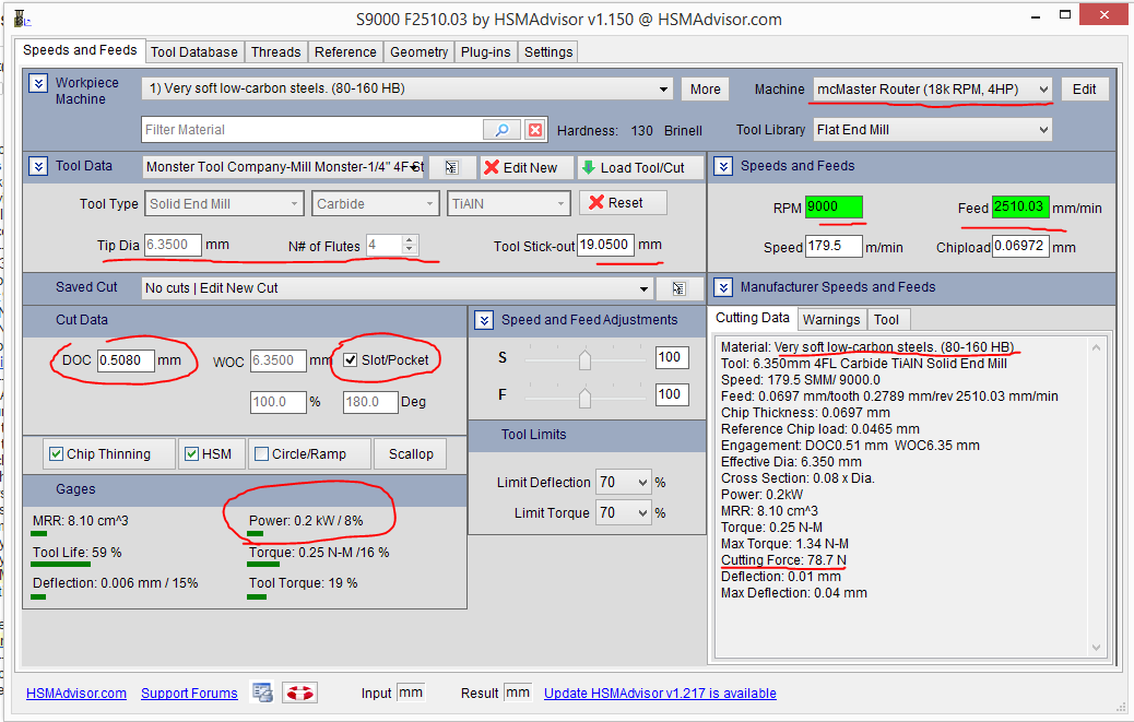

    One thing worth noting is that yes, if you have very sturdy setup, use small bits, have rigid table, proper cooling and calculate properly speeds and feeds you could machine mild steel. I dont see how thats to happen if you dont use some software like HSMAdvisor or Gwizard to finely calculate what exactly you are doing. From there you will see the forces involved and the power needed to do that.
    I myself use HSMAdvisor, inside there is an profile of 3kw 18k rpm spindle, use that to see what happens. I highly recommend getting the 3kw versus 2.2kw for metal.

    So yes, if you go that way, its better to have the gantry fixed. Do your research and see build section in forum. There are discussed machines exactly made for what you say.

    PS. below a snip from HSMAdvisor, As you see spindle power is not the limiting factor. it would be the stiffness. sliders are adjusted for standard stiff machine/ mill/

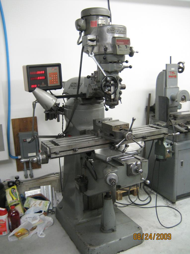

    Here is picture of a mill, it's a Bridgeport - the most common mill ever made i think, I have one just like it. It's 1100kg of solid cast iron and has a proper 2Hp motor on it.
    It is capable of milling steel, but will only take relatively light cuts due in most part to it's versatile nature - the head can swivel, rotate and tilt, these are great features but make it weaker when it comes to real milling.
    Steel needs lower speeds and more power, yes it can be done with high speeds but you can expect short cutter life and you will only be scratching away the metal.

    Conversions can be done, plenty of Bridgeports have been CNC'd - ball screws are a must and a good machine as a foundation is a big help as lot of them have had a hard life.
