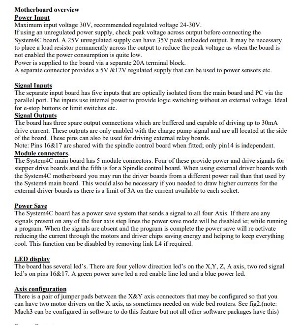

    A_camera, Doddy, thanks for replies.
    I think the existing system will have the opto isolation built in,I'll try to attach Ist page of manual. (I got it in 2012 and the guys website doesn't seem to exist any more)

    Ian, I apologize - I had made an (I think) invalid assumption - sounds like your setup has the BoB and Drivers installled onto the single board (again, an image would help but it certainly sounds that way - and I am familiar in passing with that sort of board). But, yeah, you should be able to plug a UC300/UC400 into that without any real surprises. Again, you'd need the ribbon cable, but that's all doable.
    I bought my UC300eth from CNCDrive directly with no problems (pre brexit/corvid), and an AXBB from another member of this forum, but that's for themselves to offer if the opportunity remains.
    Unspoken, but going for those controllers opens up the option of replacing Mach3 with UCCNC - most people that have tried this seem to prefer it to Mach3 - I certainly do. You can download a copy of their software - without license file it only operates in a demo mode, but enough to get a feel for it.

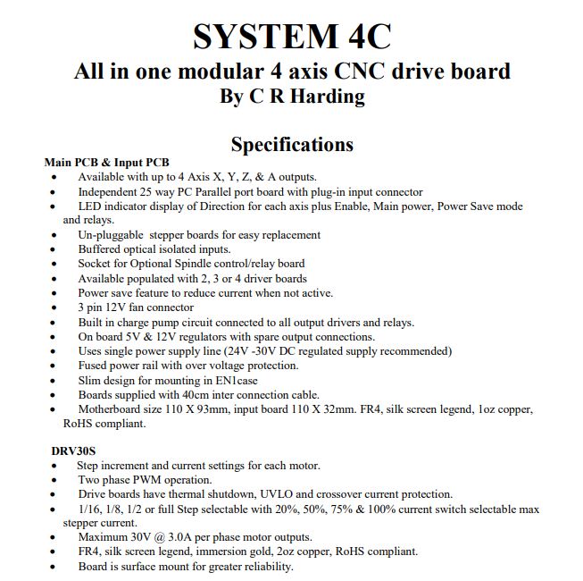

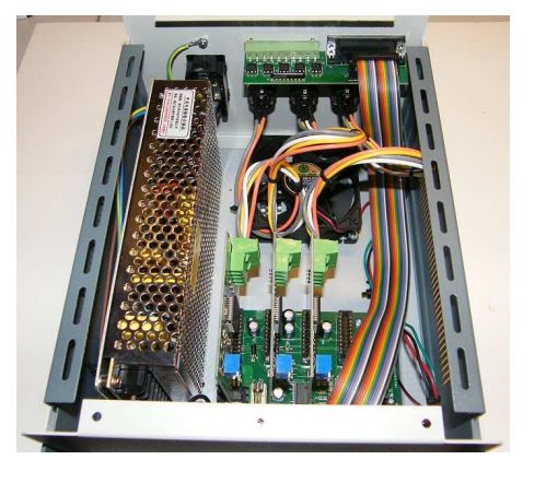

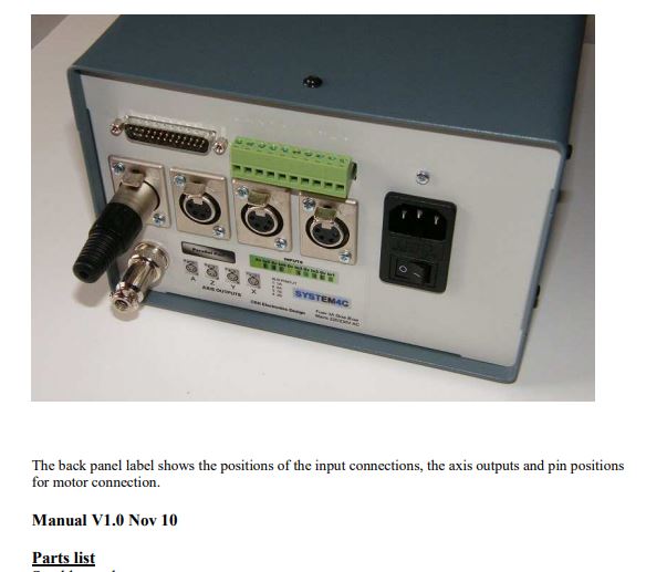

    Hi Doddy
    My fault for not giving much detail, heres a couple of pics from the manual

    I don't have motor control, just the 3 steppers.

    Okay, I take it back. That's a new configuration for me. But the advice still stands - you can connect the UCx00 easily enough (though options to incorporate into the physical enclosure are a bit more limited). If that big PSU is a 24V DC powersupply for the board then why not slave the power from that?
    Doddy, good idea re the power supply. Doing that wouldn't create any risks of earthing loops would it? I only ask cos I had a nightmare when I first built this kit with steppers twiddling randomly while I watched. Turned out to be entirely due to my ignorance in that I thought I was doing a better job by earthing both ends of the shielding on the stepper cables
    Edit: bugger. Power supply is 27V, just enough to exceed 24V max for UC400!
