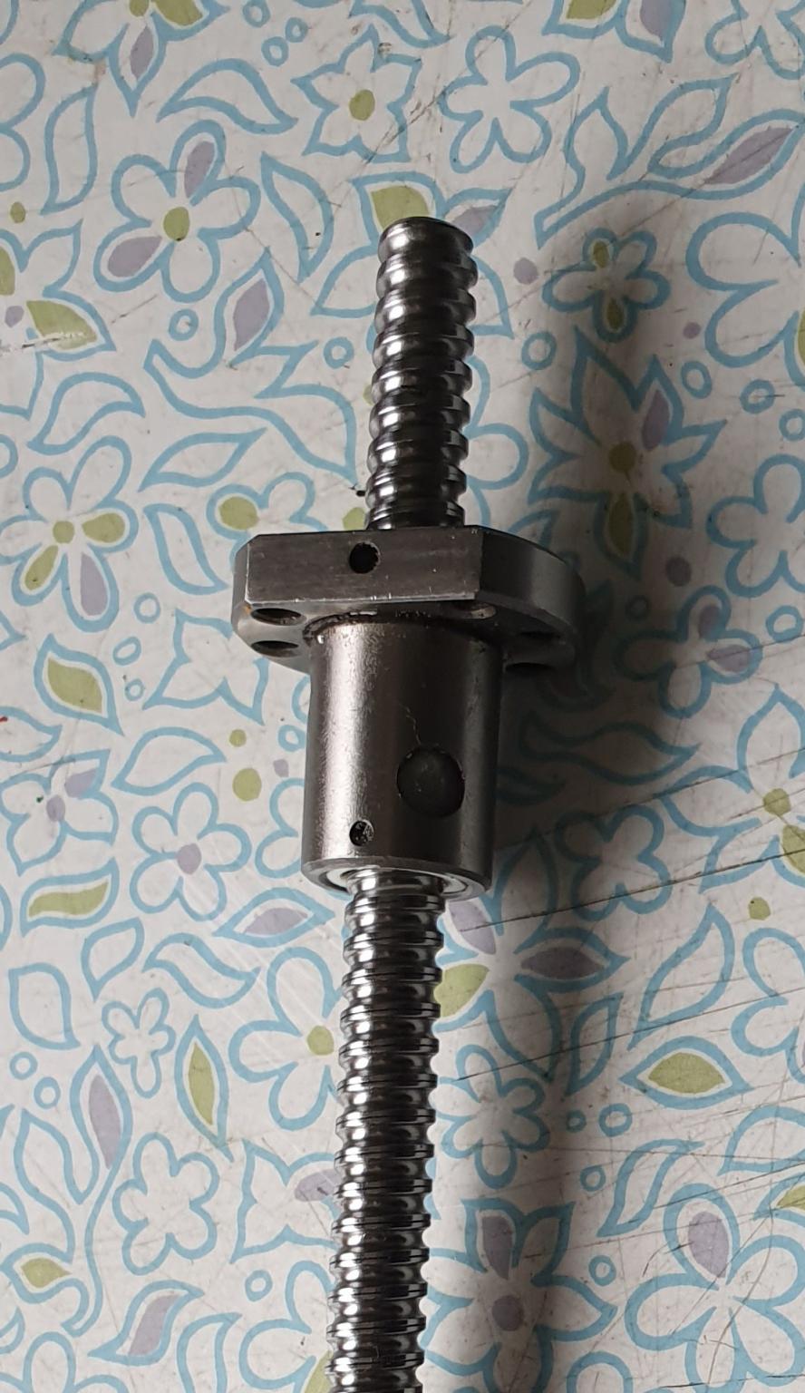

    I have a spare 1204, 300 mm long not machined if any use
    I have used the supplier that Lee mentioned quite successfuly

    I presume that you would also need a thread and a reduction for your coupling, if you can provide details, I have a lathe

    Hi
    Is there no thread involved,is 145mm the thread length or the O/A length. Will the nut fit, my nut is 35mm O/A, the flange is 8mm thk x 40 dia. x 30mm A/F, the body is 22mm dia. the nuts/screws are not allways interchangeable
    overall length is 145mm 8mm at the lower section to fit the bearing, the top section is also 8mm and 20mm long,
    the flange is square 8mm thick ( I have posted photos)
    the nut is 36mm long
