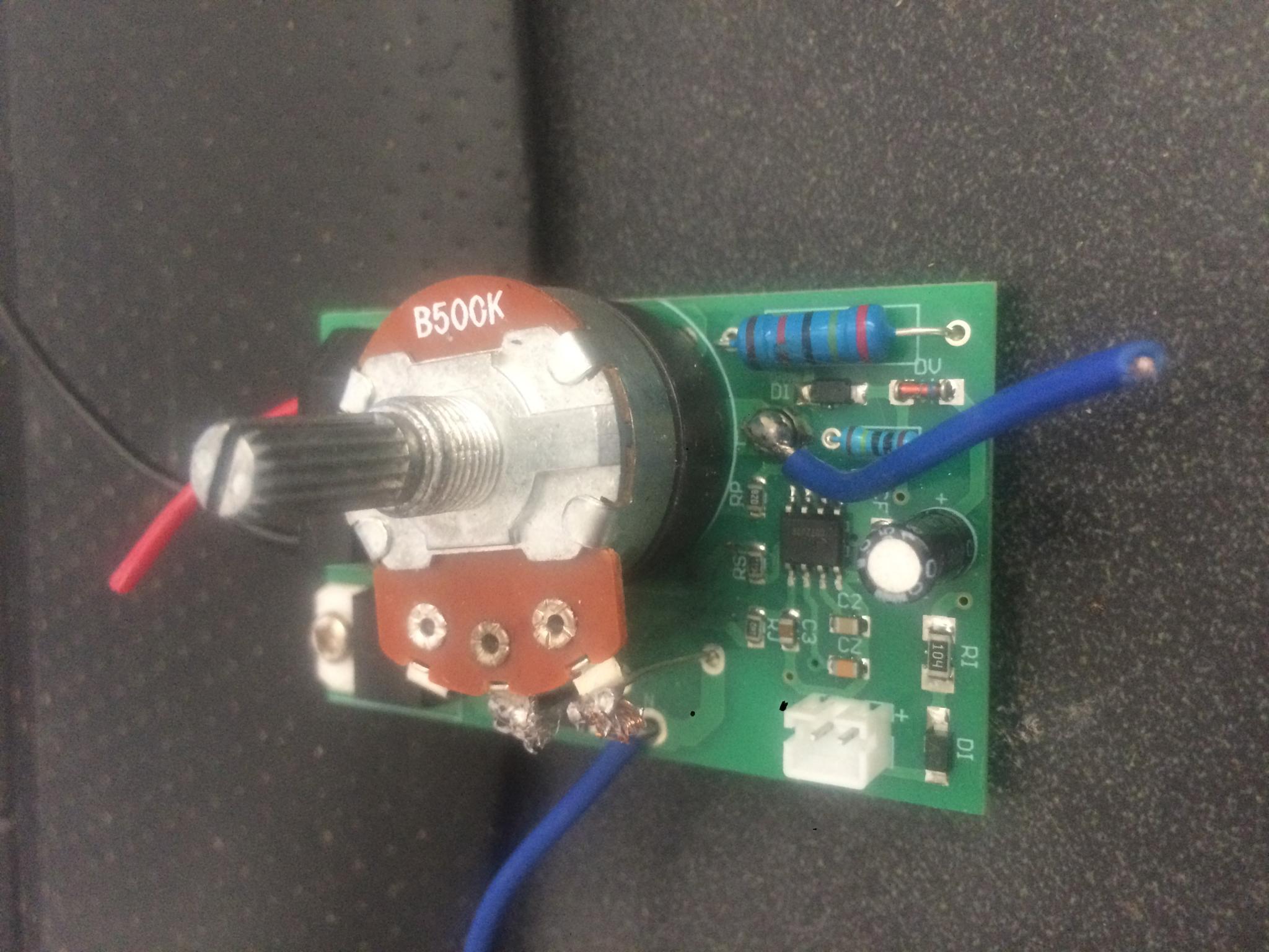

    Hi i brought a mini table saw which came with a combination off-on-speed controller. when started the motor "pulses" it seems to reach speed then just drops off then starts up again. the faster the speed controlled the faster it pulses and dies.

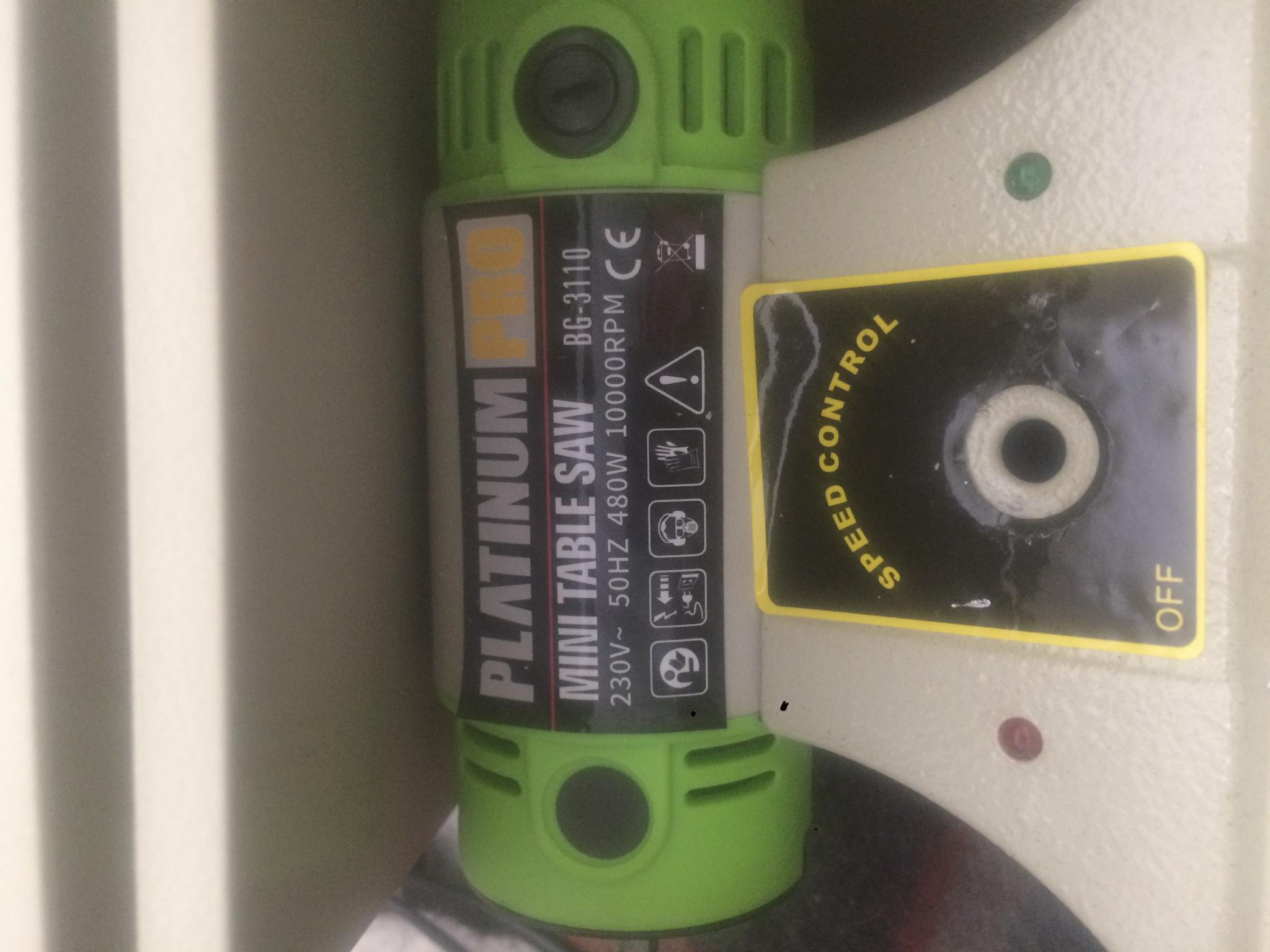

    It depends on what kind of motor is fitted.
    If it's an induction motor, then the only way to control speed is by altering the supply frequency, which you can't really do with a single phase motor.
    If it's a DC brushed motor, then that SCR drive should work.
    Surely there is something wrong with that "on-off speed controller". The way you describe it, is not normal, no motor speed controller should do that. Contact the seller and request a repair or refund. Is the saw OK if you run at full speed?
    There is also no way of knowing that the dimmer you are showing is for inductive or resistive loads, and since it seems to be a cheap eBay version, I'd suspect it is NOT as you describe it, it can definitely not handle 4kW inductive load.
    You say it is for a mini table saw, but how is the motor? What sort of brand and design is that? What are the motor specifications? I have a Proxxon mini saw with 85W motor, I don't even dream about reducing the rpm, because it would just stop. Also my large Bosch is always running at full speed, even though it has a 1.8kW motor. Why would you want to reduce the rpm? You know that by doing that, you also severely reduce the torque.

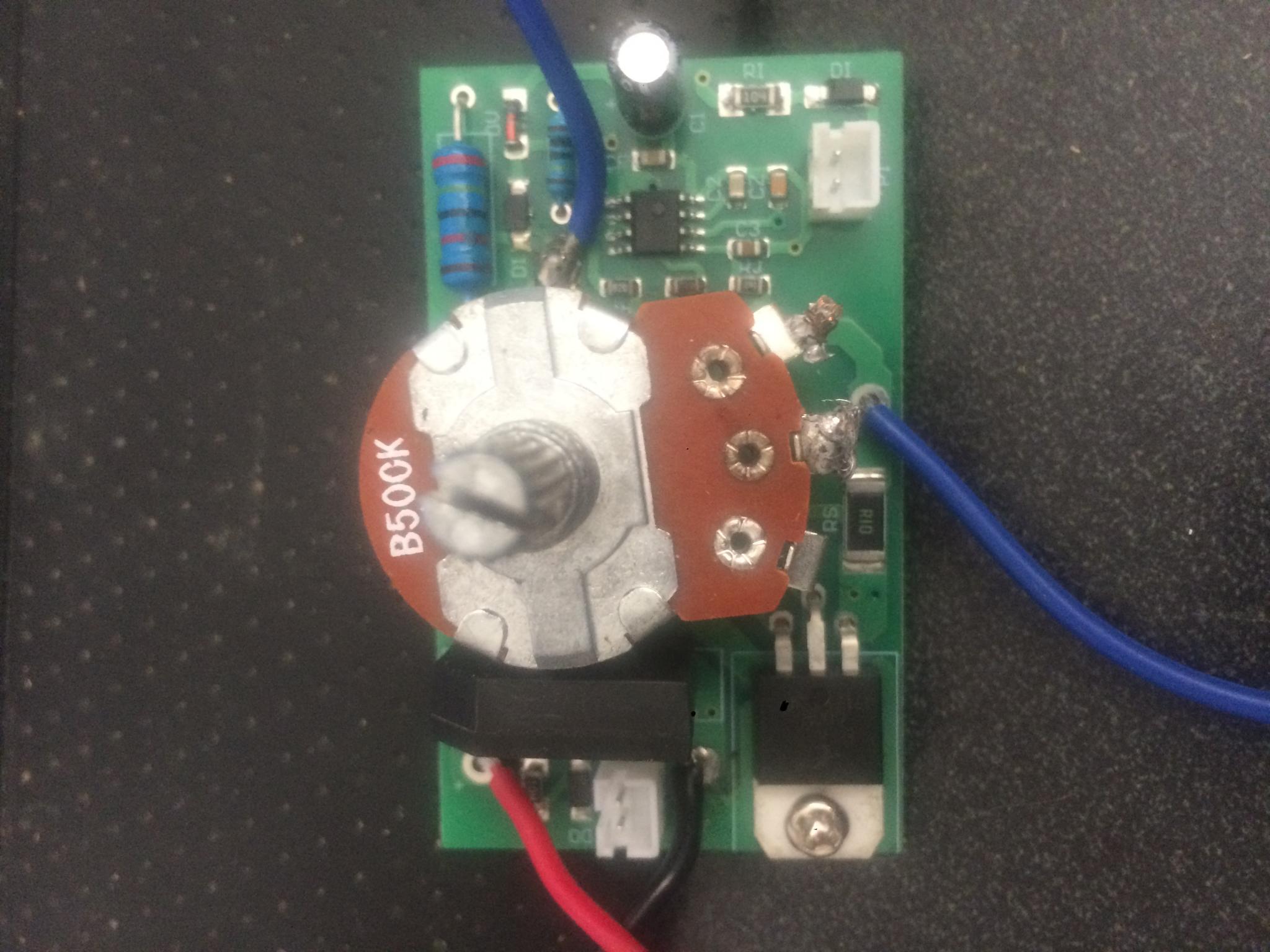

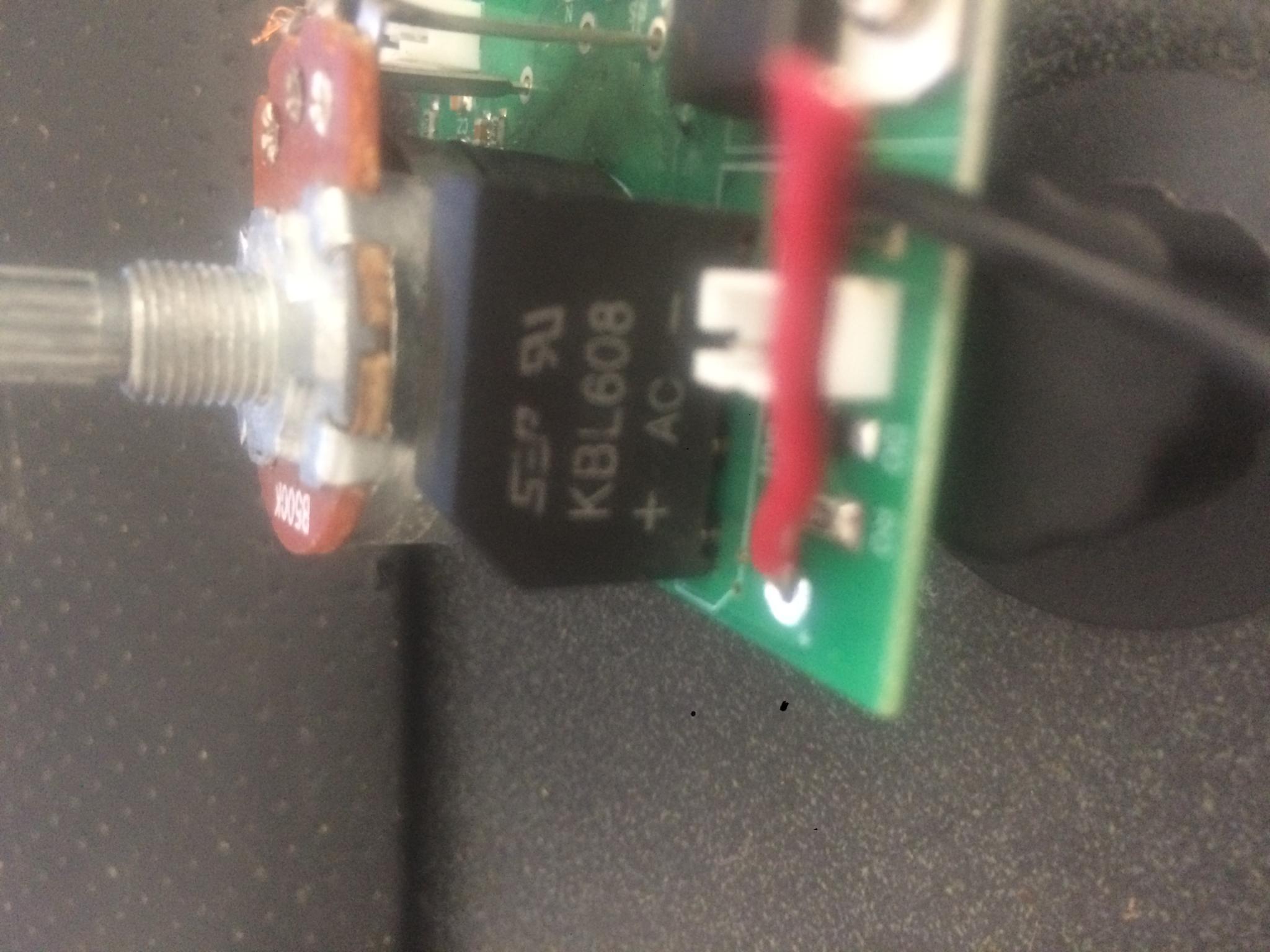

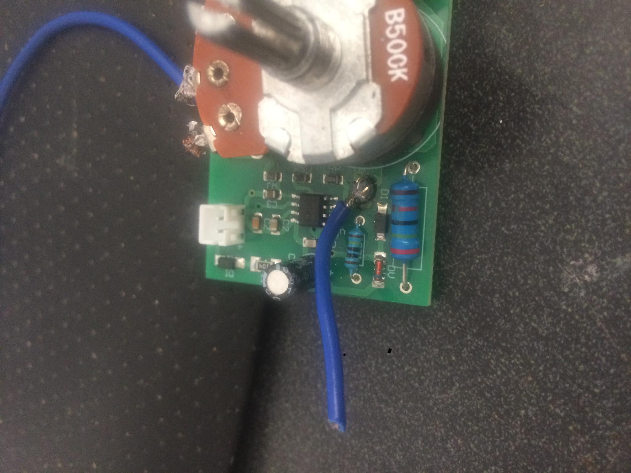

    see pics of original speed controller
    i am only cutting 5mm thick timber sheets so thats why i brought a mini saw. it will work fine if the speed pulse issue can go also specs of a local fan dimmer specs. would this work ( 500W)

    see pic

    Lives in East Lothian, United Kingdom. Last Activity: 1 Hour Ago Forum Superstar, has done so much to help others, they deserve a medal. Has a total post count of 2,992. Received thanks 375 times, giving thanks to others 9 times.
    That looks just like a pretty standard brushed motor, like you'd find on a router/drill (if you happen to have a broken router/drill, you could butcher the speed controller from them..)
    I'm trying to remember if a basic PWM type speed controller will work with that.
    Something tells me, the field windings still need full power, and you control speed through only regulating the armature power, but it's been that long since I've dealt with an AC brushed motor, I can't actually remember.

    Are you sure that the blade is running at 10K or is it geared belted down for more toque.
    Does that work out at 4800 Mtr per tooth !!
    Googled 6-1/2″ 4500 – 8000 rpm SFM
    Hi direct feed of motor armature. no gearbox motor speed listed as 10,000 rmp
    thanks

    Complete guesswork here, but the pulsing may be from an overcurrent protection kicking in, given the initial "stall" current of the motor may be many times the rated operaing current of the motor. In which case you need either a dedicated motor-speed controller (rather than a light dimmer) or serious overrate the dimmer (factor 10x +)
