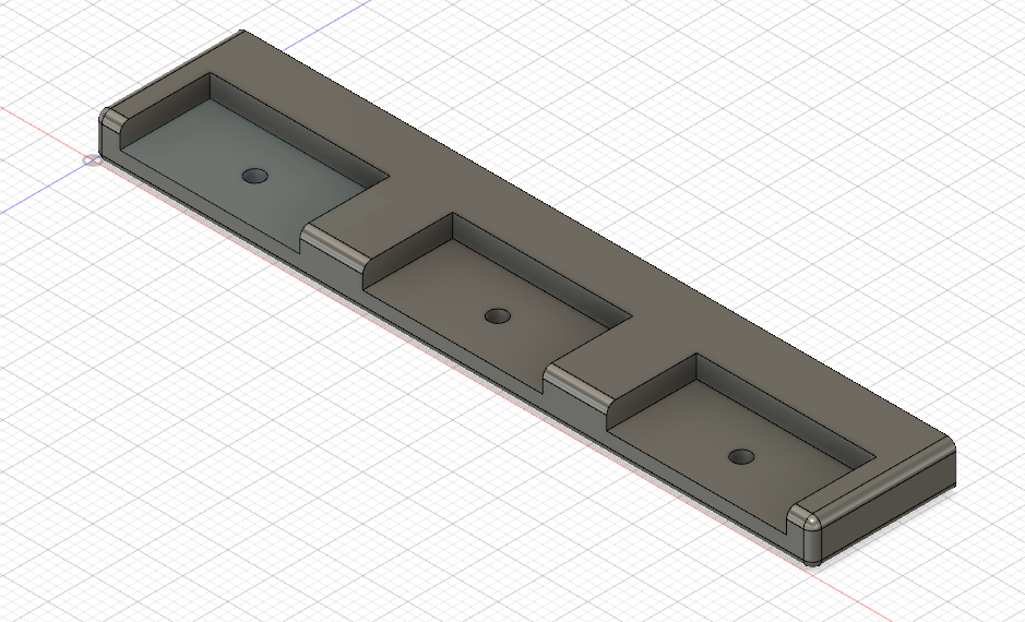

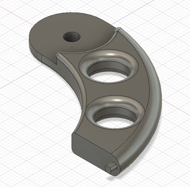

    I woke up at 4 a.m. with arthritis pain in my knee, so I decided to try out F360 some more. In an hour I knocked out the two components for my project, created stl file and checked them for errors (none!).
ID:	29991Click image for larger version.
    Now I just need to get the 3D printer sorted (it needs new nozzles).
    I still don't like F360 for being cloud based, but at least it does the job!
